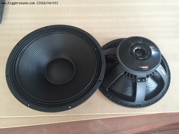

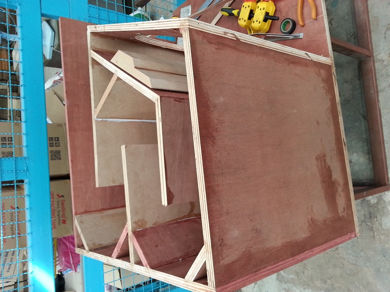

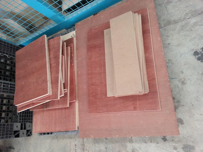

already done this plan
Thank for good project from this thread. now I finish with b&C 18tbx100
