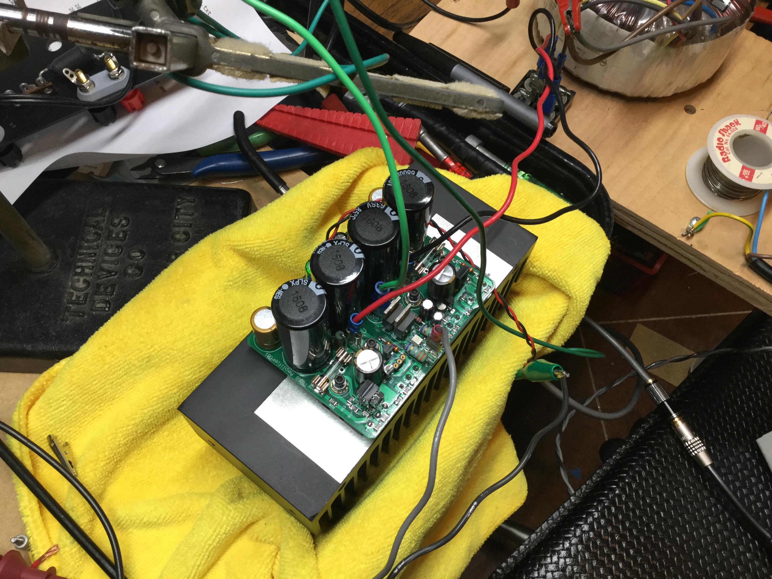

TGM8 plays music! Only on my little test speaker right now, but both channels fired up just fine, will be put I chassis this weekend👍
Looks nicely constructed. I notice the socket for the LED, presumably so you can mount the LED on the front panel - nice touch.
