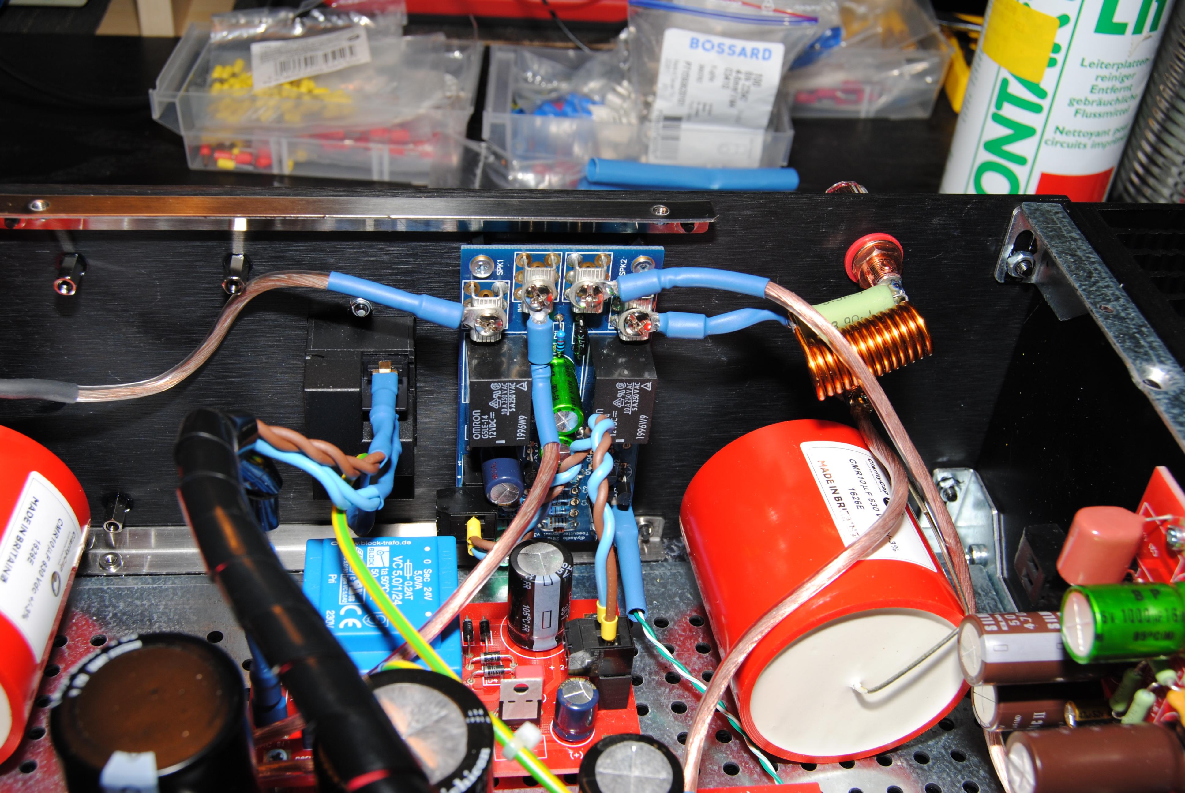

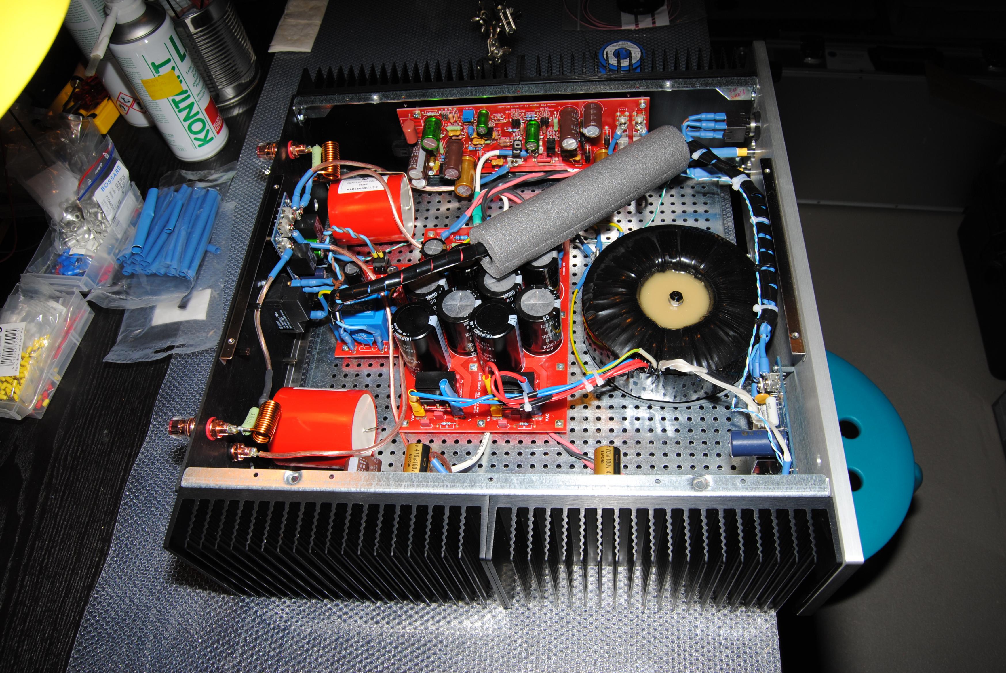

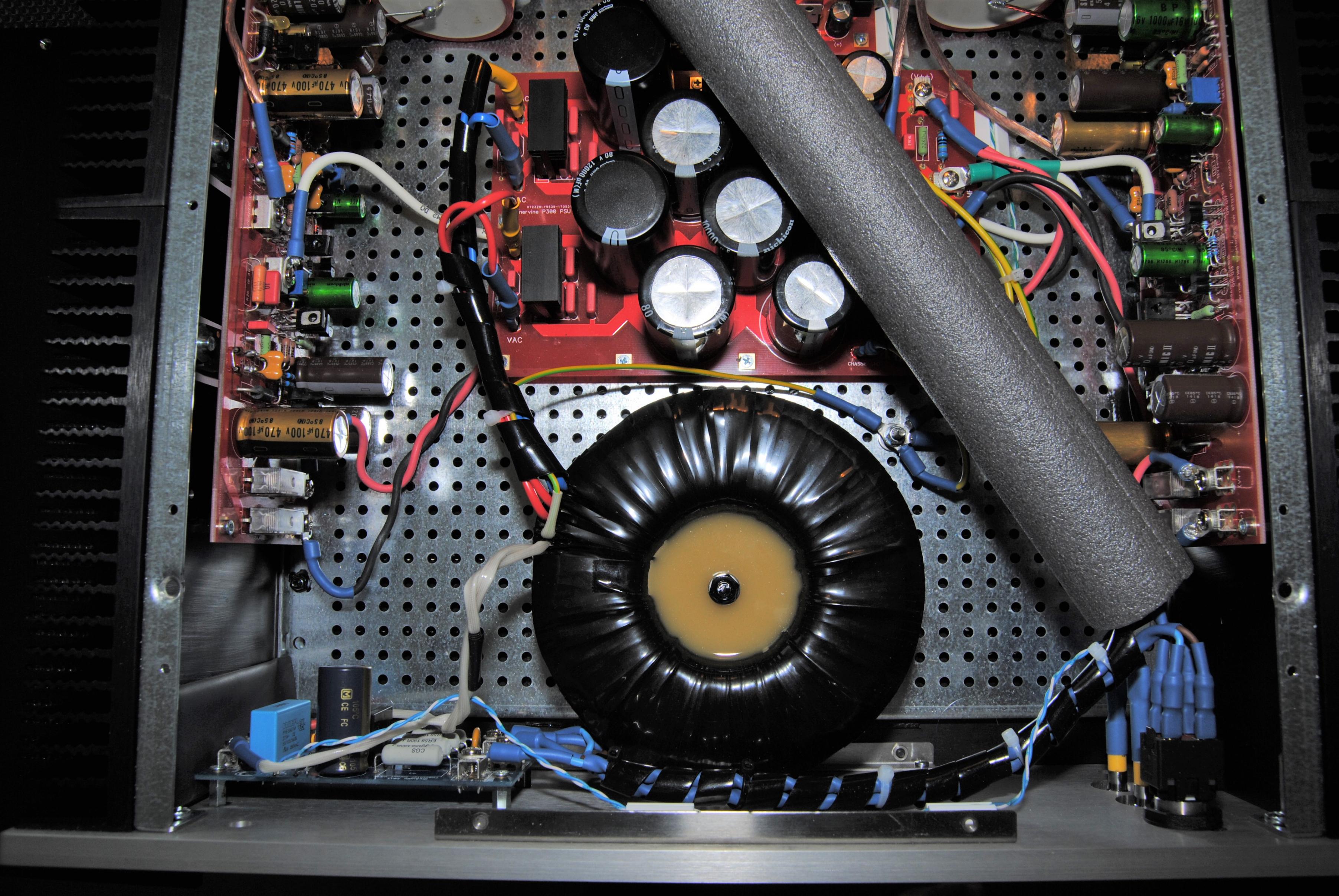

I have been listening to this build for more than two weeks and after finding the good input cap it does sound exceptional but I am worried about it's stability... It does not accept any cable in the input.... A very well shielded cable works but a non shielded one provoques a nasty screeming medium pitched noise in one or both channels. (Sometimes it screems on both channels and sometimes only one whistles)
I am using a 10u dc blocking cap directly connected between the rca input and the amp board. I DID NOT put a 1meg ohm resistor R7 directly over the rca input to gnd.... can this be the issue ?

Ignoring the schematic question for now.....Well, a screaming sound means the instability is relatively low frequency - which more or less counts out any instability related to the negative feedback loop or a high gm output device going off by itself. I doubt that there is any issue with the input base stoppers.
I have had low frequency instability before when playing with amps on the bench if I got any kind of unintentional feedback around the amplifier through poor grounding - you have to be very careful not to have currents from the output stage (or speaker) flow in the ground of the input signal (I once made an amp unstable simply by clipping on a scope probe earth wire to the wrong spot without realizing it was creating feedback via an earth loop). Another cause is proximity of wires - input wires to power supply or output wires - a shield will help only with electrostatic cross-talk but you can still get magnetic cross-talk. It seems that you have found electrostatic shielding to help with this issue but it might also be that the shielded cable is changing the grounding situation so I'm not sure if it's parasitic feedback to an unshielded cable or an earthing problem.
Can you share a bit more information about your set-up, a diagram or photo ?
I tried the amp in two very different setups...
Initially I was able to trigger the scream by flicking the turntable switch on or by switching a tabletop lamp on that is also near the power amp.
Now in a friend's system, it started screaming directly with power on... could tame it with a change of cables....
But your first quote is very helpfull.... I will increase the output devices gate stoppers and review the miller cap....
