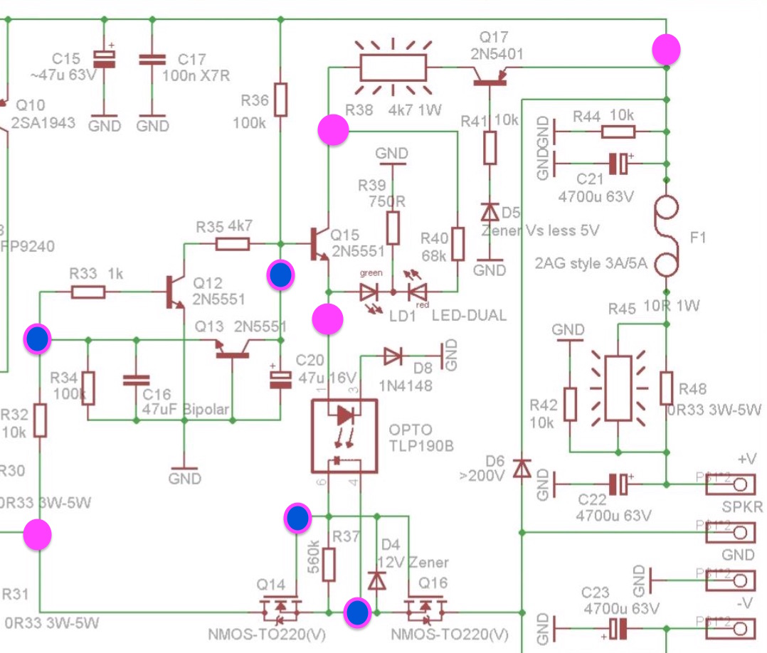

Haven't had a chance to fix the defective speaker protection on the second channel that stays on no matter what. After this is done, hopefully soon, I'll be able to listen on my ATS-4 speakers. I might need your help to troubleshoot the protection circuit. What I want to do is set a high offset where the LED turns red and then would like to know what you suggest measuring while in this mode so we can determine where the issue is.

I've attached the circuit schematic for the part we're interested in.
I've marked with pink circles some nodes you could measure voltages at, the blue and pink circles too but they are on high impedance nodes so you need a high impedance voltmeter or 'scope - most modern instruments will suffice.
First off, I would double check - compare the circuit with your pcb so you can see that everything is in it's proper place. Compare with the other channel. Maybe measure the values of the resistors - although they are in-circuit you can get a rough idea in most cases if something is vastly wrong.

In this circuit, Q17 is a switch. It turns on once there is a higher enough voltage on it's emitter - the current flow out through the base go ground goes through a zener diode. If the power rails are too low then the voltage across this zener will be too low to turn it on and Q17 remains off. In practice, it serves to cut-off power to the circuit when the power rails collapse. This means that when you hit the main off switch on the amp, the power rail voltages collapse and when they get below a set point Q17 turns off and cuts off the speaker so you don't hear any strange noises that some amps make when they power down. For the purpose of disconnecting the speaker in the case of dc voltage error on the speaker output - Q17 has no role to play.

The heart of the circuit is Q15. It switches the current on/off to the Opto isolator. The opto isolator provides the gate drive to the FETs and allows their Source connections to float up and down with the signal. If Q15 is on then the Opto should be providing a gate drive signal to the FETs which will appear as a voltage across R37. If this signal is present the speaker should be connected.
Q15 is has a base pull-up resistor R36 which biasses it in the normally 'on' mode. The voltage at the base of Q15 is established on power-up but not instantly. The current flowing through R36 first charges up C20. This provides a short delay before Q15 turns on and hence the speakers are not connected for a short time - just enough for the amplifier operating points to settle down and thus avoid any turn on noises through the speakers.

The fault detecting components are Q12 and Q13 and their associated passives.
R32 samples the amplifier output and together with C16 forms a low-pass filter so that the circuit is sampling the average dc-level and not the music signal. When the dc-offset is close to zero there will be zero signal at the junction of R32/C16. This means no voltage at the base-emitter junction of Q12 so it stays off; it also means no voltage at the emitter-base junction of Q13 so it stays off too.
