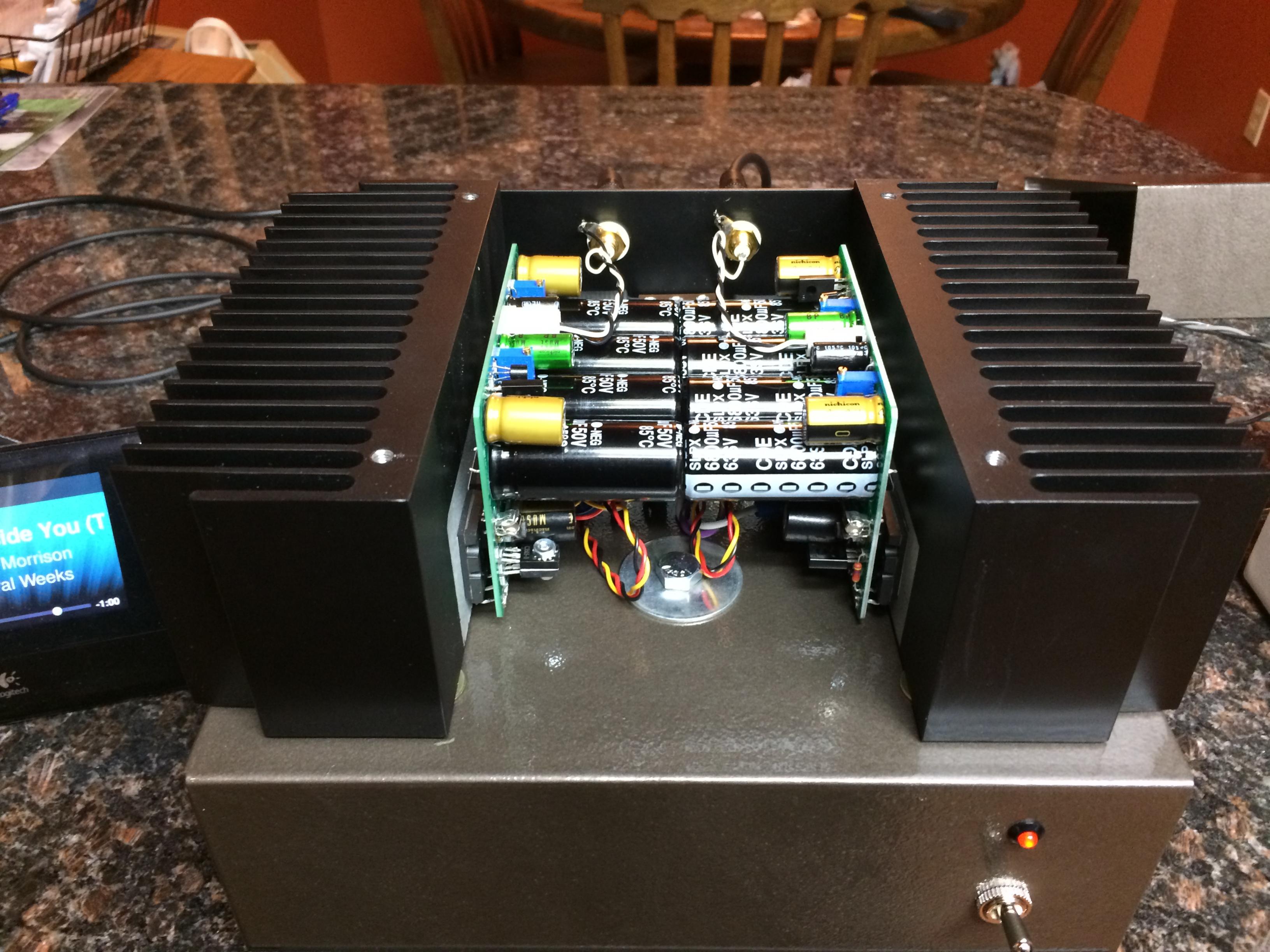

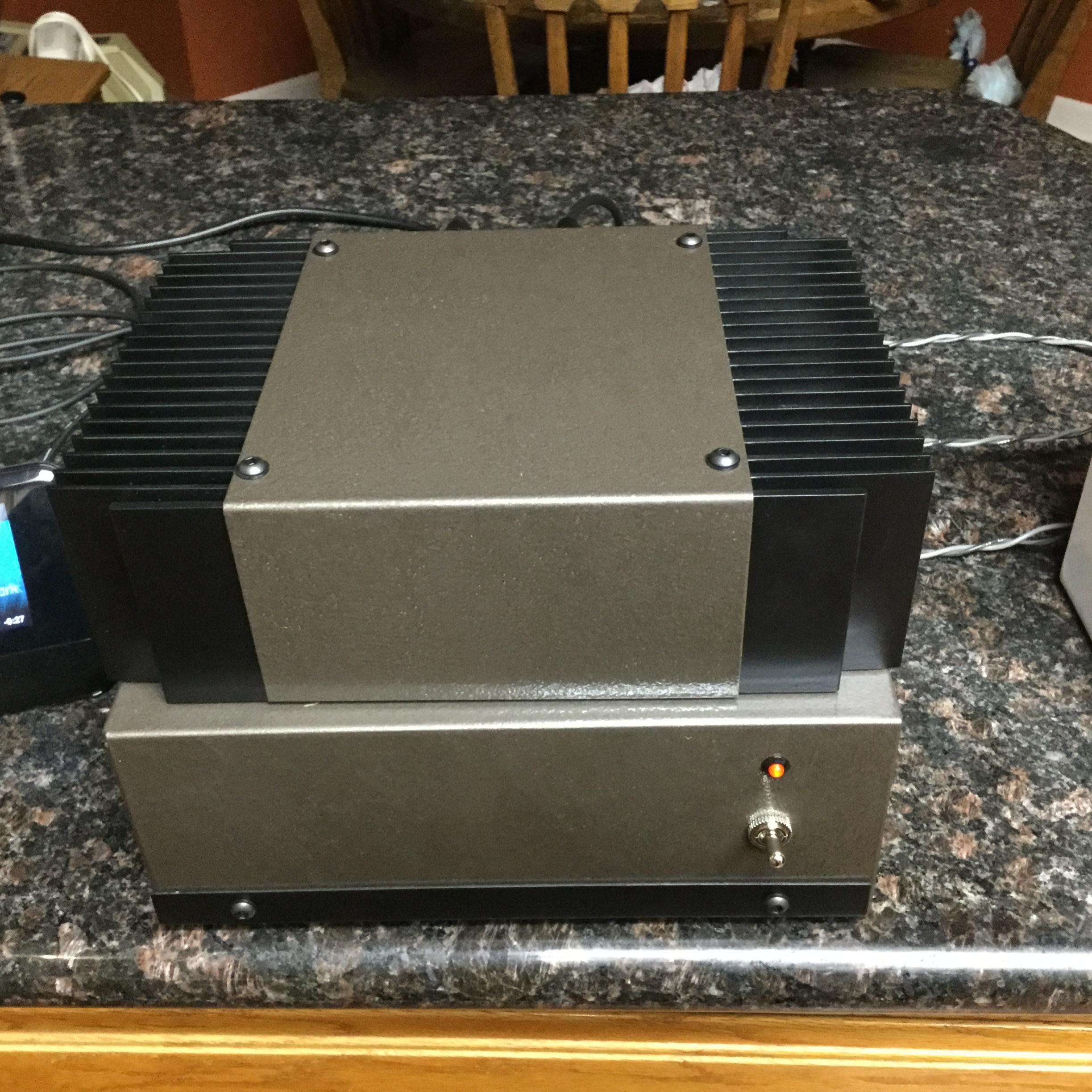

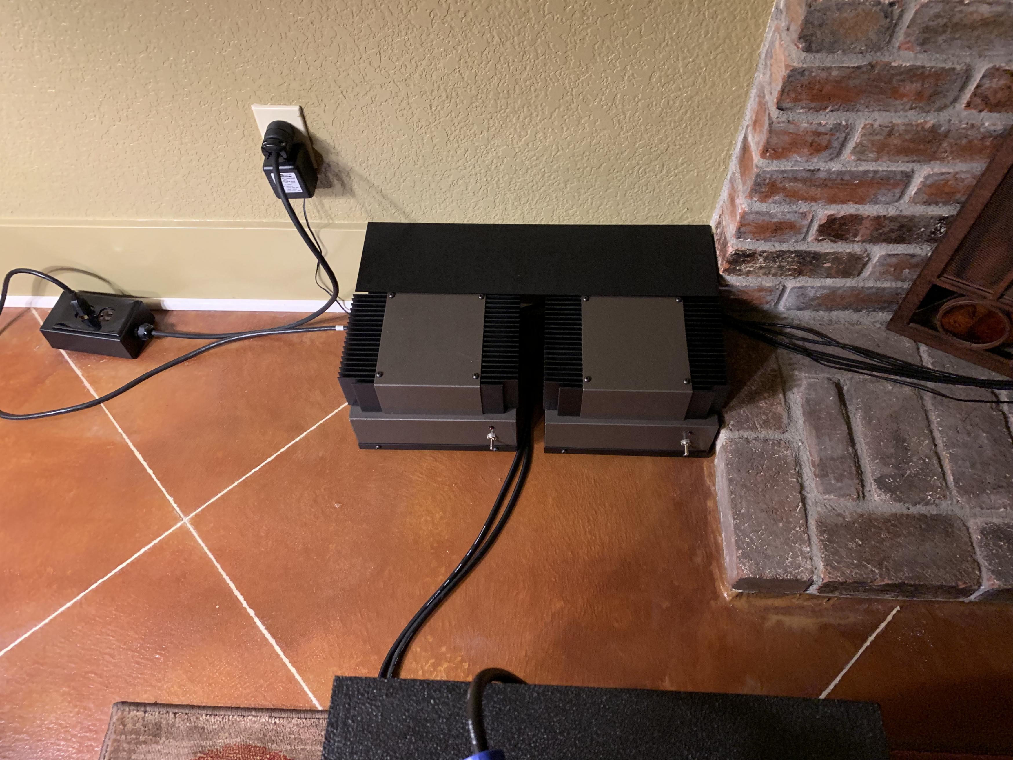

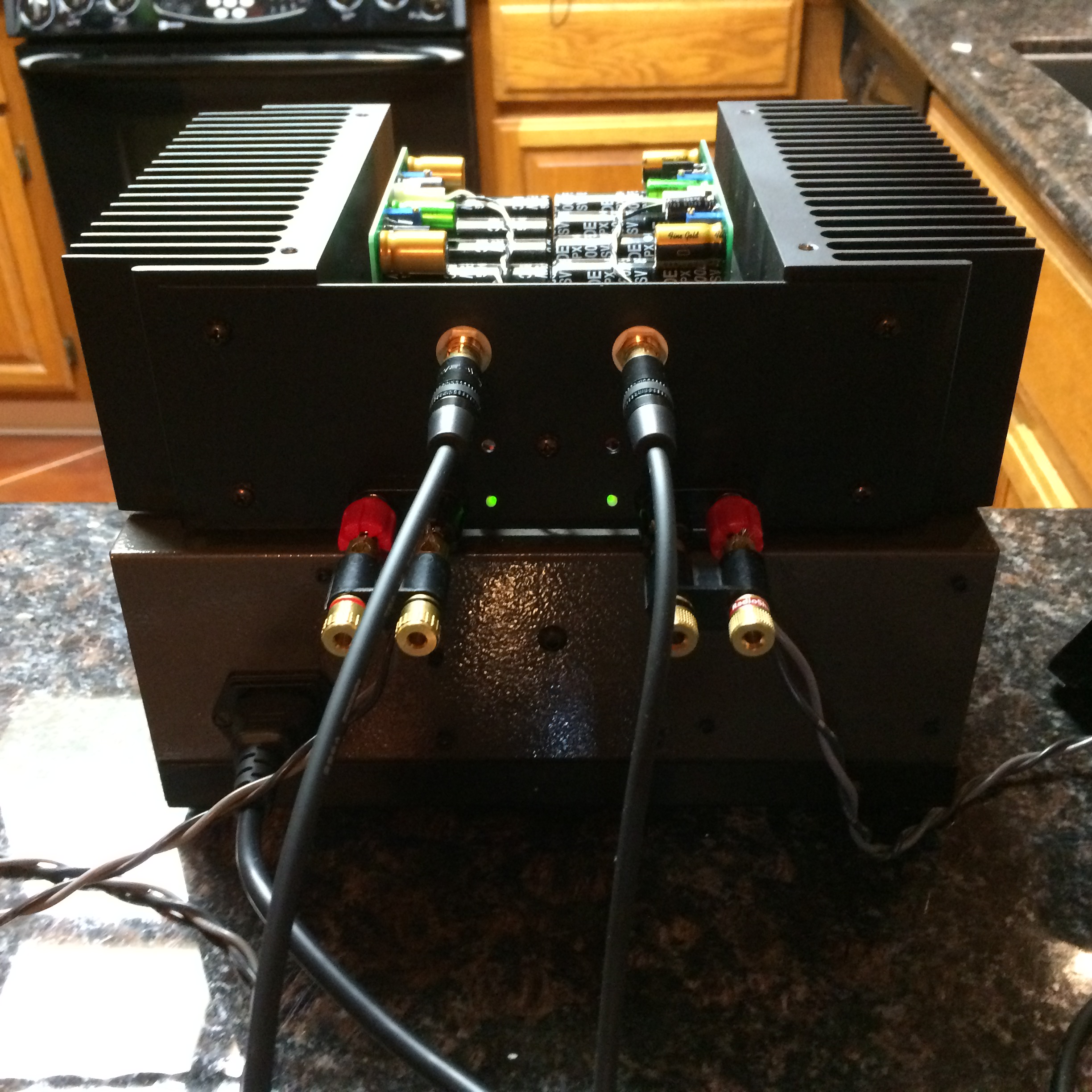

I really like these amps! They have been powering my LX521's for about month now and I find their presentation to be detailed and powerful, but in a relaxed way, if that makes sense. Here are some pictures.

looks good, I like your build - neat and some good hefty heatsinks

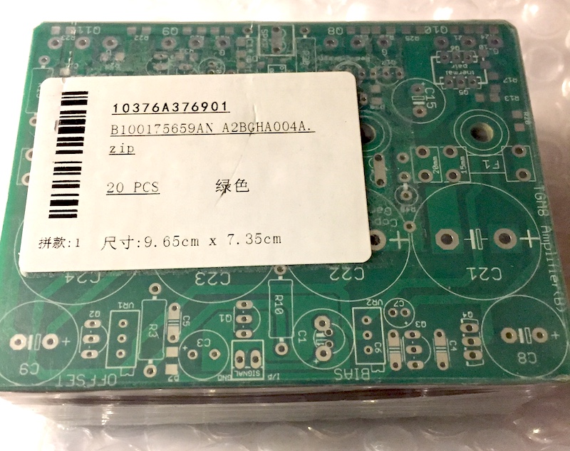

I've just re-ordered some more boards:
1/ 'maust' - paid for 1 pair
2/ 'maust' - paid for 2nd pair
3/ still available
4/ still available
5/ still available
6/ still available
7/ still available
8/ still available
9/ still available
10/ still available

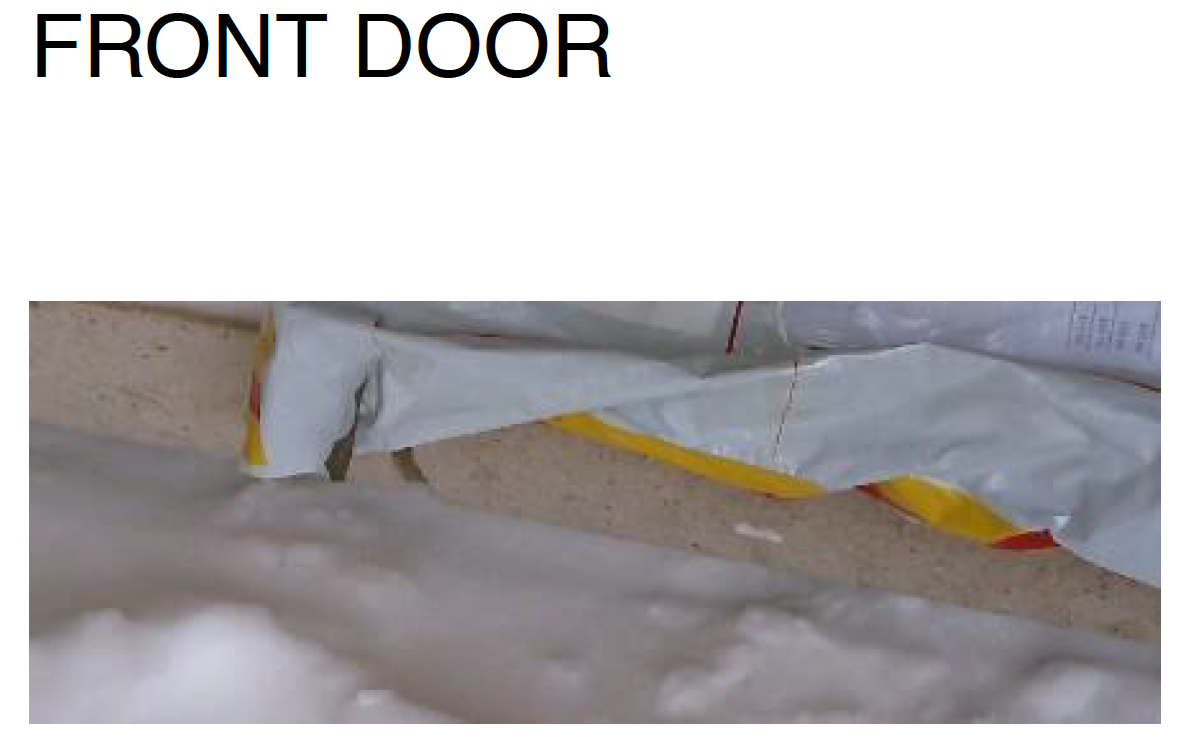

Well, the DHL guys said they delivered the boards today, but there's no sign of them. I already did the on-line release since I'm not at home during the day. If the boards are gone, then I'll refund anybody waiting for them. I've sent a note to DHL.
Joined 2009
Well, they provide a photo of the package lying at the front door. This photo is not easy to recognize but it shows a ledge or front step with snow up to the edge which doesn't look to me like any part of my house. This suggests that somebody got some PCB's and must be scratching their heads!

Well, DHL called me and initiated a trace (they have GPS data etc.). They promised to get back to me tomorrow.
In the meantime, a lady who lives somewhere up the street from me returned from a trip this evening to find a DHL package on her doorstep which she kindly brought around to my house.
We're back in business 😀

If I got it right, I should be sending out some boards as follows:
3/ 'Selwe' - paid for 1 pair
4/ 'Selwe' - paid for 2nd pair
5/ still available
6/ still available
7/ still available
8/ still available
9/ still available
10/ still available
did I forget anyone ?
