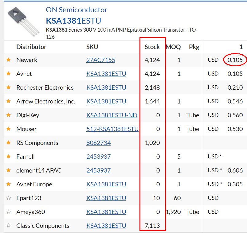

I used octopart.com to obtain the data below. Other diyAudio members prefer findchips.com ; to each her own.
Some might not know that Newark is the US member of the "Element14" electronic distribution alliance. I am guessing that if Newark has stock, so does every Element14 distributor around the world. Check whether your local Element14 distributor has parts on the shelf, ready to ship. They may be able to pull some devices from Newark if necessary.
