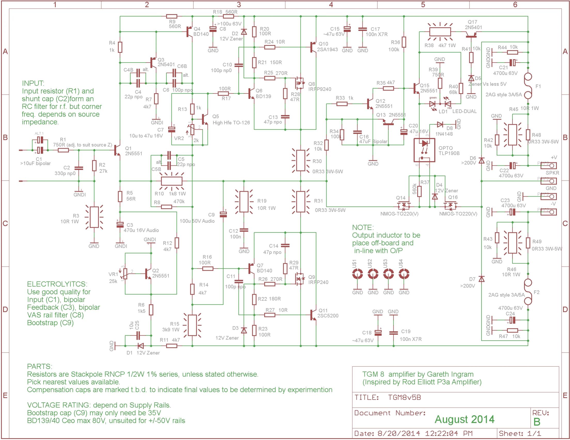

The measured rail voltages of my old amp are +-55V at idle.
Any special considerations? It is not much higher than "as designed" +-50V, but better safe than sorry.
I've specced smoothing caps and C8, C9 as 63V...
I think it should be OK if the caps are properly sized. It'll run warmer. As I haven't tested it as such at these voltages you'll be treading new territory.

I would still like confirmation that last BOM is suitable for +-55V PSU.
Joined 2009
All the semiconductors are rated for minimum 160V and your maximum rail to rail voltage is 110V so that's fine. Most of the semiconductors are rated for higher voltage. The solid state relay FETs should never see rail to rail but you can choose the IXFP110N15T2-ND which is rated for 150V.
Unless there's a fault, the only capacitors we need to worry about are the electrolytic rail capacitors which must all be 63V minimum, the 50V options won't suffice. The BOM for C8 & C9 are OK at 63V. However, the BOM for C15 & C18 are only rated 50V and a little oversized. Instead, you need 63V rated caps and I will recommend 493-15498-ND which are a better size too so everyone else might like these. I've uploaded a revised BOM for you.
Edit: I will check the simulation for VAS power dissipation.
I probably don't need to remind you - it's a tightly laid out PCB and not an easy one to assemble. There are some tips earlier in the thread worth following but I'll repeat a few here:
Install the small bits first. Clean off the flux before you add larger components - it gets harder to clean as the board gets busy.
The higher power resistors (through hole) should be mounted so they are slightly off the surface of the board to allow for better cooling
The 'spacer' TO126 parts are essentially non-functional washers, you might find something else you can use but they can be fiddly to install, I could probably come up with a better option but heck, it's DIY. Only solder these in place with mounting bolts in place to hold them to the underside of the PCB so that they are both flat and aligned.
Only solder the power devices once the pcb and power devices are bolted to the heatsink. This is to ensure they are all properly aligned and flat and parallel to the heatsink etc. If you don't and instead try to align them by hand they will not lie properly against the heatsink and it's almost impossible to move them once soldered so you end up cutting them off and removing their legs from the board one at a time and then installing new ones properly - don't ask me how I know this !
In general, removing parts is difficult so check your work carefully as you progress. Watch for little items, like getting the fuse holder clips the right way around etc.
The big power caps might not 'snap-in' but rather appear as a loose fit - at least on my boards they were.
Joined 2009
These TO-126 devices are generally rated at 600mW in room temperature ambient (without a heatsink) and we'd like to be at around half that power level. In my simulation the VAS device, Q4, will experience the higher rail voltage and also higher current which is set by R14 and R15.
The VAS and the driver devices will all be running at around 300mW. This should be fine. But they will get pretty darn warm. You can reduce the VAS current slightly by increasing the value of R15 to say, 4k7. That's up to you, it's a simple adjustment that I don't feel with have any negative consequences.

C3 orientation if not bipolar
Hi Gareth,
Just wanted to point out that C3 polarity may be wrong on the schematic and PCBs. You specify a bipolar on this schematic which avoids the issue, but just in case someone decides to use a polarized one...
PS: Have you made up those speaker cables yet?
Hi Gareth,
Question: Can I use 40V FETs in the protection circuit if using +/-39V rails?
I can't see any reason why not since the FETs only have to block the rail voltage, worst case. I cannot see any reason why the protection circuit would need to block 2X the rail voltage.
Or is my reasoning flawed?
Joined 2009
Hi Gareth,
You are correct, I did build the amp with C3 the wrong way around. See post 645 (also referenced in the first post). The voltage being so low it caused no harm and no audible issues either. I did, later, reverse the polarity on my build to make it correct.
Joined 2009
The reasoning is fine if we had no load, or a simple resistive load. Although you always want some safety factor, i.e. if the max voltage on the board was 39V you'd want to allow more than 1V safety margin to the max rating of your components. Two reasons why this isn't safe:
a) your rail voltage will rise above nominal under no-load or low-load conditions due to the regulation of your power transformer and there will be variations in the mains voltage at the wall socket.
b) the speaker is a reactive load, it has capacitance and inductance and can generate back e.m.f. If you suddenly cut the current supply to the speaker (solid state relay 'opens') you can generate voltages well in excess of the rail voltage. Therefore, you want to have your FETs rated at much higher voltages. It's relatively easy to find 150V rated FETs. The FETs can be damaged by the back emf so I have 'catch diodes' across the output-rails which helps to shunt reverse bias back-emf spikes to the power supply.
Most important is to have maximum SOAR for the FETs so that they can endure the stress of carrying current and voltage during a turn-off event for the brief time that it takes the circuit to recognize a fault condition and act on it. In this regards, the circuit could be made more robust with a speed-up capacitor but I haven't explore this.

I was just thinking about how close to the rails the output can swing (with a resistive load).
It's actually very hard to figure out because the base current of Q10 gets added to the collector current of Q6 and provides gate drive for Q8 due to the voltage drop across R21 (+ the Vbe of Q10). Lots depends on the FET threshold voltage and its transconductance.
It looks like the output could get to within ~3 to ~6V of the rail voltage. Is that a reasonable estimate?
