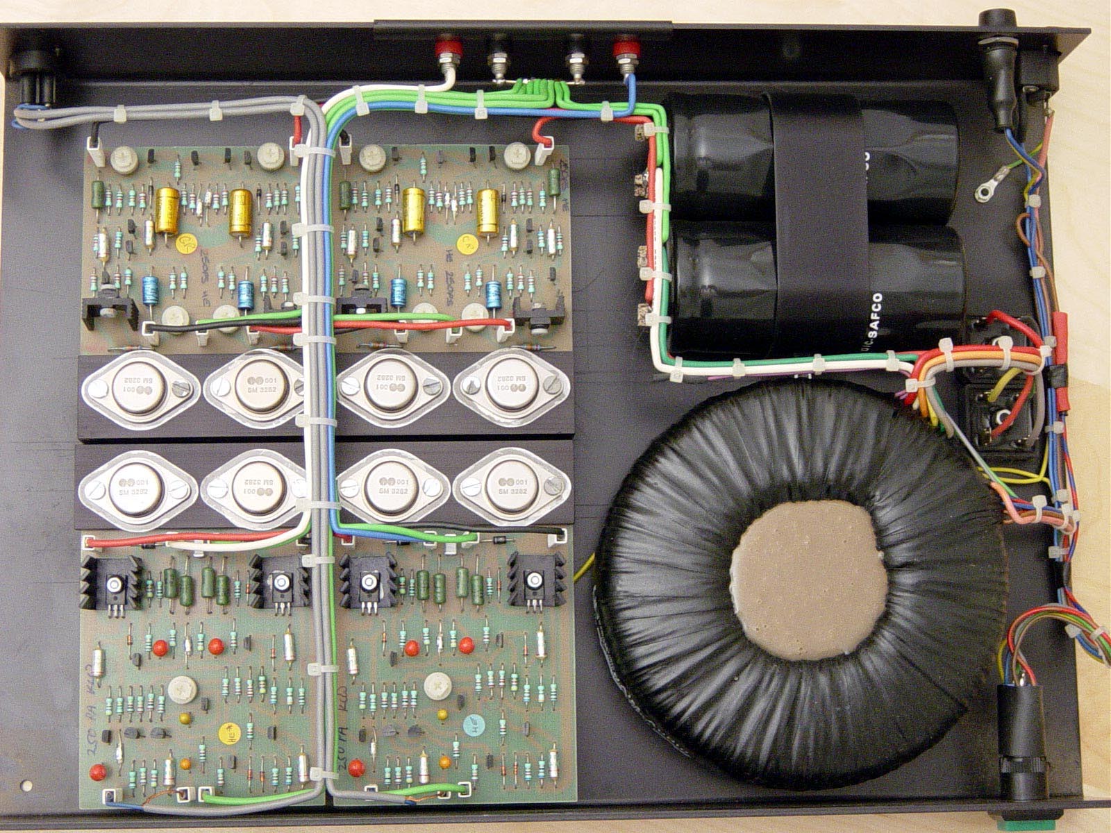

TGM10 - based on NAIM by Julian Vereker
They state 60W per ch ....heatsink is the bottom of the case
Somebody tell me what am i missing ....is the bottom of the case capable to accommodate 120 W of dissipation ?
It's business, the cost of using the case as a heatsink is lower as now you not only avoid a dedicated heatsink but the rest of the chassis is easier too.
You know the answer to your own question of course.
Most people will not run their fancy hi-fi like it was a party rig. It'll be used at home on a fine wooden rack with nice speakers listening at relatively low power levels. Of course Naim will market that the amplifier can generate peak output levels equivalent to 60 W (or whatever) but it ain't going to be happy putting that out continuously.
I expect a fair bit of gear would fail the continuous use at high power scenario (and not just hi-fi) but designing for that means a lot more expense (size, weight etc.).
What is the output power of this amp? If it is about 120 W per channel and we roughly, but almost reasonably, assume the efficiency of a class B amp at about 2/3, we have a dissipation of 120 W at least.
It's probably all about design here...

According to Naim's web page, the NAP250 is rated at 80W pc 8 ohms. I understand from a thread in this forum that the psu rails are +/-40V. The max theoretical average sinewave power into 8 ohms is 100W. So Naim are underestimating if anything and using average power rather than peak. So by your reckoning, they have never sold any NAP250s? 😉

Hence "theoretical". But I think it might just push 38V and 90W given the regulators. In any case, Naim claim realistic average sinewave power rather than some companies who might bandy peak power about. Or "music power" whatever that is...I mean, what else is it likely to be: hairdryer power? 😛
The NAP250s are regulated supply designs and the power rating conferred by the "250" is a nominal figure for the sum of both channels driving 4 ohm loads. i.e. 2 x 125W = 250W. This is the basis for all the NAP series model numbers.

Hi Sakis,
Like other early NAP boards, the Vbe multiplier is on the PCB, next to the bias setting pot. (just on the R side) Reading a little about Naim amplifiers and clones, we find that it takes a long time for them to warm up and bias to come to equilibrium because of that remote location.
Since it's a quasi-complementary design, the bias controller really has 2 temperature coefficients - one for the CFP driver, the other for the EF output transistor so it's difficult to design a controller and make bias current track properly by simply attaching it to either heatsink when neither is the correct point of temperature reference.
Luckily, it doesn't make a lot of difference even if bias doesn't track exactly but it would be more reassuring if it took less time to correct an unsafe trend. On later, single board models, the Vbe multipliers are flipped onto the copper side, where they are much closer to the bottom plate. On my NAP200 clone, the settling time is much reduced.
I don't think there's an issue with the quasi-output have two different temperature behaviours, you can choose one of them, i.e. whether to derive the bias servo from the CFP driver or the Darlington power device - so long as you control one of them the other will track because the nfb loop enforces zero dc-offset.

Ian, this looks like it could be a DIY amplifier. To be honest, the heat sink would be big enough for dynamic music, maybe not steady state sinusoidal testing but who listens to single tones for any length of time.
It is pretty neat inside and smart idea of having the earthing bar between the two loudspeaker grounds.
It is an extremely practical design for a hand built production line, you can see the scribe markings for the drill holes mounting the amps. Someone sat thinking about the internal layout before just blundering on, the wiring harness is most likely made on a plinth with a few nails in it, that is why the corners are very square and neatly tied down.
The chassis is a U-shape and the case slips over it. It can be made using very simple tools, a guillotine and a small bending press and a drill-press, nothing more. The boards seem to be inhouse made using simple techniques and hand soldered. This is a company that probably started in someones garage and possibly even remained there with no more that maybe 10 people.
I am suitably impressed, it is well made, practical and very simple.
