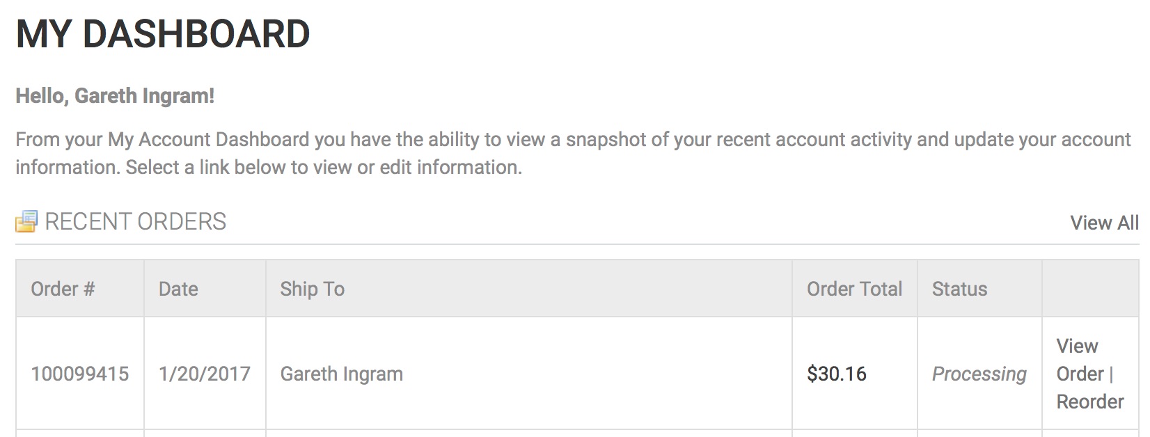

TGM10 - based on NAIM by Julian Vereker
The pcb's are still in 'process'
