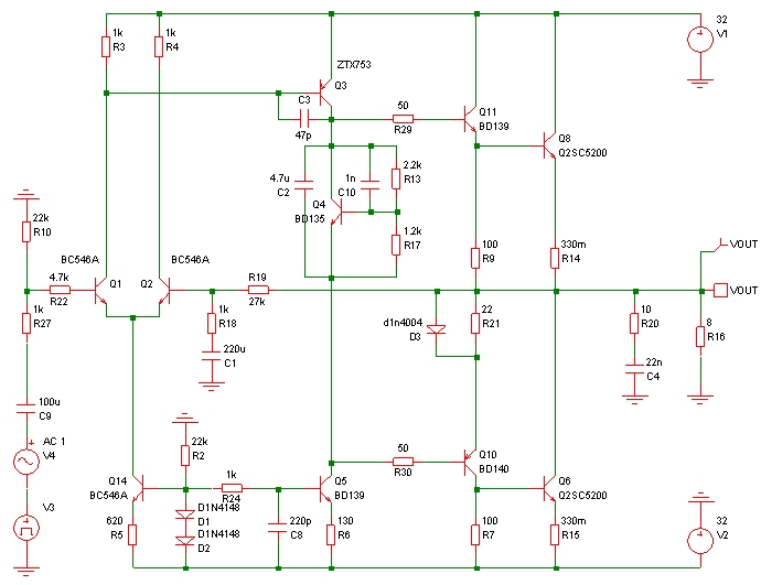

TGM10 - based on NAIM by Julian Vereker

Other than this i once simulated this Naim amp and frankly it s not a good design fom the very start, as pointed by Bigun it is extremely prone to oscillations.
Among the bad things is the 22K resistance that load the differential, it is the cause of a huge miller effect that limit the bandwith of the return path, creating a huge spike in the frequency response.
Second is the baxandall diode of the quasi complementary stage, a 1N4148 is inadequate and could well end as a short that would increase hugely the OS current.
IMO quasi complementary OSs should be definitly abandonned as these are much less stable than the usual EFs, and their THD distribution which often produce mainly even harmonics is of no help since the distorsion is higher anyway.
Thanks for highlighting this, I hadn't thought that issue through properly. In fact, in my TGM1i, an AKSA clone, I included the provision for such a resistor as I remembered reading that 'SandyK' had himself included one in the early days of AKSA tweaking. The idea was to equalize the dc voltage at both of the LTP collectors to match Early effect. I had failed to think what happens at ac.
This surprises me, I thought these diodes were pretty robust but then again, I have not considered all the possible fault conditions that could stress it.
Generally I never had any problems with the basic 1N4148 diodes.
In the classic Naim circuit there are three per channel. The two diodes in the first CCS can easily be substituted with a transistor like Naim does it nowadays. The Baxandall diode is critical and can be substituted with a more linear device like a transistor (wired as a diode, like a npn transistor where base and collector is connected).
In the Elektor Hybrid Amp from 10/2007 the Baxnandall diode is substituted with a 2SC1815 BL - the measured distortion was lowered to more than half. But only the BL type (hfe >350) works well, with GR, Y, or O types there is little difference to the diode.
I unfortunately have never tried that but I think it is a very good idea. In this project with a quasi-complimentary output stage one should make no compromises. If I will make another Naim style amp again I will defintely use that approach.
(I had a nice paper from JLH about the effect of this diode but it is lost in the labyrinths of my archive.)
This is the mentioned Mugen Hybrid amp
A slight revision of the schematic on post 1, there s much less components, particularly all the useless ones that were here just to compensate for the flawed starting point.

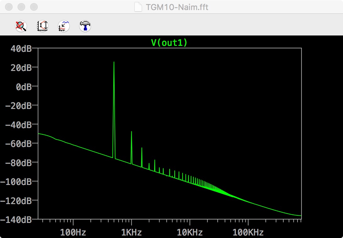

An EF OS would have lower THD, what the quasi complementay does is to increase distorsion with even harmonics being increased more than odd ones...
I can believe that. I have Bob Pease book "Troubleshooting Analog Circuits" and he shows that the diode-wired transistor makes for a better diode.
As for the distortion, well this is one of the key things about the amp that makes it what it is. I'm OK with the distortion. It looks just fine in Spice - Wahab is right in that it has predominant even harmonics. We're looking to make a circuit like the old Naim amp. If we want to make an amplifier with lower distortion that would be a different project (look up my TGM7, TGM8 amps).
