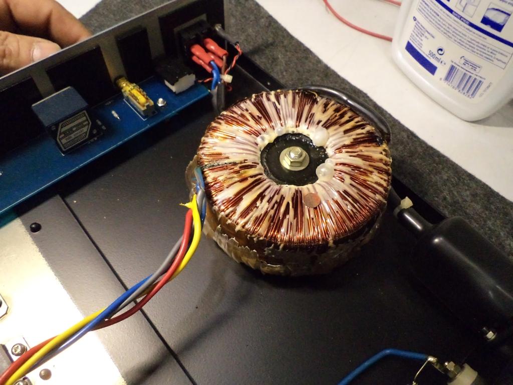

Magnum though that it could run a pair of 2955-3055 with almost 55+55 volt rails cooled at the bottom of the case and running of a transformer barely 100-120 VA Many others like Musical Fidelity made mistakes , wrong calculations , or poor choices on the transforemer selection considering available power
Resulting trafo is toasted far before the amplifier and obviously if the "stated" power is required trafo will run out of steam increasing distortion in audible levels ....

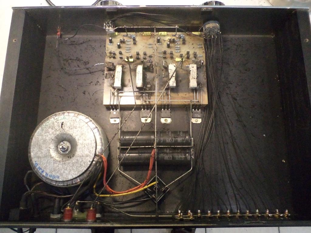

East electronics managed 1830 audio machines last year ( only ) so any of the things said here we have seen first hand .... So NO NO NO you can argue as much as you like about the sound in a specific music content but there is no innovation or technology on any of their machines .....

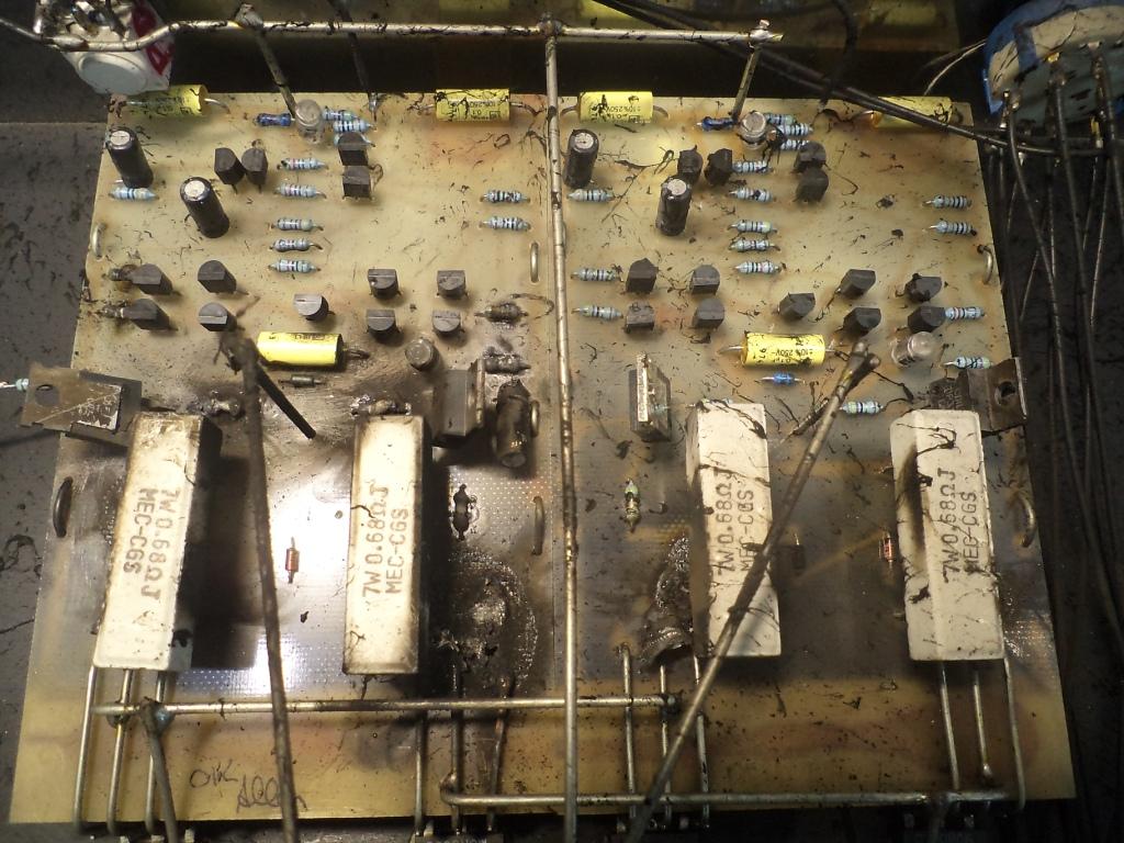

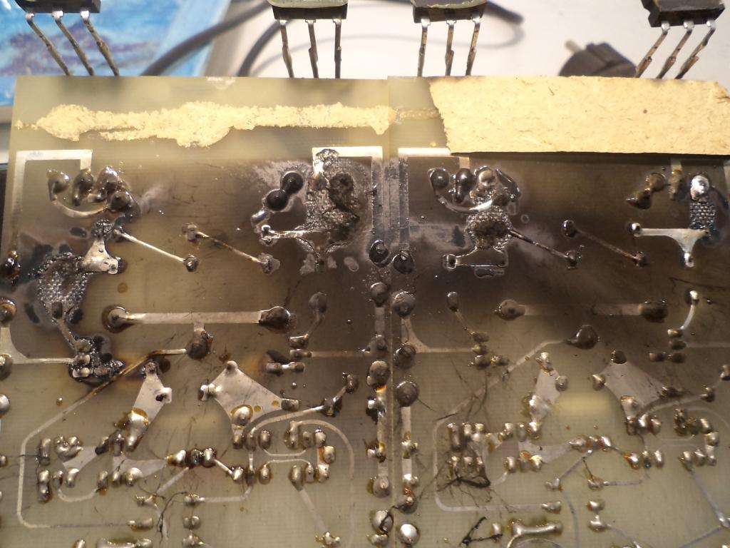

I could write down in details for each model but i will just place a few photos to prove my sayings ...
Smoky regards
Sakis

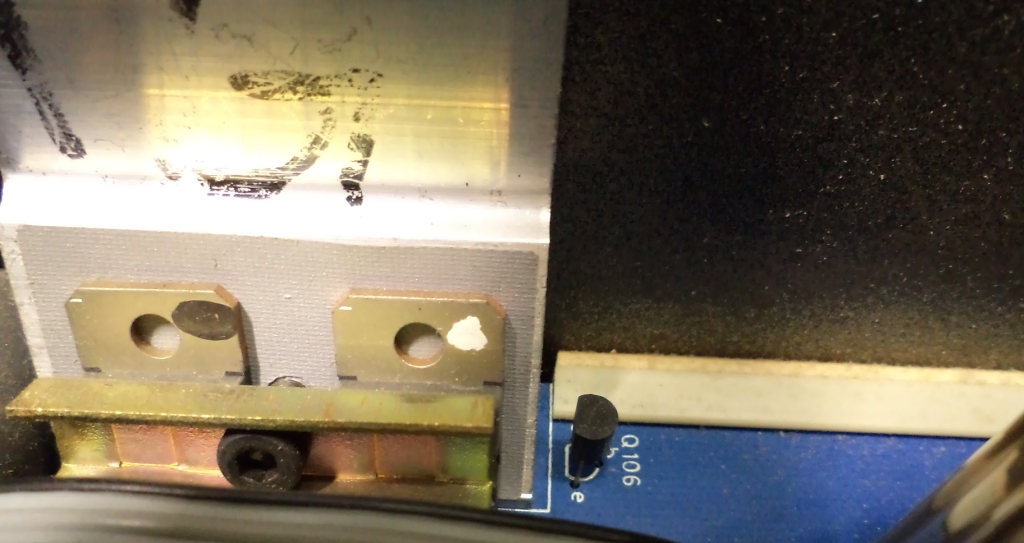

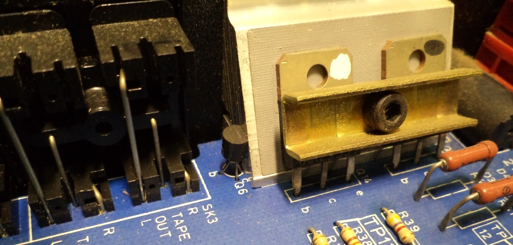

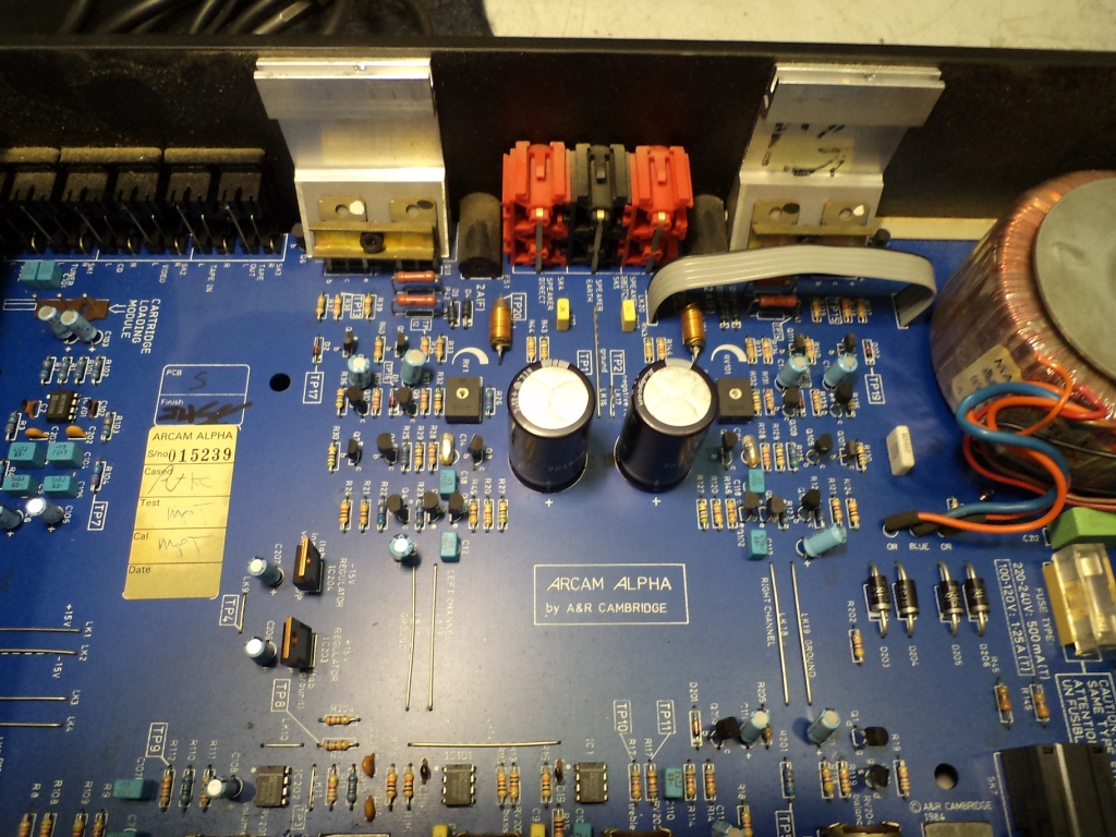

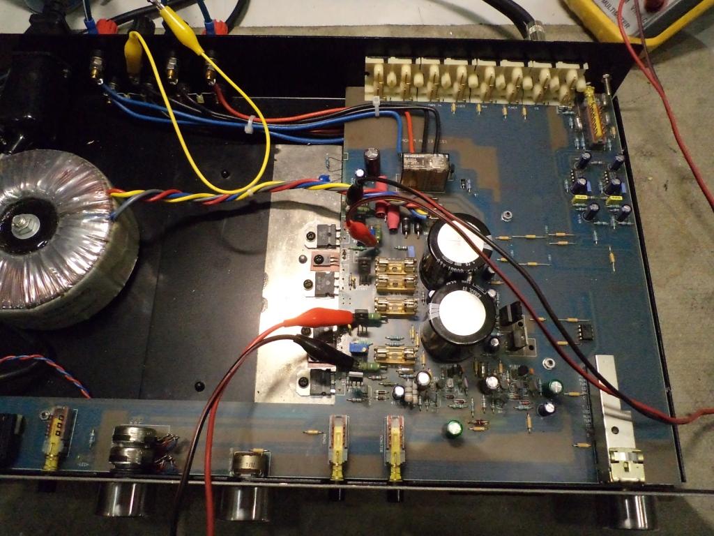

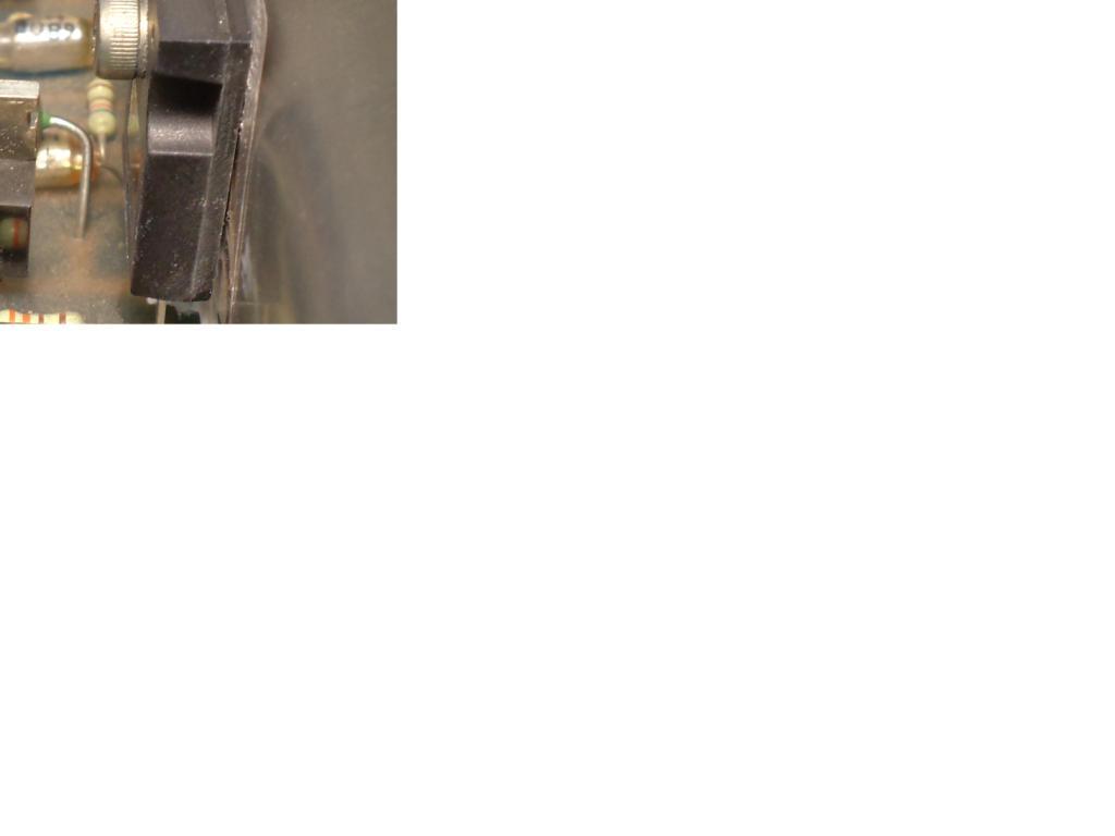

here is a classic case from Arcam ....cooling is not enough for the stated power , Vbe multiplier exists but for the one ch heat sink failed to meet the Vbe and Arcam made no changes and released the amplifier on the market without giving a F U CK about this ...
Look at the left Vbe and the look at the right

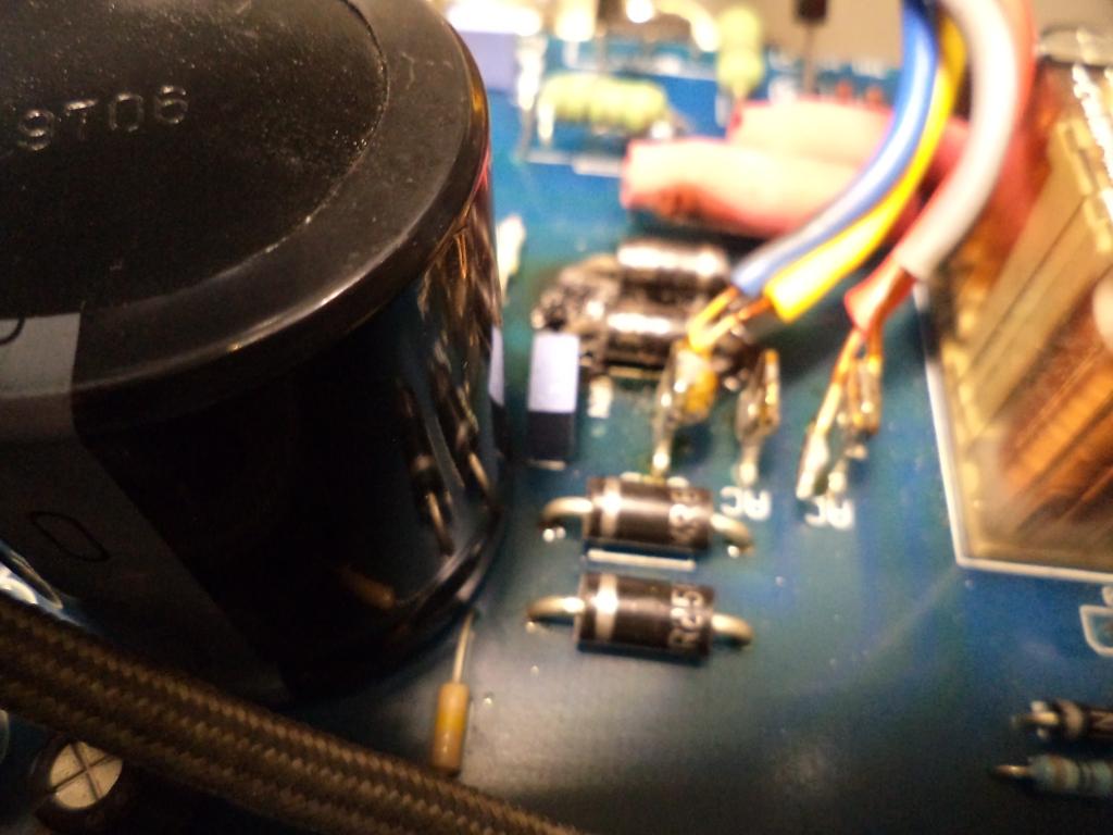

Marvelous magnum Pics and PLEASE if any one is able to tell me how its possible in this amplifier the Vbe is a NPN for the left Ch and a PNP for the right ch please let me know ...I will not be bothered to reverse engineer the schematic to find out ...

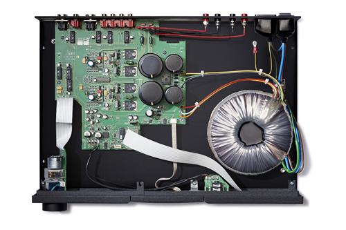

Look at Naim today not much changes These people do not want to learn

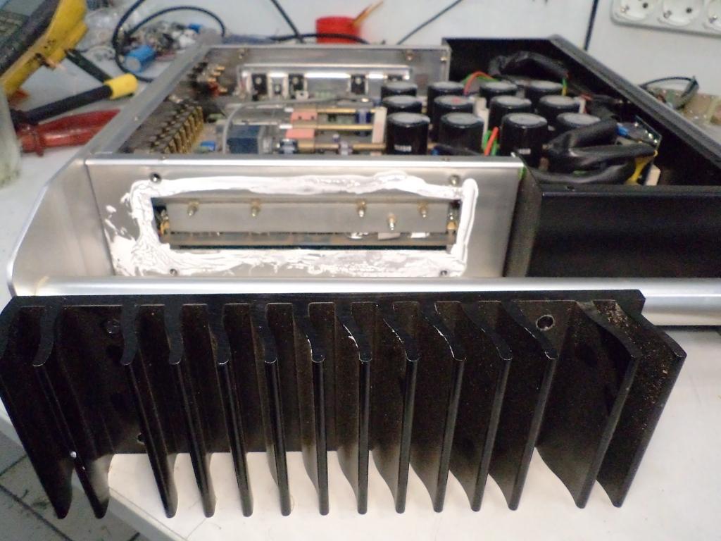

They state 60W per ch ....heatsink is the bottom of the case
Somebody tell me what am i missing ....is the bottom of the case capable to accommodate 120 W of dissipation ?

These are the statistics you may create your own conclusion ....
