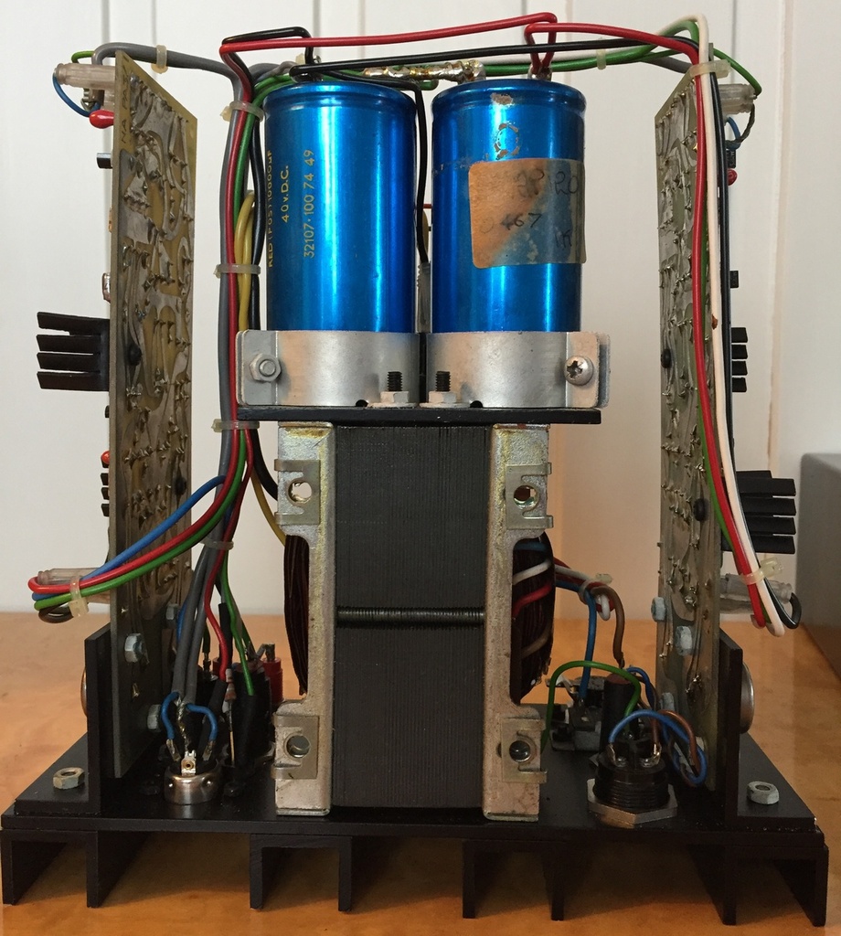

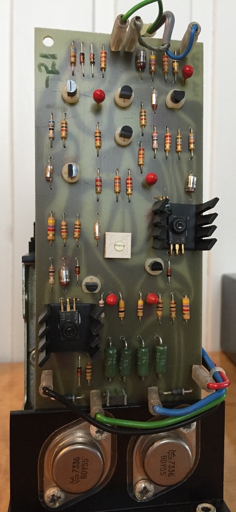

WOW ! - that seems to me to be a rare find. I've not seen anything about the NAP 120 and certainly none of those detailed photographs.
Read what the owner had to say about it: "What a great amplifier. Funky and dynamic with great transients and superb timing, which make it sound accurate and controlled as well. It plays with enthusiasm and never give up regardsless and can sound sweet, but also fierce when needed - impressive."
As links are wont to stop working I've uploaded the images here 🙂
Note - there are no Zetex E-line transistors, all TO-92 cans. I found a comment on the Naim forum that the NAP 120 was derived from the NAP 160 (JV's favourite?).
A very simple power supply, common rail caps for both channels and they look only to be 1,000F per cap. I think the EI transformer helps (only used in early versions, later changed to a toroid) as they tend to block mains-borne hash better than toroidal transformers from what I've read (it all depends on the windings...).
Whose to say I shouldn't just go with option a), the simple single-rectifier for both channels and be done with it. It seems nobody complains too much about the NAP 120!

Ah , my first work on Naim gear was with one of those NAP120s. I recall the difficulty and long delay obtaining the correct electrolytics and surprise at the E-I transformer. Local enthusiasts didn't rate the 120 very high on the scale of Naim models. Perhaps this was just prejudice because some examples here were manufactured under license in New Zealand, not only Salisbury, in those times when high tarriffs were used to restrict imports. Surprised? :whazzat:
