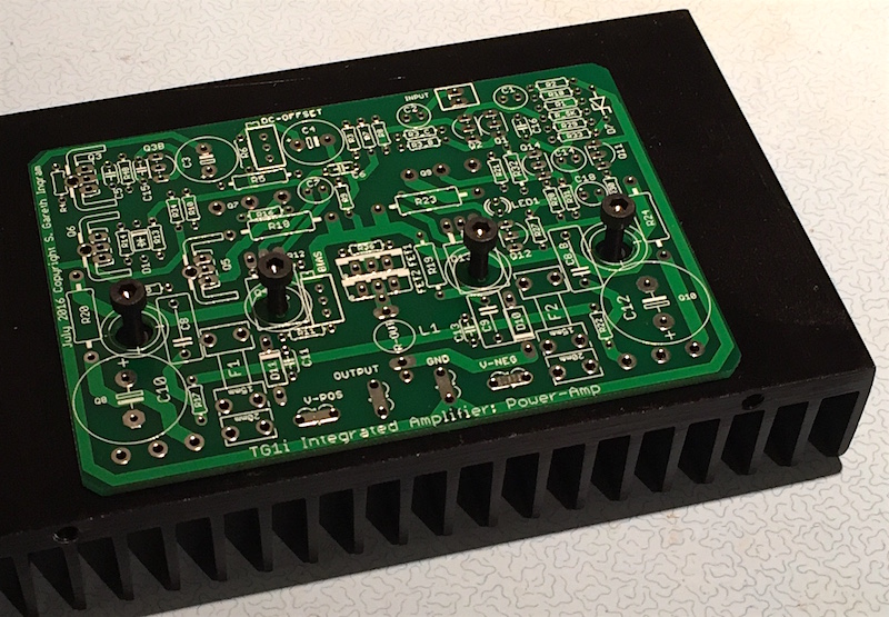

It's gonna be slow progress as I have a lot of other stuff eating up my time, but I'm going to sort out all the parts into three bins today, one bin for each board (psu, preamp, poweramp). I've got some heatsinks tapped and ready for the power amp.

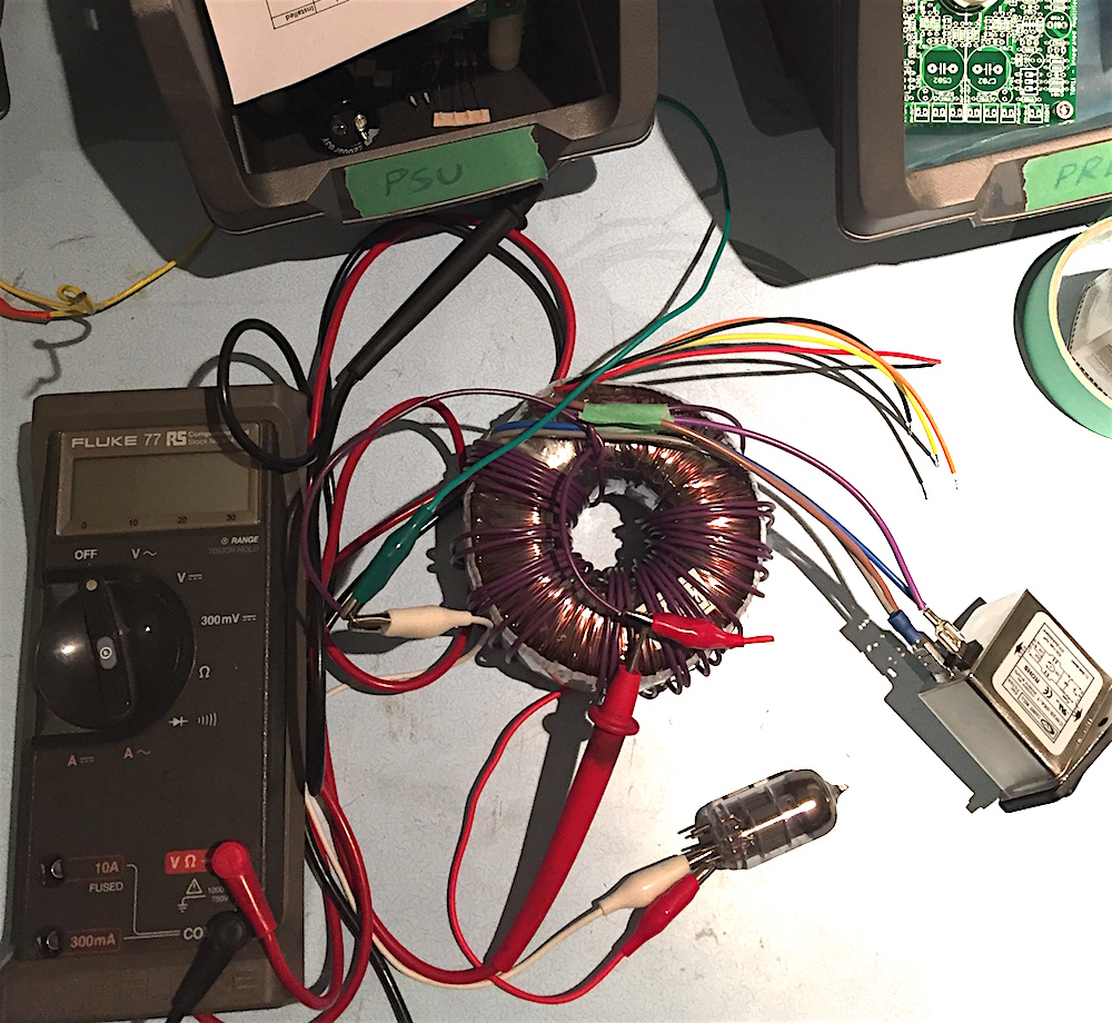

The heater of the pre-amp tube needs a 6.3Vac heater supply which I am tempted to get by adding a winding to the power transformer. Being a toroidal transformer it's relatively easy to wind some extra wire over it.
I put 4 turns of wire on the transformer and found that unloaded I get 0.878Vac. Using this I can calculate that I'll need about 29 turns. I added 29 turns of insulated multi-stranded wire (cus this is what I had on hand) around the transformer.
Unloaded it gives me 6.45Vac. Then loaded up on a tube with 300mA heater it drops nicely to 6.33Vac. Looks like it could be a viable approach. Of course it'll pick up rectifier noise from the +/- supplies so I'll think about a capacitor or two later on to draw this off to ground.

Standard stuff on the pcb. I've never ordered the extra thick, never crossed my mind to do so. Maybe a good idea though if you were planning to run continuously high currents or just wanted to halve the thermal and electrical resistance of the traces.
I'm not after really high power here, as you can see from the small transformer, rather I like to operate at the higher rail voltage because it gives me better headroom for peaks and a better operating point for some of the devices, including the triode.

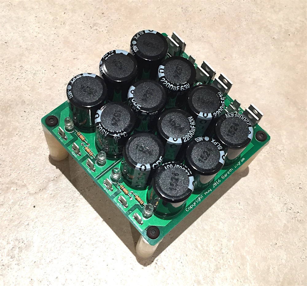

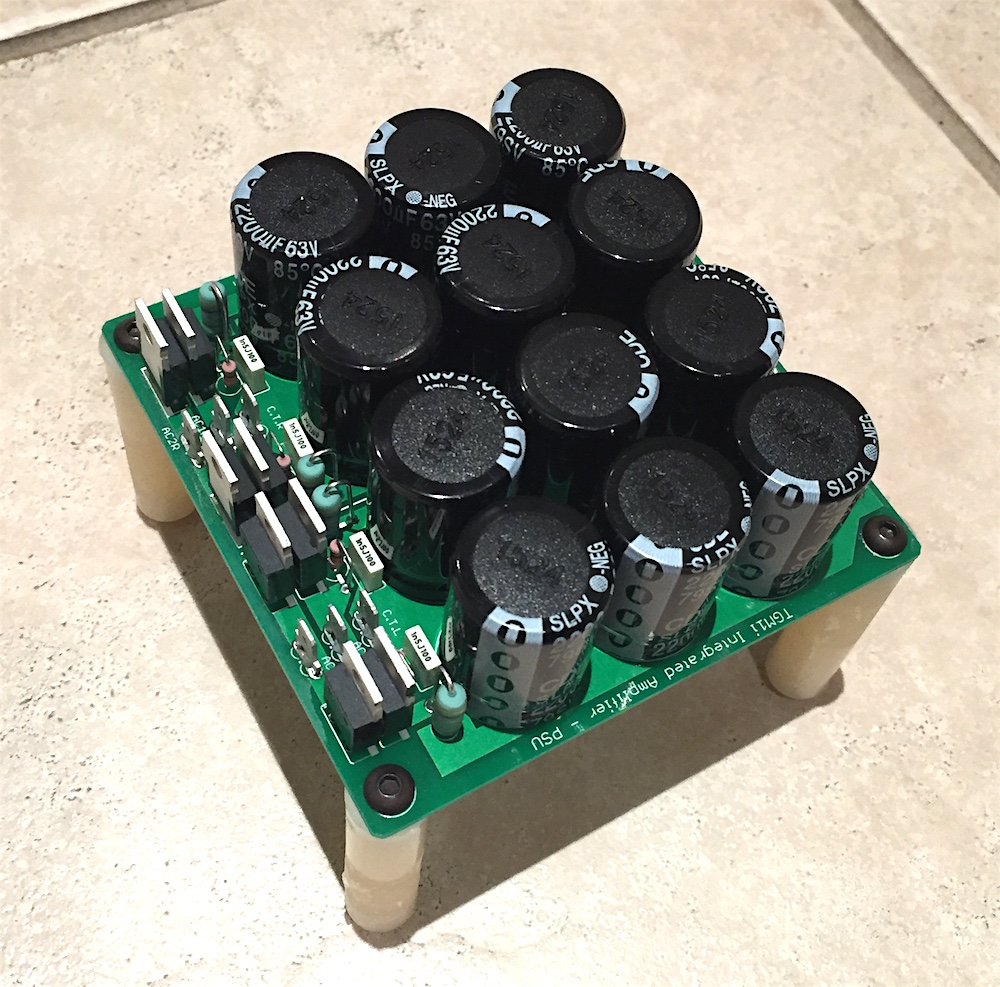

PSU powere-up
I tested out the PSU - just basic power it up and see if it blows up or produces the predicated voltage.
Well it nearly blew up. I've done this before so not sure why I made the same mistake again, but I plugged the trafo into the wrong pins on the board - swapping around the centre tap with one end of the secondary. If you trace out the circuit you'll see that this turns it into a voltage doubler so within milli-seconds my 63V caps had 80V across them, and climbing...... power-off fast ! discharge with a 2k2 resistor (it got warm) and then switch wires around and all is good again. Got +/- 54V unloaded at the output of the power supply.

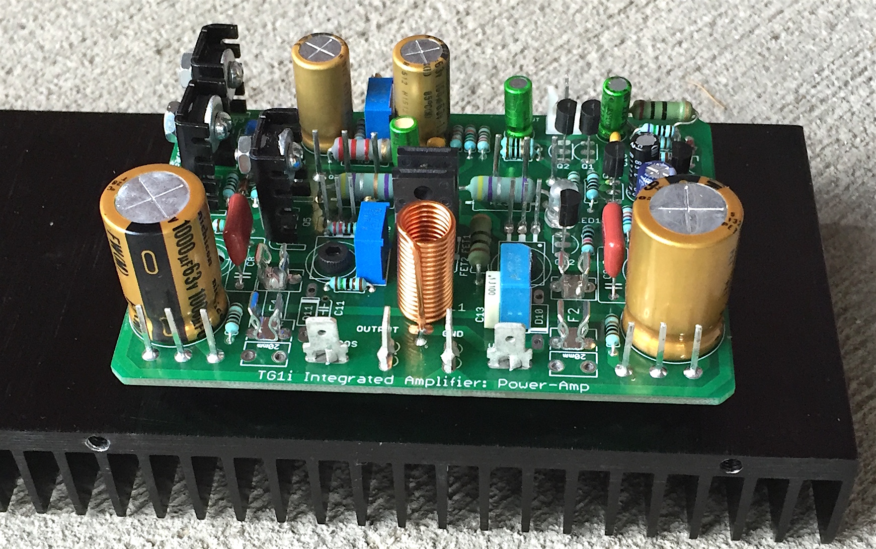

Power Amplifier

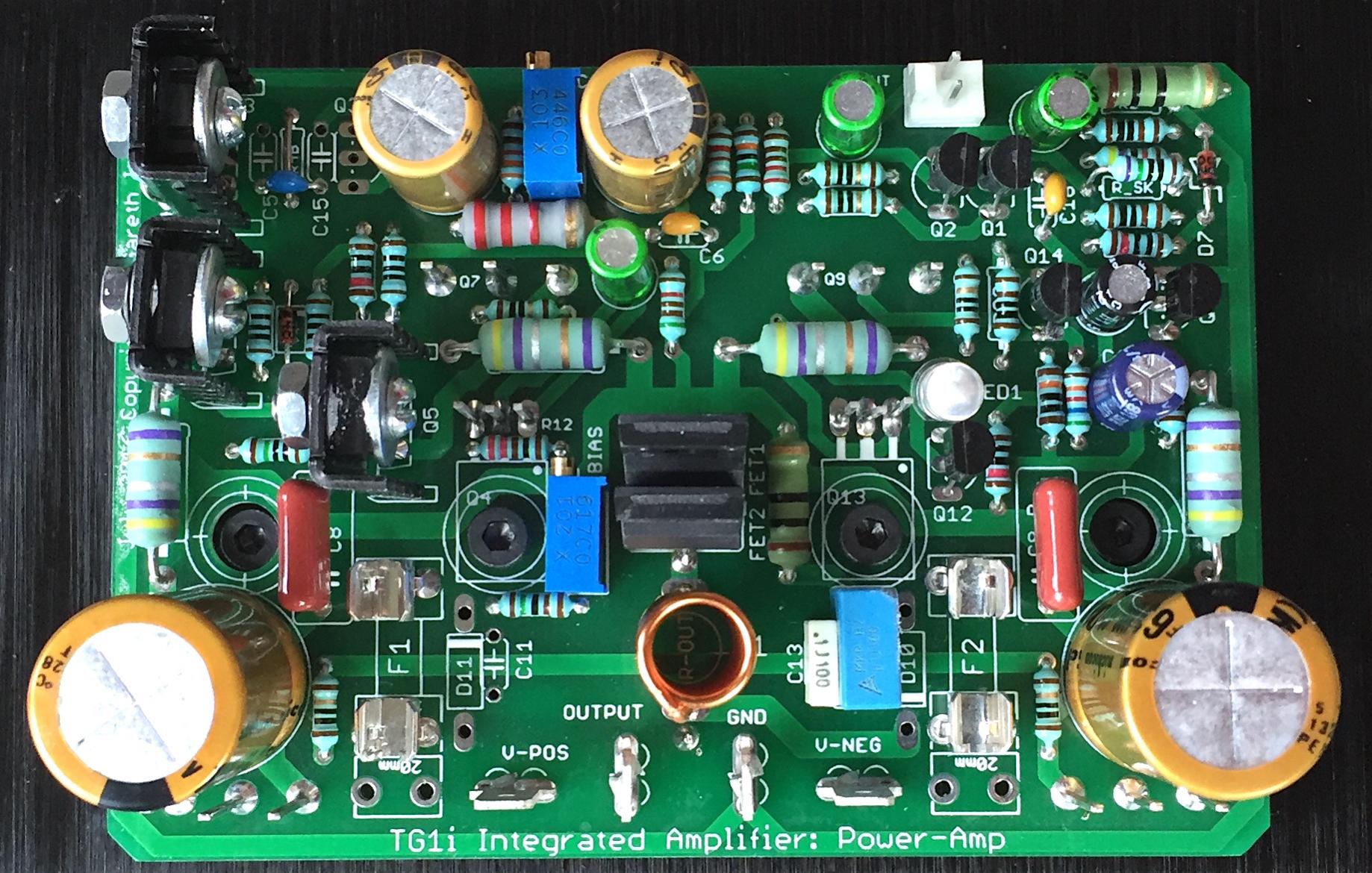

This forum thrives on power amps, so I've started assembling one. Found one of the resistor footprints was undersized (my fault) and the assembly is a bit fiddly with the mechanical stack-up but it seems to have all gone together. I'm missing the catch-diode, my junk box diodes were too fat but these can be added later.
My bench top regulated power supply doesn't reach +/-50V so no safe current limited option. I will use the power supply board made for the amplifier and put some power resistors in series with the rails for the first power-up - excess current draw will pull the rail voltage down and hopefully avoid disaster if the bias is wrong or some other mistake.

Beautiful work !!
Do yourself a favor and quickly built a power cord with a light bulb (120Vac, 60W) inserted in series on the live side, it could prevent a disaster.
p.s. Where are the tabs of transistors Q7, Q9 all we see is the legs that are soldered...
BR
Eric
The power resistors do same job as light bulb but work on DC rails.
They don't. It's PTC effect of the tungsten filament that gives the protection that a pair of secondary resistors cannot achieve.
A voltmeter across the power resistor is useful to give current as well. Anything above 1A (10V on a 10R) on startup is a sign to quickly shutoff power to transformer and debug before anything fries.
Too late, the damage has already been done in discharging the smoothing capacitors through the faulty wiring.

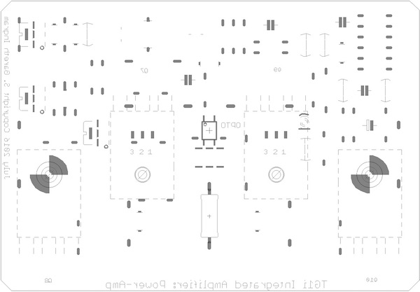

Not sure if the attached makes it clearer - the dashed lines are the outlines of the power devices, this image shows more or less what is mounted under the board.
