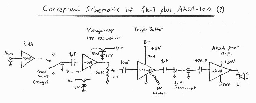

There's a quite a lot to consider, the GK-1 is not in the public domain and I won't attempt to reverse-engineer it here. But from what has been published I can draw an overview of what a GK-1 and AKSA-100 might look like - a bit of a guess on my part.
There's too much here for me to include in this project but I think it can be simplified without losing the essence of it. First off, I don't need voltage gain from the pre-amp for my music sources but I do want the RIAA and the anti-phase shunt regulated tube buffer thingy. And for anybody following along who didn't want the RIAA they could wire it up as a 5dB voltage amp instead.
The power amp should be carefully considered even though we have a fairly good idea what that looks like. I'll take the baby AKSA concept / TGM1 power amp and add a second pair of output transistors, but the devil will be in the details.

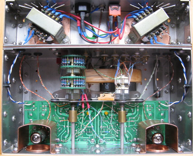

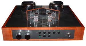

Here's a nice photo of one chaps GK-1 (underside) and a photo of a professional version. Isn't it a beauty ! - that's a lot more preamp than I will try tackle here though but I will get a taste of it, something to be inspired by for this project

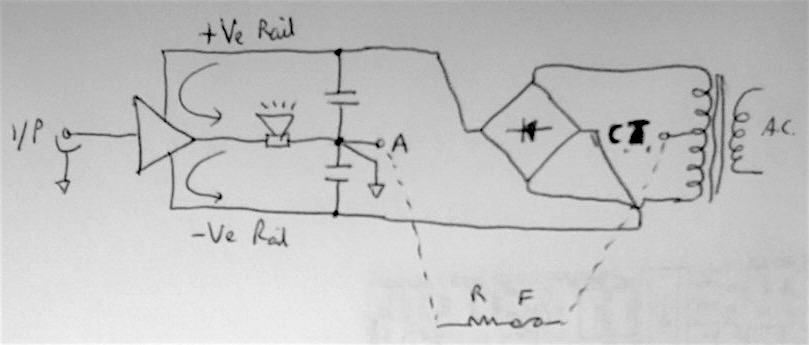

Joined 2009
If we go with dual-mono supply there's another way to look at this, an approach I took with my TGM7 (mono) amplifier.
See the drawing I attached - the only way that dc current can flow through the speaker is if point 'A' is attached to the centre-tap of the transformer 'C.T.' since current must flow in a loop.
By placing a limiting resistance between point 'A' and 'C.T.' it's possible to limit the current that can flow. In normal use, the power supply rail capacitors (shown) are the return path for the a.c. signals flowing through the speaker and no current should flow to the centre-tap of the transformer. Of course, there is some frequency, a low frequency, at which the rail capacitors become a higher impedance than the connection to the centre-tap of the transformer and current will flow that way - all this means is making sure the rail capacitors are large enough.
This approach would keep d.c. out of the speaker. In a stereo set-up both channels must have their own supply, or at least separate windings on the power transformer.
And this approach would not prevent start up or power down noises from the signal chain or amplifier affecting enjoyment so a means to mute the sound may be useful ( a shut relay from VAS to ground would probably suffice and it would not place any relay contacts in the signal path ).
Any recommendations as to best set of trade-offs ? (I'm not that concerned that a mechanical relay at the output will somehow spoil the sound but I wait to be corrected...)

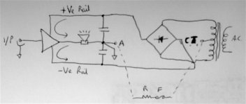

Just for my education: Can one shift the ground connection shown to the other side of the LS ?
Pl see http://www.diyaudio.com/forums/solid-state/170837-140v-single-rail-nmos-amp-5.html#post2270892 for a similar idea for LS connection.
Joined 2009
Yes, you can place ground anywhere you like more or less (in the example shown you will have your speaker connections at a dc voltage so care would be needed not to short the wires to the chasis or some other grounded object). But note that the RCA cable coming to your amplifier likely has the outer shield/return at ground potential.

Here's a nice photo of one chaps GK-1 (underside) and a photo of a professional version. Isn't it a beauty ! - that's a lot more preamp than I will try tackle here though but I will get a taste of it, something to be inspired by for this project![]()
Interesting Gizmo certainly.
Does seem like The antithesis of KISS tho.

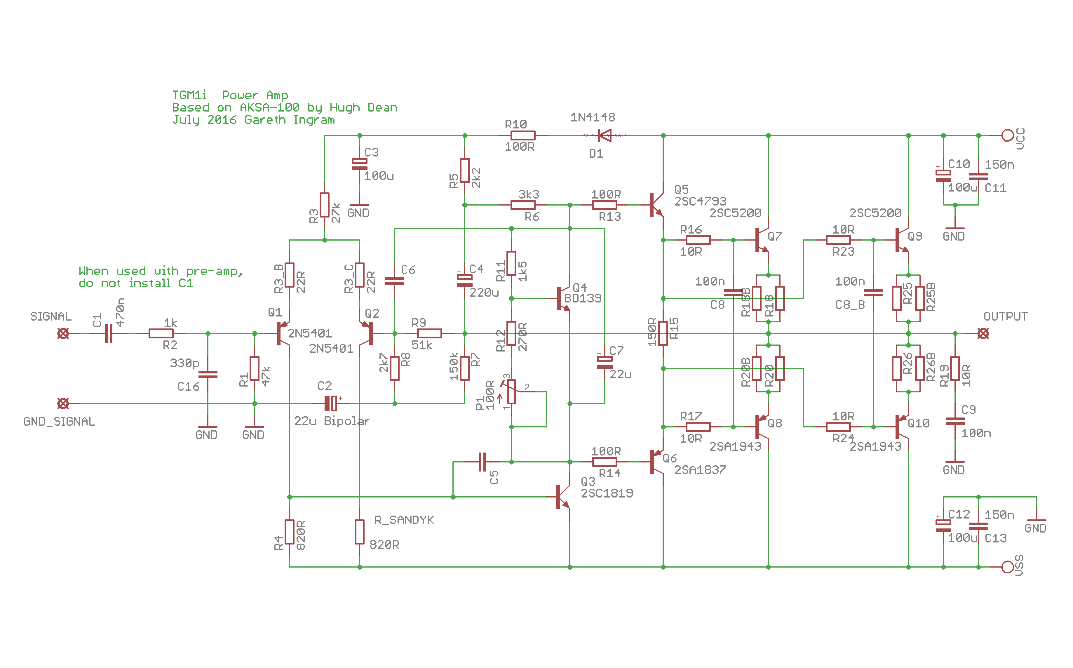

Better get a schematic up here before I get bored 😛
This is what I think the AKSA-100 is close to, based on the links I gave in the first post and some reading I've done on the internet at this and other forums where the AKSA details have been given some public airing.
The feedback network is much closer to what AKSA uses than I had in my first TGM amplifier. I don't know what values Hugh used, so unless he releases those I am making a stab at something which is probably close enough. The concept of the feedback network is to separate a bit more the ac and dc signal paths. The benefit was never clear to me but this link has at least one explanation for it: Power Amplifier Clipping
I haven't used a ground-lift resistor in my own designs for many years so I've dropped it from this version (Hugh labels this resistor R2) and instead I have incorporated an RC filter to reduce r.f. ingress at the amplifier input. I've included an input coupling capacitor but I have no plans to use such a thing when I built it into a chassis with a pre-amp that already has a coupling capacitor on it's output.
I have also included LTP degeneration resistors, this was part of an upgrade to AKSA. I've used 22R for now.
I have also included a resistor in the 'unused' leg of the LTP. This was proposed by a forum member SandyK many years ago and was derived from listening tests. It is NOT about trying to balance current in the LTP legs, it is about equalizing the voltage at the collectors to balance the Early Effect. I have no idea if this is a worthwhile addition but I show it to generate some debate.
I may have the gain set too high. I suspect that the LTP current and the value of R4 is different from the baseline AKSA-100 too and maybe worth some debate - and guidance from Hugh.
Hi Bigun
I'm not sure that AKSA ever offered speaker protection as an option for the kit, so if you're trying to stay true to the original formula then that's a consideration.
I just don't see the point of using a mechanical relay to protect against DC when nowadays we are spoilt for choice with rugged Power FETs that have extremely low Rds(on), unless (a) it is being used in the speaker line and (b) we are paranoid about FET distortion and want to use some high quality "audiophile" grade relay as an alternative.
I really like the protect circuit you designed into TGM8, but nowadays I use Power FETs inserted in the main rails to cut power to the outputs in the event of a problem.
In terms of the AKSA circuit, it has always bothered me (probably for aesthetic reasons only) that the RC filter is on the +ve rail where the current sources are arranged, when in actual fact it would do more good on the -ve rail wedged between the driver and VAS transistor, assuming of course that the LTP tail had a proper current source. But Hugh designed this to sound good (and by all reports it sounds exceptionally good...) and not necessarily win awards in the laboratory measurement stakes... I guess the P3A better appeals to my aesthetic tastes, but I sure would like to build an AKSA some day.
