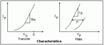

I never tried this variable mu tube, it seems counter-intuitive to me ?
A triode is a transconductance device (just like transistors) and produces a change in current for a change in input voltage. This current produces a change in voltage across the load resistance. For a common cathode stage this load resistance is both the internal anode resistance and the external load resistor. Although the gm varies with current the internal anode resistance varies in a complementary fashion so that the voltage at the anode is fairly linear and the gain is fairly constant. Remember that mu = gm x internal anode resistance. When gm goes up with current, internal anode resistance falls and mu is roughly constant.
For a cathode follower there's very little impact on operation from the internal anode resistance and the gain no longer follows mu, it follows mu / (mu + 1) and the impact of a variable mu tube will be very small unless you operate at a very bendy place in the curves. There are very few variable mu tubes with high gm, a feature you want for a CF to have a low output impedance so variable mu tubes are not convenient here.
You can achieve varying levels of distortion results without a variable mu tube by simply choosing your operating point and your load resistance appropriately. The circuit I've used has the nice property that the distortion profile is dominated by 2nd and low order of decreasing magnitude which is the traditional 'tube sound' and can be readily adjusted through a simple resistor value.

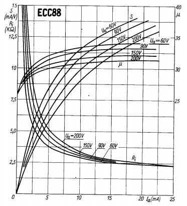

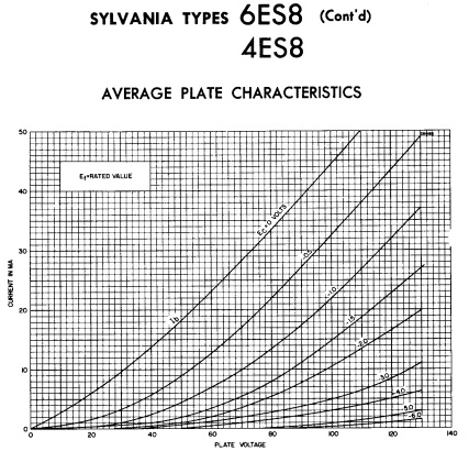

Some related plots...
The 6DJ8/ECC88 curves show how mu is mostly constant because the gm (S) and internal resistance (rp) compensate for each other.
If mu were constant the usual triode curves would show a set of equally spaced plate curves, but for 6ES8 the curves start leaning over quite early so mu is clearly not constant....
