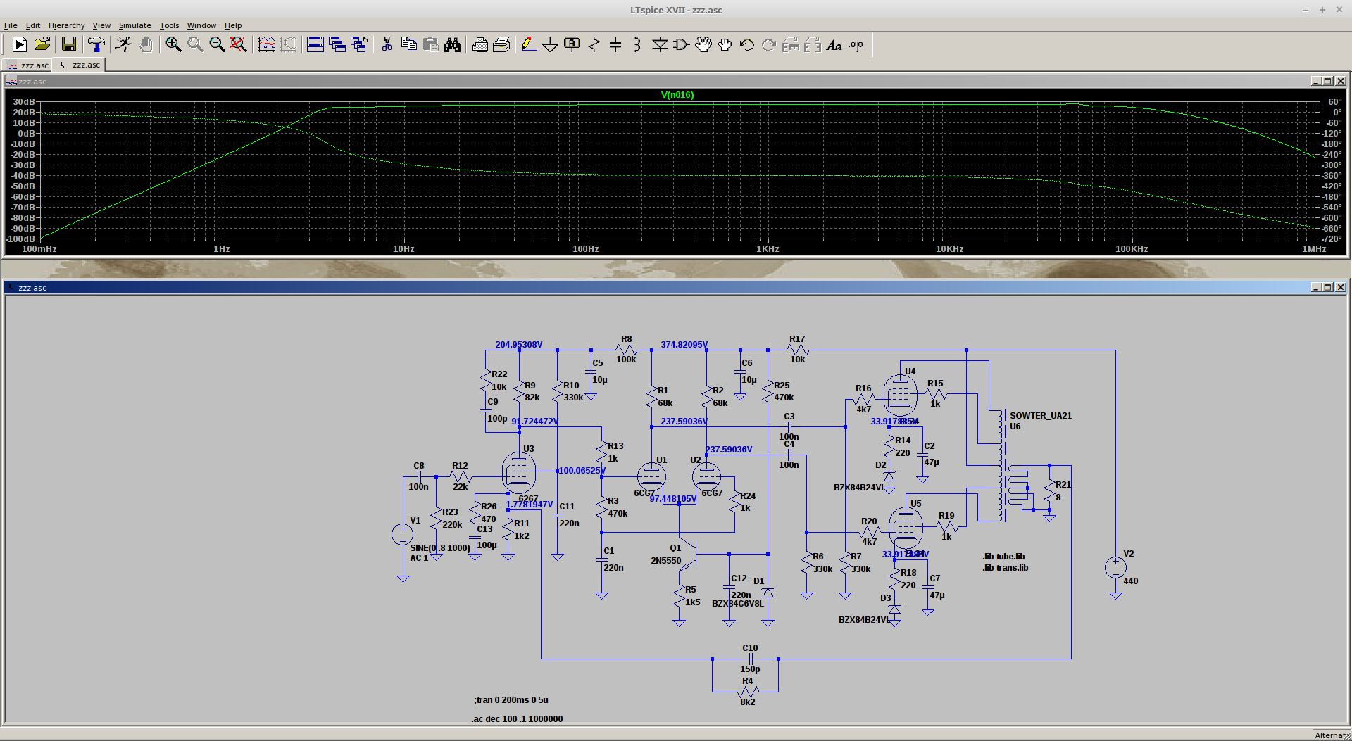

What does the su option on .trans do as it seems to be non-standard? To avoid settle time, I have had to use .ic to ensure the capacitors are fully charged as they would be in the stable state.
Also, how does .ac work on non-linear devices when the stable state has not been evaluated?
I think the trick is to build to one schematic only, not take the best of all, its not quite like lego. I have not the energy to have 3 on the go! Your original will have low low a gain which is why we moved back to pentode. IF you want a schematic straight off the shelf you can build to the modified Mullard circuit you found, but note your OPT is different.
Ha Ha - took some digging not su but 5u - minimum time step. Lt spice should do DC biasing automatically unless the process has failed which is what you are seeing.

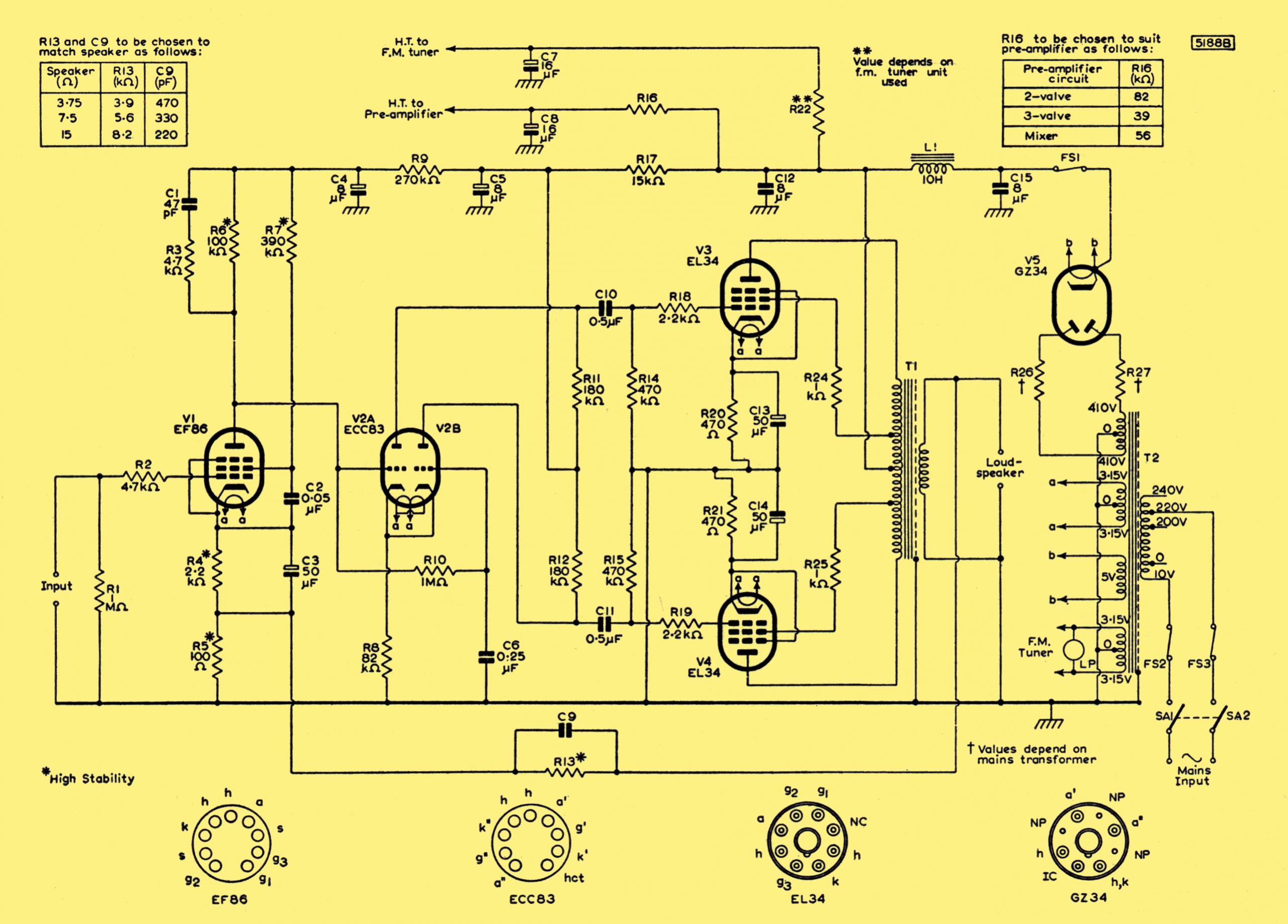

nope its this one 🙂
TTG-EL34PP - Tube output transformer [6,6kOhm] 2xEL34 / 2x6L6 Push-pull or similar - Shop Toroidy.pl
Also I have the actual original schematic of the amplifier (except for the cathode resistor in the phase inverter is 56k ohm). Also if you would not mind to figure out the components values arround the EF86 to change the input sensitivity from 220mV to 1V (thats what most of my quipment does output).
Everything in mine is original except R8 which is 56K in my amplifiers and C13 and C14 which are 470uF

nope its this one 🙂

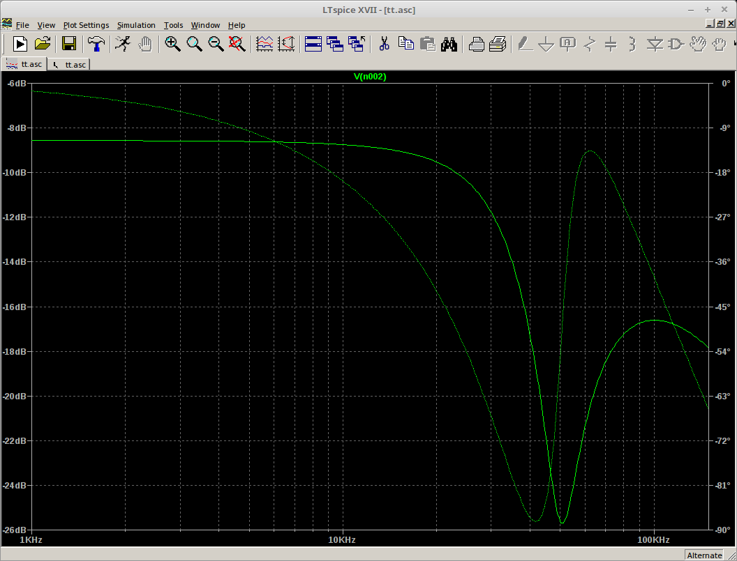

I will need gain and phase plot for the test circuit - your speaker is 8R.
If you wish for me to try and get some NFB values for you I need an accurate model of the UA21 OPT. I would need you to sweep the transformer using the circuit attached with say a 10V input, and measure the ratio of the secondary voltage to the primary voltage with the output connected up for 8R into an 8R load and a source impedance from the signal generator of 4k7. More importantly I need the phase difference between the two traces. This would be for 1,2,5,10,20,30,50,80,100,120,150 KHz spot frequencies - is this possible?
The data sheet for the transformer is not going to give the information.
I’ve “Heath Robinson’d” something together that appears to be working in order to make these measurements. Do you need from 1KHz up only? One minor difference will be that the output from my signal generator only goes up to 7Vrms / 20Vp-p.
I've plotted all of the measurements on a graph, converting time differences to phase angles. It gets a bit confusing where the phase inversions occur. This also has Vp-p plotted too for 20Vp-p input signal. I also have the scope shots which I can post if necessary.
Data plot
Without a lot of time this is as close I can get:
.SUBCKT SOWTER_UA21 1 2 3 4 5 6 7 8 9 10 11 12 13
+PARAMS: LPRIM=40 RPRIM=192 RSEC=.05 LLEAK=10m CLEAK=1n RLEAK=15k CPRIM=1.5n LRATIO={1/2500}
* LPRIM IS THE TOTAL PRIMARY L (VARIES WITH MEASUREMENT).
* LLKG IS THE LEAKAGE L (MEASURABLE: CONSISTENT).
* RPRIM IS THE TOTAL PRIMARY R.
* CPRIM IS THE MEASURED PRIMARY CAPACITANCE.
* LRATIO IS THE INDUCTANCE RATIO: (4 OHMS)/(PRIMARY Z).
LS1 1 20 {LLEAK}
CS1 1 20 {CLEAK}
RS1 1 20 {RLEAK}
CPR 20 25 {CPRIM}
LP1 20 21 {LPRIM*.09} ; .7164H ; PRIMARY
RP1 21 2 {RPRIM*.3}
LP2 2 22 {LPRIM*.04} ; .3184H
RP2 22 3 {RPRIM*.2}
LP3 3 23 {LPRIM*.04}
RP3 23 4 {RPRIM*.2}
LP4 4 24 {LPRIM*.09}
RP4 24 25 {RPRIM*.3}
LS2 25 5 {LLEAK}
CS2 25 5 {CLEAK}
RS2 25 5 {RLEAK}
LP5 7 31 {LPRIM*LRATIO}
RP5 31 6 {RSEC}
LP6 9 32 {LPRIM*LRATIO}
RP6 32 8 {RSEC}
LP7 11 33 {LPRIM*LRATIO}
RP7 33 10 {RSEC}
LP8 13 34 {LPRIM*LRATIO}
RP8 34 12 {RSEC}
KALL LP1 LP2 LP3 LP4 LP5 LP6 LP7 LP8 .99995
.ENDS
