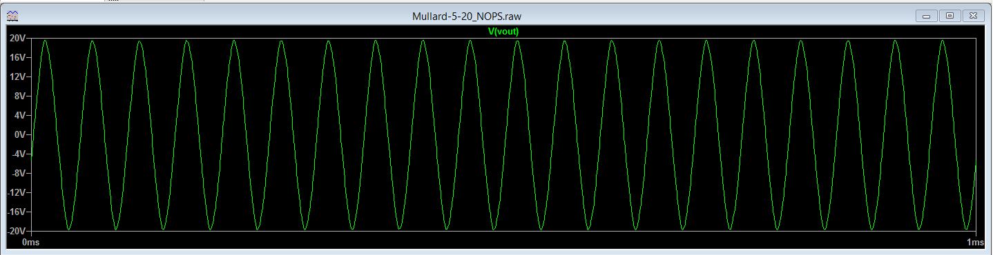

I found a 5-20 LTspice simulation on this site (somewhere) and ran a couple of tests with a modest power output. The tests are using a roughly 15KHz squarish wave.

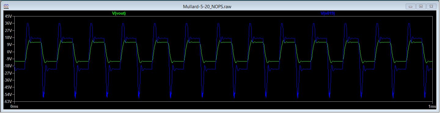

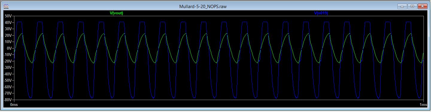

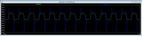

Some more results below. These are unrealistic operating conditions of a continuous 15-20KHz 20W waveform which would instantly blow up the tweeter in any speaker. Below are EL34 grid and output waveforms for 15KHz sq wave and 20KHz sinewave and they have caused the DC operating conditions to get messed up. I don't think a CCS will change anything and the relatively small improvement of changing the LTP valve and load is likely to be outweighed by the loss of gain and increased non-linearity.

My criteria for a good amp is can it pass a full 15KHz sinewave without visible distortion. It is an unrealistic test, but it does demonstrate you have adequate slew rate handling. Interesting that you results are wore than mine maybe your transformer is more accurate.
I think that due to my solid state back ground, my expectations of how a valve amp would behave have been a bit skewed. It's reassuring to see that they all get a bit out of shape in the 10KHz+ region at higher power levels as I hadn't expected this. I just expected the amp to clip and that was that. My preference was to initally build this as a mullard then play with it to see where I could improve it. At this point it's just become a case of make it as good as it can be then leave it.

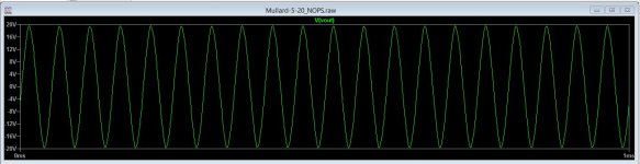

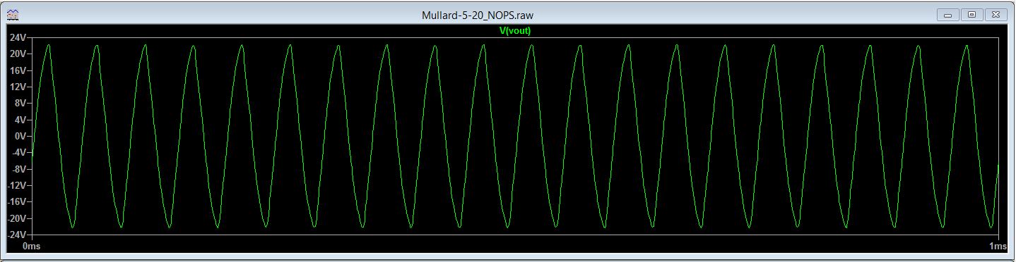

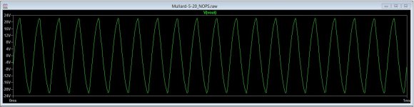

I have now set some 'initial conditions' to skip the 3 second settling period which made LTSpice VERY slow. Firstly, I have no idea if the output transformer model is likely to have any resemblance to yours but the simulator results have shown similar characteristics to your experience. There are 2 traces for 20KHz below, the first is just before the driver pushes the EL34 into grid current at around 25W (20V peak) and the 2nd is after it enters grid current. This is not a limit of the driver it is the output stage. The driver waveforms look very distorted as the -ve feedback is making corrections to maintain the input waveform shape on the output.
Based on LTSpice, the 5-20 driver is not showing any significant limitations and the 30dB -ve feedback appears quite capable of keeping the output on track.

The spec sheet for the TG2000 function generator I’m using says <22ns (0.022us) rise time. That says it can quite easily pump lots of RF harmonics in with ease. I would use my Lindos set but currently the generator isn’t working properly and the analyser has a dead lcd.

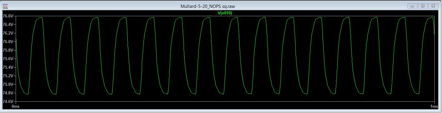

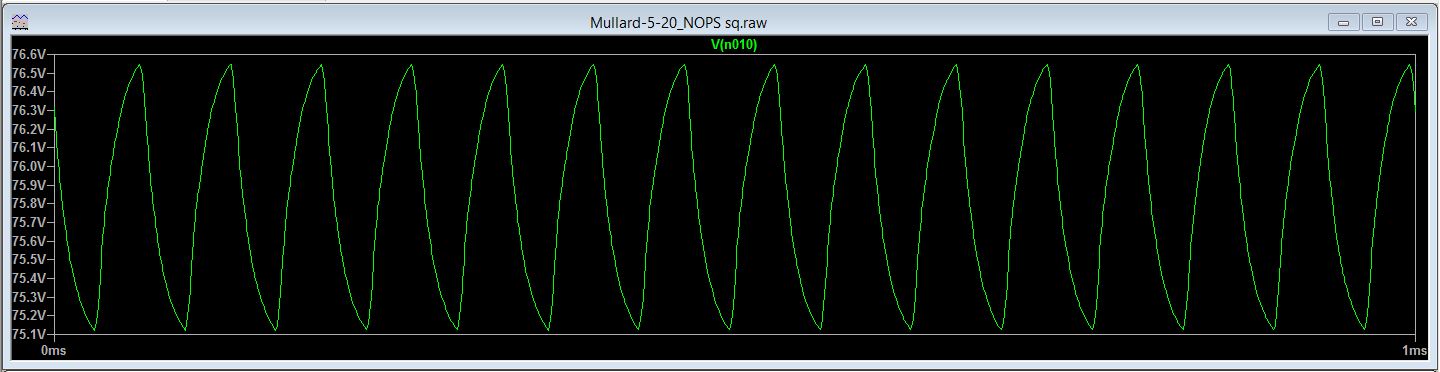

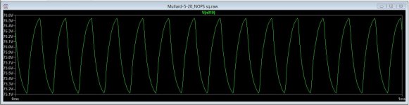

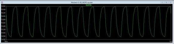

Fast rise time will get lost at the EF86 as the anode is slugged by the V2 miller capacitance. Below are waveforms for EF86 anode, open loop with a 15KHz square wave input (5uS rise time), with and without V2 connected. This appears to be the weak link in the 5-20 design rather than the LTP.
It would be interesting to see what the waveform looks like on your triode wired EF86 with a square wave but you would need to remove the RC network on the anode and disconnect feedback. My gut feeling though is that any changes to make it 'faster' will only result in instability.

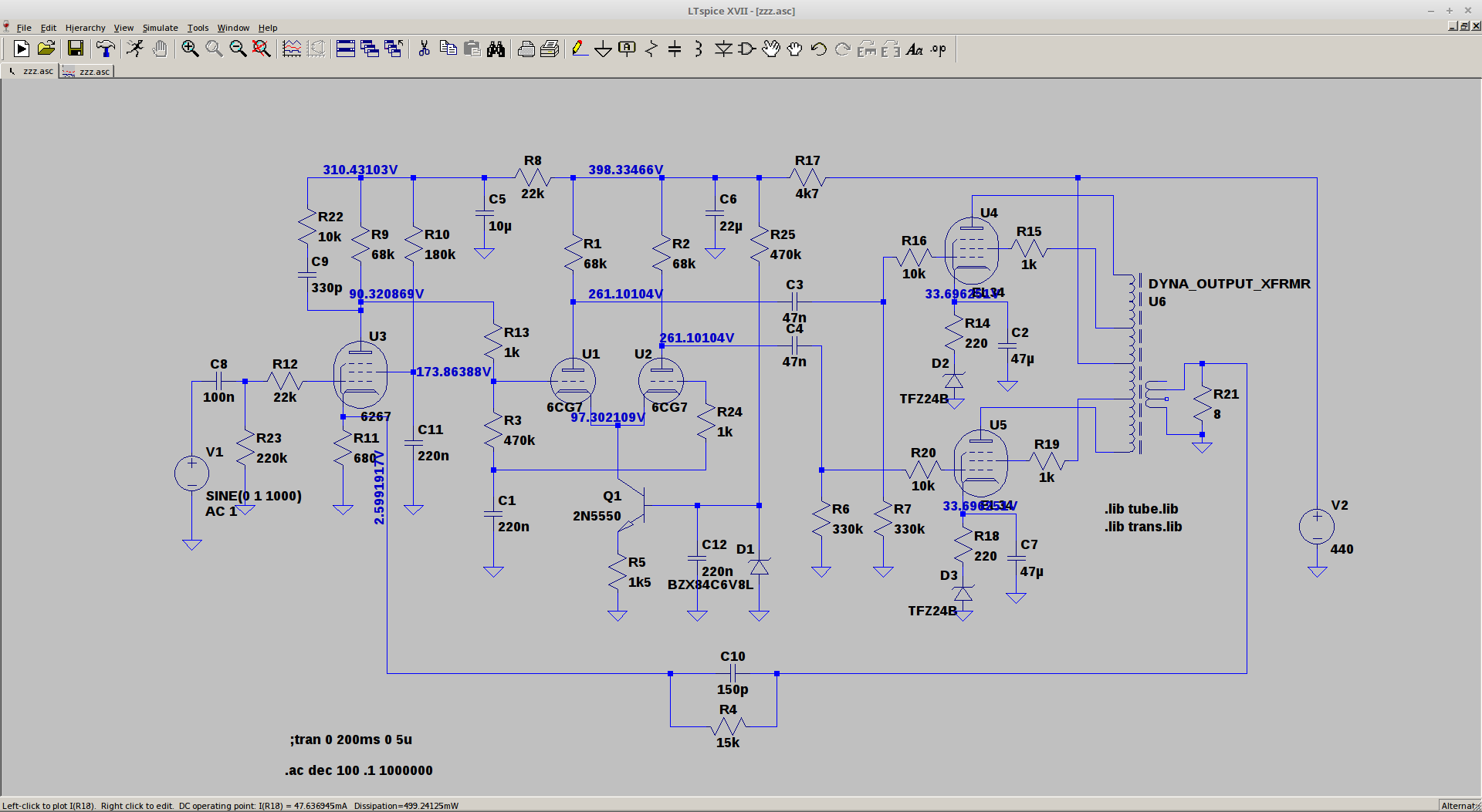

Hopefully the bits and pieces I need to try out the 6CG7 PI should be arriving tomorrow. Something that crossed my mind having come across it in reading, how does running EF86 as a pentode affect the frequency response what with impedance and miller effect?
Also based on the simulations of the EF86->6CG7>EL34, what should the input sensitivity be. i.e how many mV in for x watts out?
Could you post your proposed schematic with the 6cg7 just so we can check we have the bits correct.
I was using your schematic from post 186. I may well leave the output stage cathode bias as is for now, but I have got the necessary components to add the zeners. C6 can't be 22uF as I don't have one. I have either 10uF or 47uF. I'm working on drawing up a proper schematic including the psu at the moment.

OK yep 47uF would be fine. Yes you need to move back to pentode mode in the EF86 as the gain will be too low. It more linear anyway. I don't have the exact model of the output transformer at the moment so the FB may be approximate. Interestingly its very very close to the dynaco modified mullard circuit which pjl123 simulated. You could go with this tried and tested just would replace the 22k with the CCS. This has a 12pF back from the screen of the primary of the transformer to help with the NFB. Again the NFB will need some tweeks for your transformer.
I understand you don't want to try the output zeners yet. It will allow you to operate the EL34's at a lower quiescent current (as they are close to red plating at the moment) while giving you a bit more output power and much less distortion near full output.
I am not convinced about reducing the coupling capacitor that much as it will take the load off the driver for LF signals and that will make the excursion on the driver greater. If you want to get rid of LF it is better to do that at the input.
