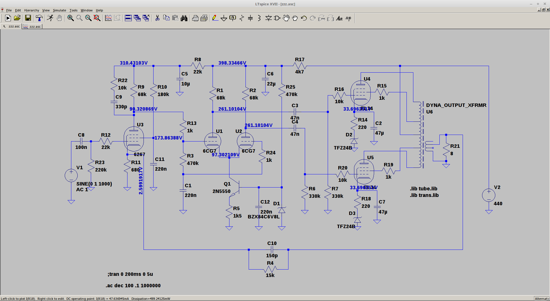

The simulation shows negative ringing on the output even through thats using a perfectly symmetric transformer, so fortunately that's probably not to blame. Its more to do with the LTP centre voltage shifting as the drive waveform becomes asymmetric. This changes the gain of the LTP and EL34 between positive and negative cycles. Its being made much worse by the output self bias, which biases down to cutoff and drops the gain of the EL34 dramatically. The reduction of gain on the negative part of the waveform make the NFB become less stable.
This would be my first go at your topology with V2 of your choice. Works out rather well actually.
The 24v zener would be 1n5359 and the CCS 2sc2611.
Interesting. Does this perform better than the CCS modified 12AX7 version we looked at earlier? Do the zeners in series with the cathode bias resistors on the output provide some form of regulation for the biasing? How does the NPN transistor based CCS compared with Eli's original suggestion of using a 10m45s?
Yep Eli suggestion of a 10m45s would work fine and is less components both are good enough.
Does it perform better - well its what I would design and you did not like the 'weedy 12AX7'. It does improve the drive to the EL34's so will work better at high frequencies. I went back to pentode as more gain is required and is more linear at the low plate voltages as the swing is much bigger. Does it fix the ringing - no. But is it worth the change for you - well thats up to you! I think its better practice, and if your not happy with something then it won't sound as good.
The 24v zener will stop the bias drooping at high output so much to the point it causes crossover distortion. It also reduces the variation in gain with output power so will help with the NFB. It also means you don't have to bias the EL34's so hot and risk damage. It does produce more output power - so this is quite a measurable improvement. On the down side the EL34's need to be more accurately matched and you may need to adjust the bias resistors to get the same current in each side.

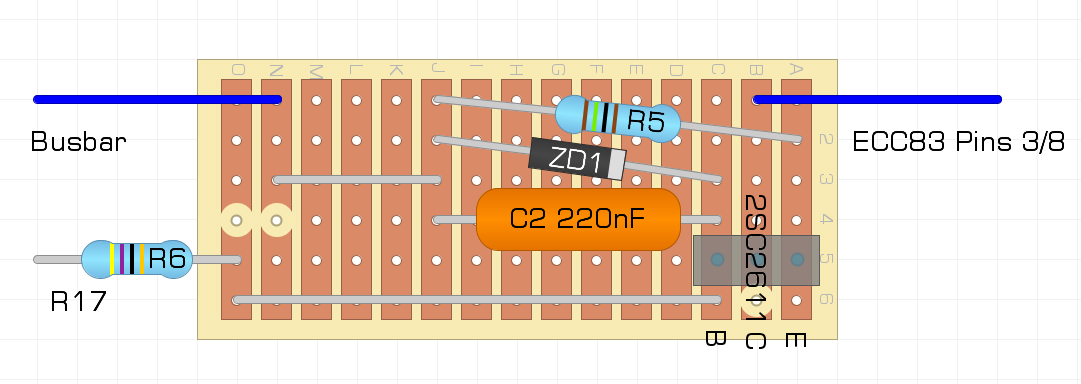

As to the CCS, is there any reason to prefer a zener over an LED using the veroboard drawing I made previously?
Only that a zener has a pretty tight tolerance so the current you get is quite accurate. It also places a much larger voltage across the emitter resistor so the temperature variation of the Vbe will be much lower. I avoid mosfets as you need a pot to trim them with, I reckon you can get that board even smaller.
Suits me. I'm not going to make the initial board smaller as I happen to have a spare bit that is that size. Will BZX85B6V8-TR or 1N5235BTR do in place of the SMD?
This is how it now looks.

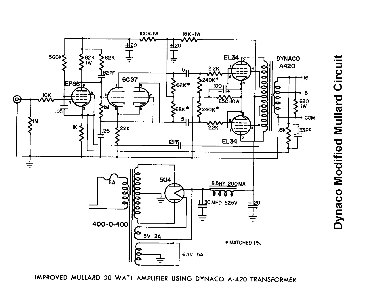

One thing I did find during my hunt through all of the documents I've collected is a dynaco modified version of the mullard 5-20 that uses a 6CG7 PI. Wonder how that compares with the simulated version baudouin0 produced with the CCS tail.
IMO, that Dynaco 6CG7 variation would do well, with a LTP tail CCS. Notice that it seems to be a "cross" of the 5-20 and HF-87. EICO accounted for non-ideal behavior of a resistor tail by employing asymmetrical plate load resistors. A tail CCS eliminates the need for that tweak.

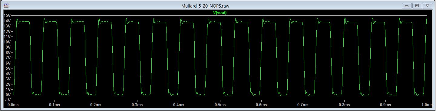

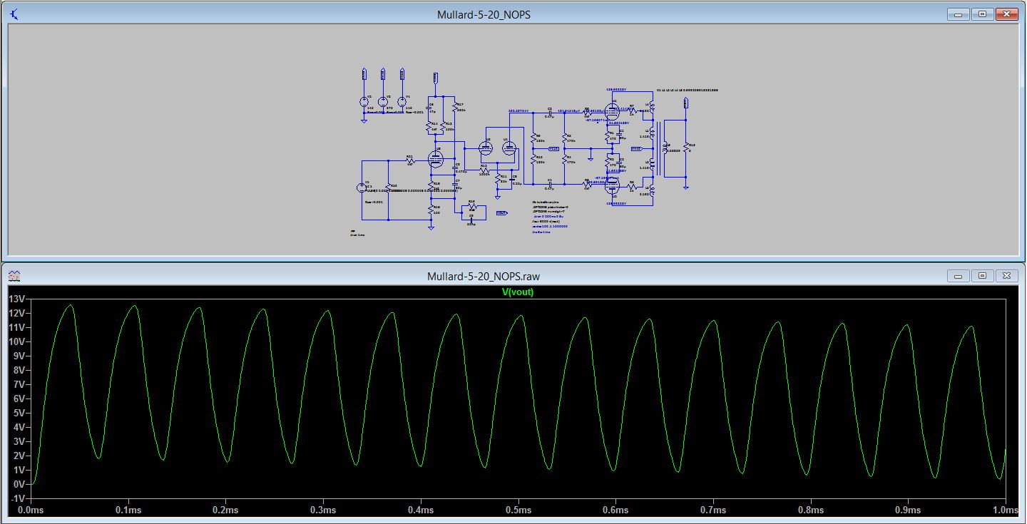

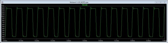

I found a 5-20 LTspice simulation on this site (somewhere) and ran a couple of tests with a modest power output. The tests are using a roughly 15KHz squarish wave.
The first is with no feedback and the output has no ringing but rise time limitations from circuit capacitance and the transformer give a very poor result.
The second is with the feedback attached and that shows the ringing that is to be expected from a responsive amplifier with lots of -ve feedback. The LTP anodes have excessive ringing as the feedback is trying to reproduce the incoming weaveform. Amazing what feedback can do...
