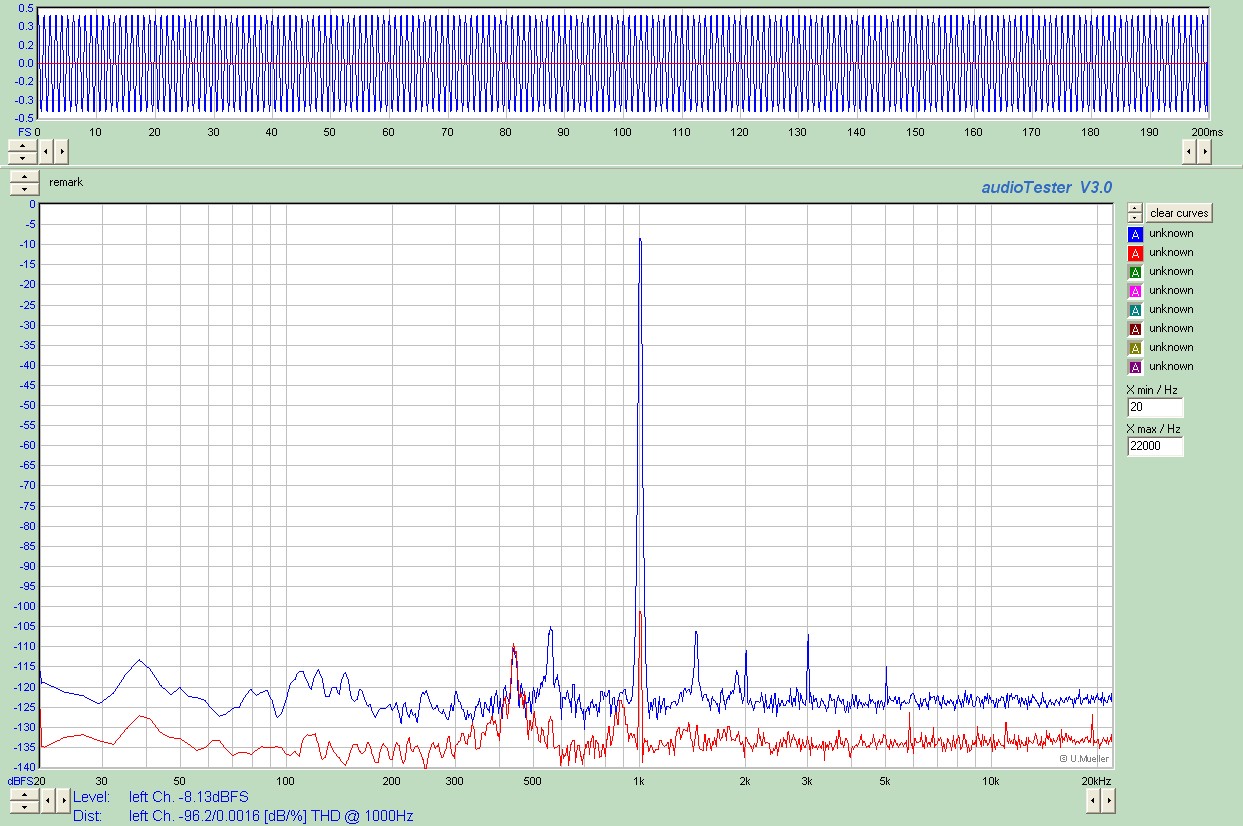

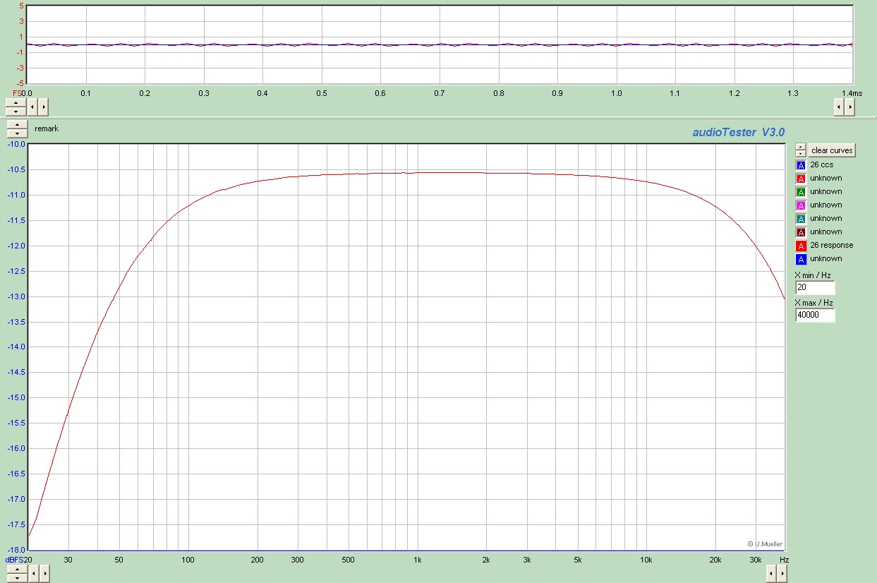

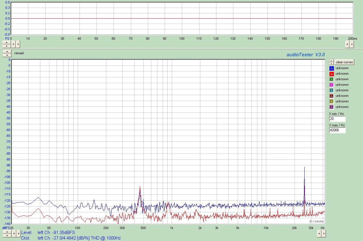

Managed to change my old laptop for a proper PC: i5 @ 3.3GHz and 8GB RAM. Although WinXP only supports 3GB, it's really slick with the bare minimum installed to ensure Audiotester runs properly. Also got an Audiophile 2496 used from e-bay which works fine.
Attached are a couple of tests: loopback, internal test signal of 1kHz and the frequency response of a 26 DHT stage loaded with a CCS in a breadboard.
Oscillator distortion of 0.0016% is fantastic for what I need!
I found some interesting artefacts at 450Hz and 25KHz which may be the noise from the power supply as the PCI board is close to it perhaps. Tried disconnecting everything else in my workbench but they don't dissapear. Nevertheless, they are below 90dB so it's great anyway.
Ale
Ale
25kHz is video.
25kHz is video.
So could well be the monitor output signal inducing as cables are close...

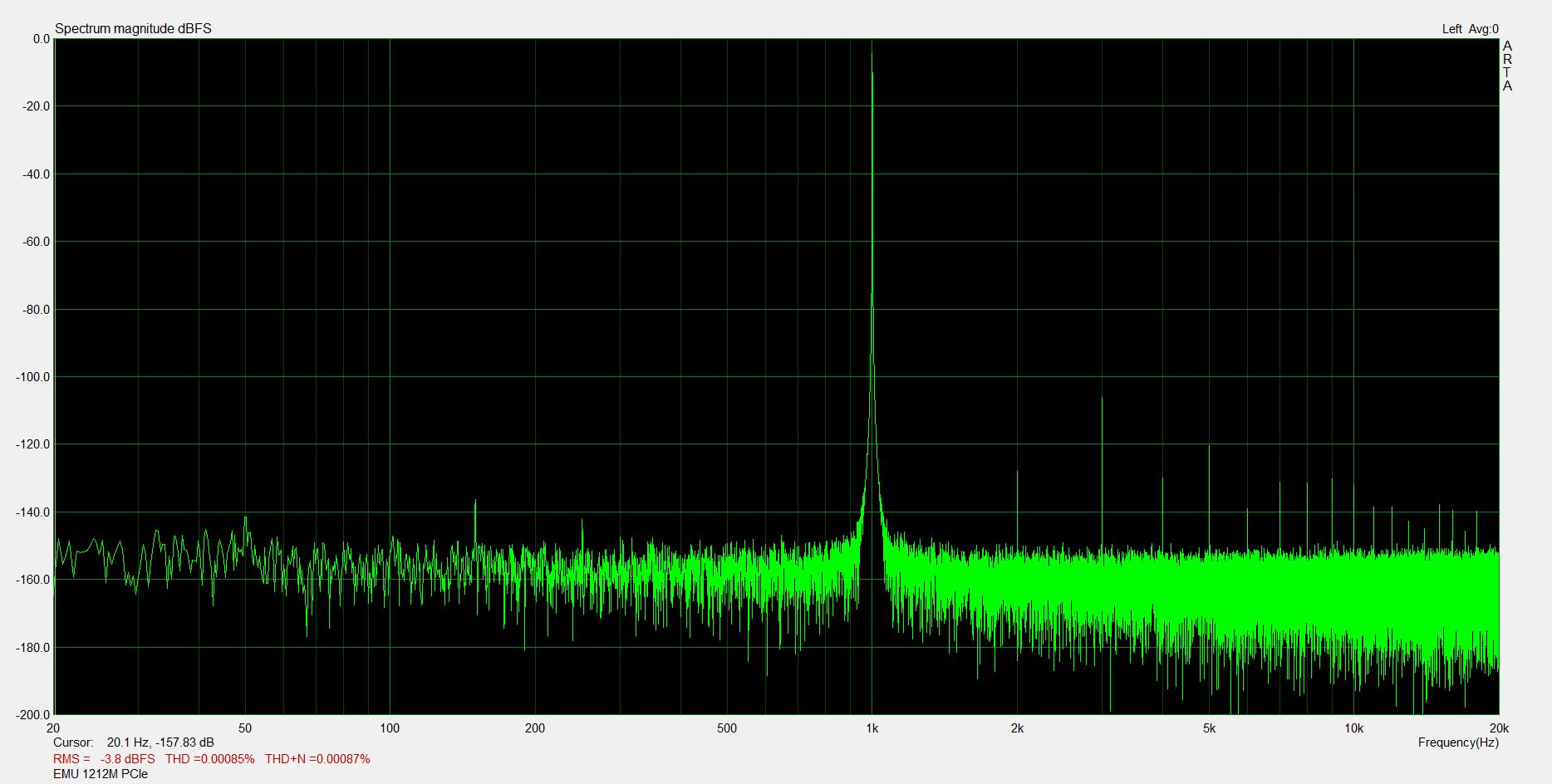

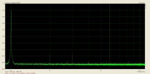

I bought the EMU 1212 pcie and have excellent results with it (still running Win 7 pro 32 bit )... Only remark so far is the sound card control panel is a bit hard to figure out (you really have to read the manual..)

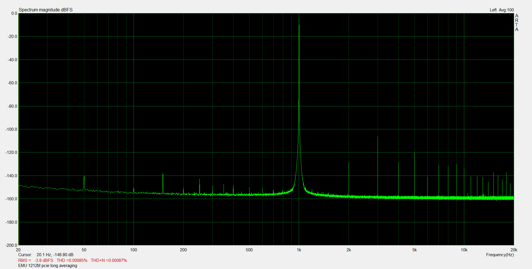

Wondering if you saved any of the old graphics for comparison?
The EMU 1212 "long averaging" graph looks awesome ... switching power supply noise from the PC looks to be totally under control 😀
Did you do any tricky stuff that we should know about?
Hello FastEddy,
No tricks are involved, this card is used as delivered from EMU. Loopback measurement is done with balanced interconnects (standard cable of 3euro a piece, nothing special). PC used is a Vostro 460 from dell (completely original), no changes to the power supply.

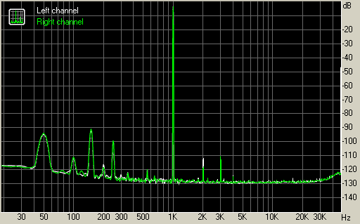

I do not have a compete ARTA chart for the Echo Firewire 2 card (only one from 1 to 20Khz, and level is 12db lower), but I did find one taken with the RMAA software.
The echo card performed also fantastically, the only reason I changed was because of the glitches I got with it when I switched to Windows 7.
