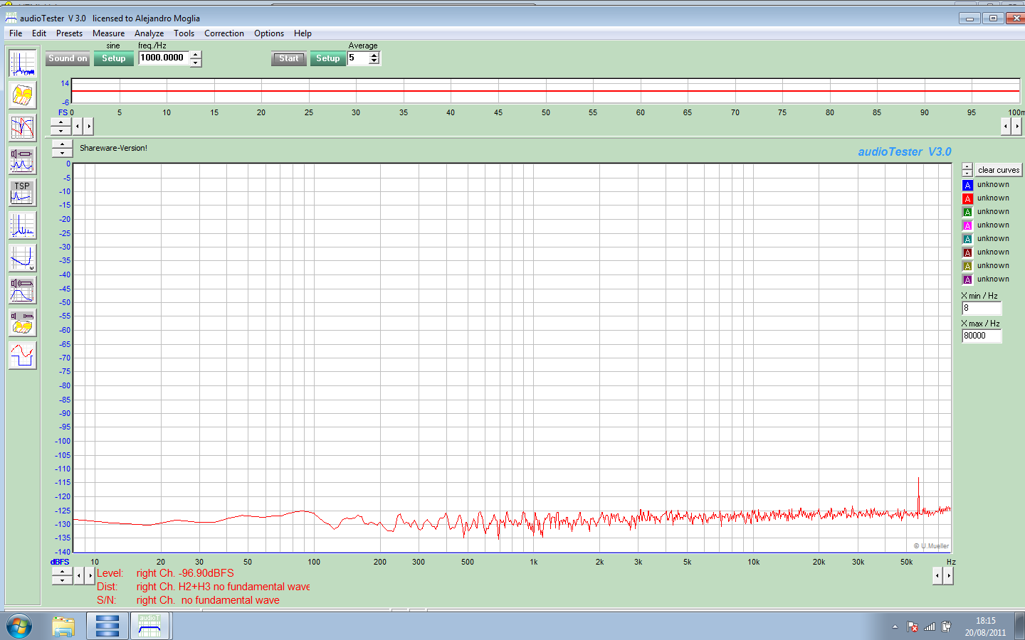

See attached the noise floor of the EMU connected to the interface board. I have shielded the case with aluminium foil and also the switch.
The attached plot is running at 192Khz and 24 bit. You can see that the floor is at around -125dB. Can't see any hum peaks.

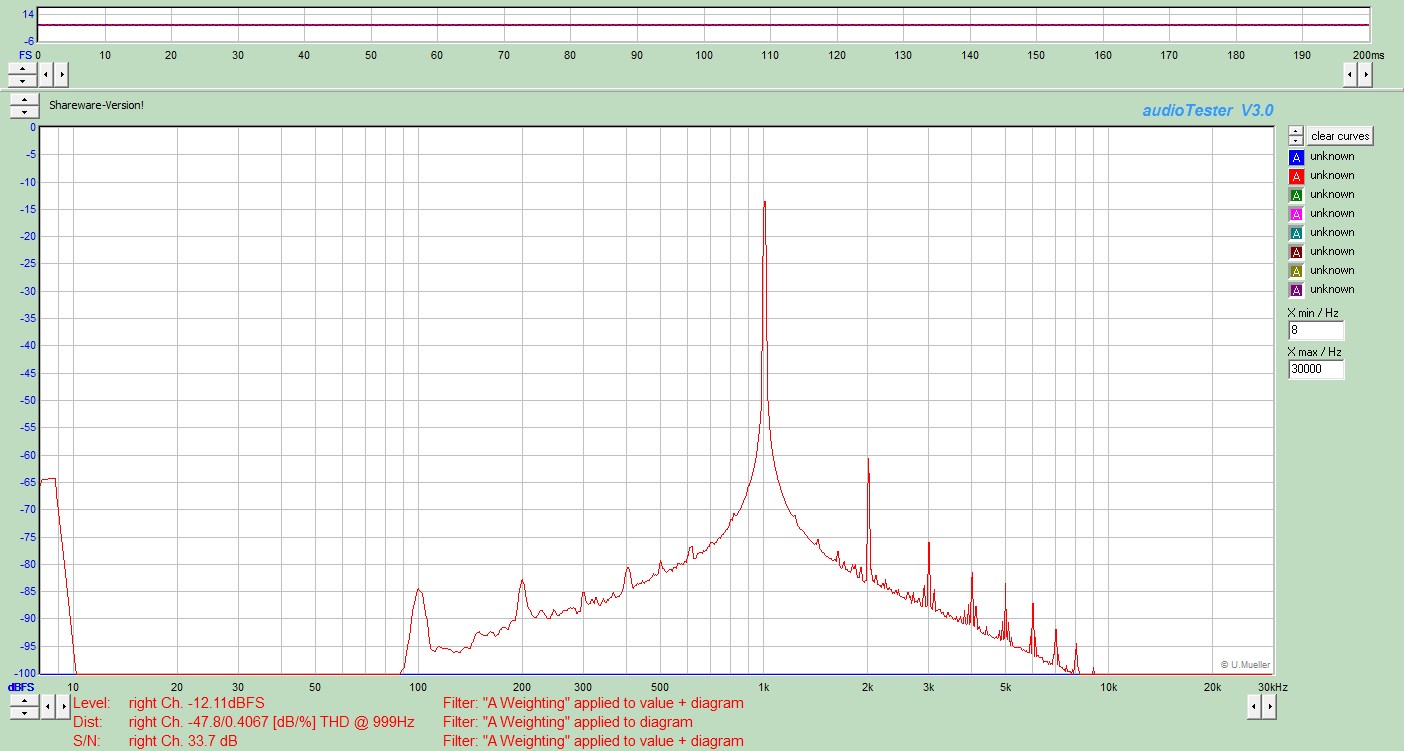

Also attached is a distortion measurement of a Sylvania 6SL7GT (two triode sections paralleled) running with bias led (-1.7V) and CCS load at 6mA.
My external generator has a distortion of about 0.17%. How do you read the distortion generated from the 6SL7? Do you subtract the 0.17% to the 0.40%?

I would first run the system measuring itself then subtract, but 0.17% for the source seems poor in comparison with the M-audio or Juli@.
What spec PC do you have? I sometimes get erratic FFT's and poor performance, it corrects itself if I stop and restart the measurement. I do wonder if my PC isn't quite up to the job - tho I'm no expert on what exactly the bottleneck is.
I work on the principle that, for valves at least, the sound card's contribution at 0.0006%-0.0007% is negligible, again happy to be corrected tho.

Andrew,
Perhaps I wasn't clear. The 0.17% is from my external analogue oscillator as I can't make the EMU output to work on the Audiotester software. I suspect is the windows 7 configuration. Will need to fix this.
So I need to subtract then?
Ale
As I understand it, yes subtract, but I would look to sorting the PC setpup.
Its late but if my math is correct 0.17% is only ~ -55db, a decent set up with Pete's box and the noise floor you are showing should be good for a few db below -100db.

Yes I know. But I was keen to get a view of the 6SL7 driver distortion. 0.23% at full scale is not bad, isn't it? Stage gain is nearly 60!

Your spectrum looks like your computer is having a problem with other processes causing glitches.
Why? Is that because of the artefact at HF? It's a laptop core duo 1.5GHz with 2Gb. Not sure if is the laptop or the Win7 or the bloody EMu!
ale
I think SY is alluding to the same problem as I suggested, i.e that the laptop may not be powerful enough or is busy, can you confirm SY?
Yes. The giveaway is the mountain on which the fundamental spike sits. The baseline should be much flatter.

Thanks for the feedback. Indeed, I'm having issues with the soundcard and the laptop! I need to get rid of both :-(
Tried today the full setup with the laptop internal soundcard and worked despite the noise level now being around 80dB.
The bin energy spill didn't appear as SY mentioned - good to know that that could be caused by the glitches due to performance issues. I thought that it was the noise floor of my external generator as I never managed to play around with the FFT windows...
Anyway, now I have a great soundcard adapter but no proper PC/soundcard. Back to square zero!
