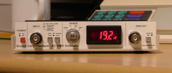

OK gents, not the sharpest picture I ever took but you get the idea.
I opted for the backlit version of the display. The interface is USB powered without any problem. Still have to zero it out and stuff.

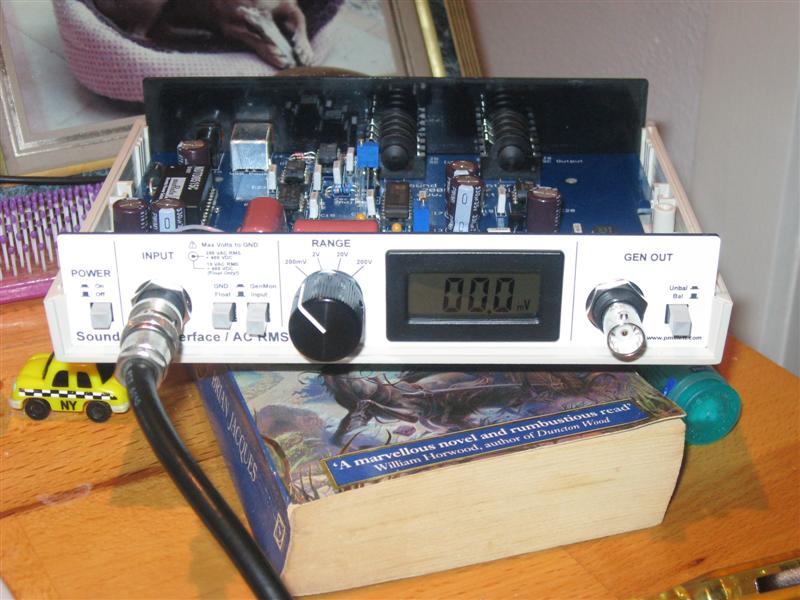

Mine is all finished now.
When trying to zero the DC offset I can't get any lower than 1,2mV with R25 turned fully CW.
Is this OK or do I have to check something?
Walter
One of the two units I built also will only zero to 1.2mV - the other to 0.2mV. As far as I could tell the meter circuit is picking up some noise (above audio frequency) from the DC/DC converter, and is not real DC offset.
This doesn't seem to affect anything I've used it for, so I never bothered to track it down. So I would say it's OK.
Pete
I put the input switch to ground (as in not floating) plugged in an old BNC and then shorted the other ends of the cable with a test clip, it settled about 0.3mV so I tweaked R25 and got it to 0.0mV, I must be lucky, I guess.
It ran fine off a USB, its an older MB tho'....
Anyone got any ideas, did I just get lucky? I'm just happy it seemed to work, or perhaps it isn't.......
I need to go back over the circuit and see.....
I did get my four year to old match all the resistors on a decent DMM, perhaps that's what did it..hah, well he had a wail of a time 😉 so much so, in fact, I'm thinking of getting some of those educational kits for us to build together...
My next step is to order up a ESI Juli@, when that arrives I'll report back like the other guys have with some graphs.
I reckon I'll end up shielding the box.
I used the THAT Corp receiver and driver chips and the LME op amp, everything else is stock apart from the input caps which are as mentioned in a previous post.

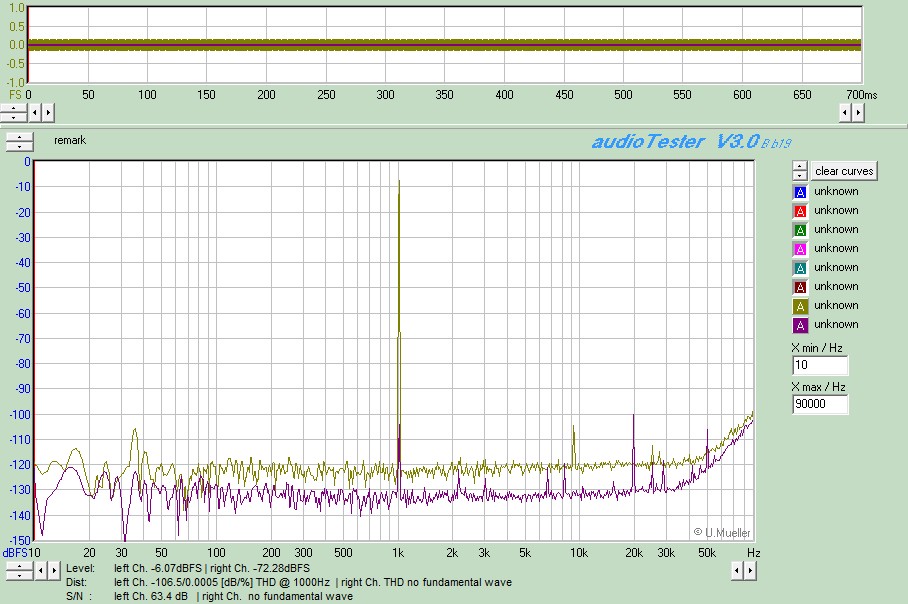

Well it goes 🙂
I ended up shielding the upper and lower case with copper tape and placing a grounding lug on the back panel just to the left side of the TRS jacks. I then connected both upper and lower shields and shaft of SW4 to the ground lug.
With this separately grounded to earth I get very reasonable results and no sign of 50Hz 🙂
TDH = 0.0005%
Not quite as good as some others, but not bad, that at 20hz to 90kHz with the resolution set to just below 1Hz.
There's some artifacts creeping in at 30-ish Hz and then closer to 15 and 20kHz. I intended trying again to see if these were in the environment or my s/w configuration.
Thanks Pete a very enjoyable project and I am looking forward to putting it to use.
Andrew
