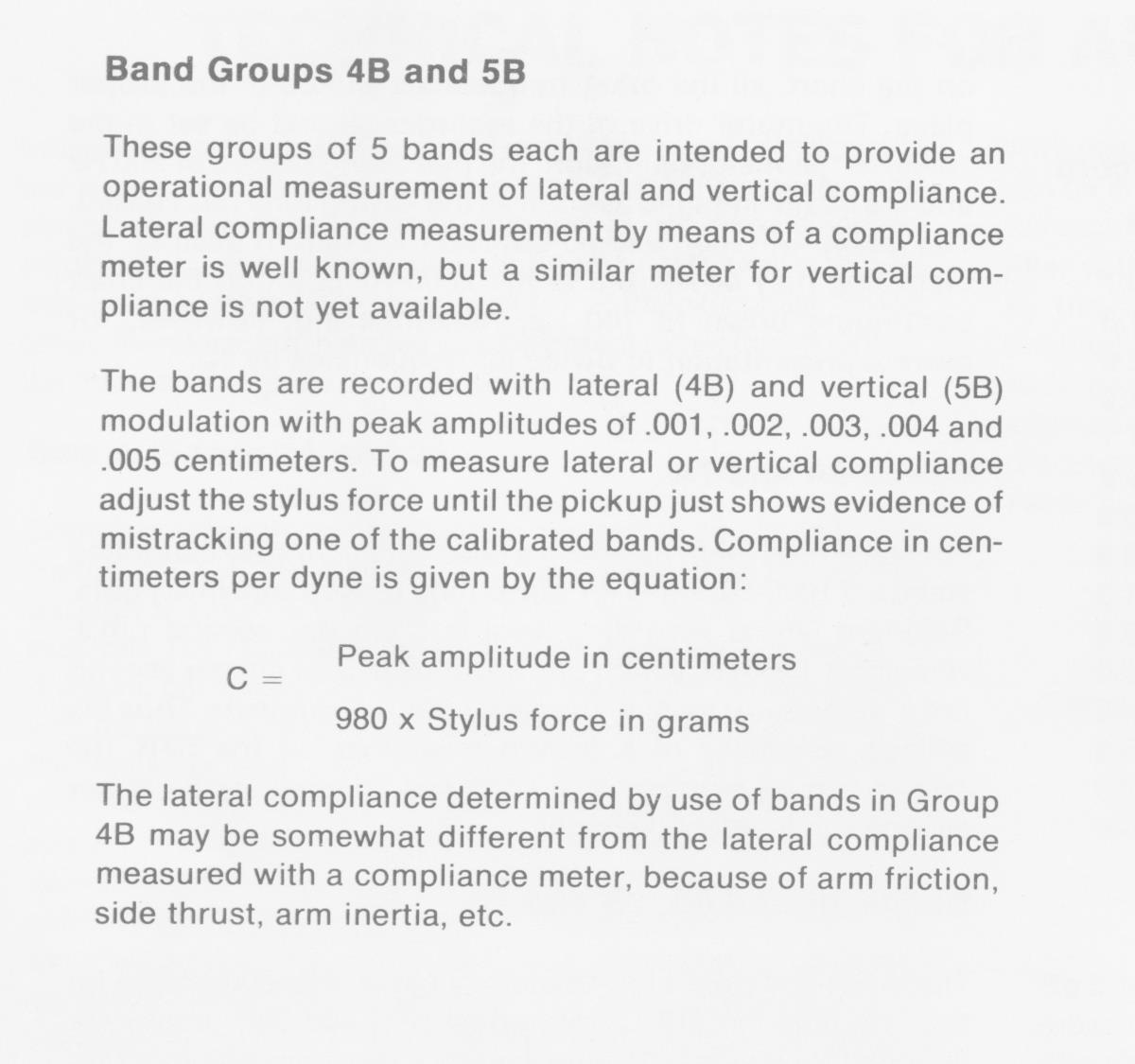

Thanks. Two questions
1. Looking at the spec sheet for a technics MM I noted that it states that the 100Hz compliance is measured using STR-100. Is there anything in the notes that suggests how this was done?
2. In trying to find a copy of the notes on line in a legible format I came across mention of a wear test track. Any description of that that actually is.
Bill
Here is what it says about compliance.
Thank you.
