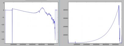

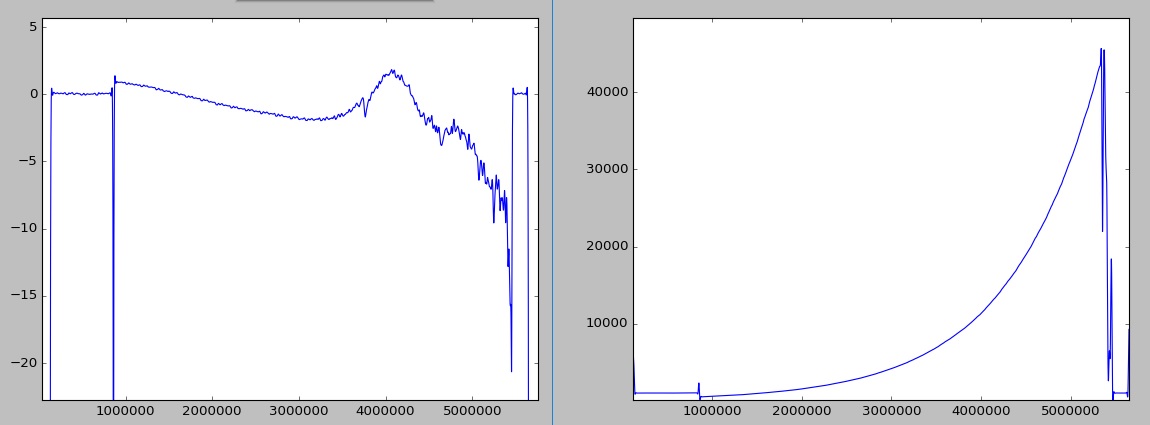

Here is a first attempt at analyzing a frequency sweep track using the Hibert transform to display instantaneous amplitude and frequency to see if this can be useful.
This is the first track on the CBS STR120 recorded at 24/96 and reduced to 16bit recorded with an external flat mic preamp and FET buffer (so the cart saw standard loading). The track is constant velocity from 500 to 50k log sweep at 24sec per decade (48sec) and has a 1k reference tone before and after. On the left is amplitude (some of the big glitches are on the LP via bubbles or warps). The data could only go to 48K (I have no 192k sound card) but there is some aliasing/rolloff above 46k so the last few kHz are noisey/garbage. On the right is frequency. These are both smoothed 96000*60 (one minute time record) transforms. The processing time is essentially invisible.
The axes are dB re:1kHz and Hz with the horizontal in samples 0:5,760,000 on both. Very little manipulation and one could plot this as magnitude vs frequency.

Very nice! The freq response curve would be easier to read if you could translate time into frequency; a grid would also make it easier on the eyes.
What do you think is causing the bump from ~7.5kHz to 15kHz? Have you tried different loading in an attempt to equalize the response?
This is just a first look (fairly raw), I plan to have a nice dB/logfreq plot with grids. One problem is that these old LP's were generated with instruments that used motors and gears and the stated correspondence of frequency to time is not exact. So I think I can actually correct that and even correct for the TT speed (but that's probably overdoing it).
This is a Grado MI so it is not that loading sensitive, the bump also appears when recording with a normal RIAA setup. If anyone has the ability to post sweeps from other setups I could play with them.
