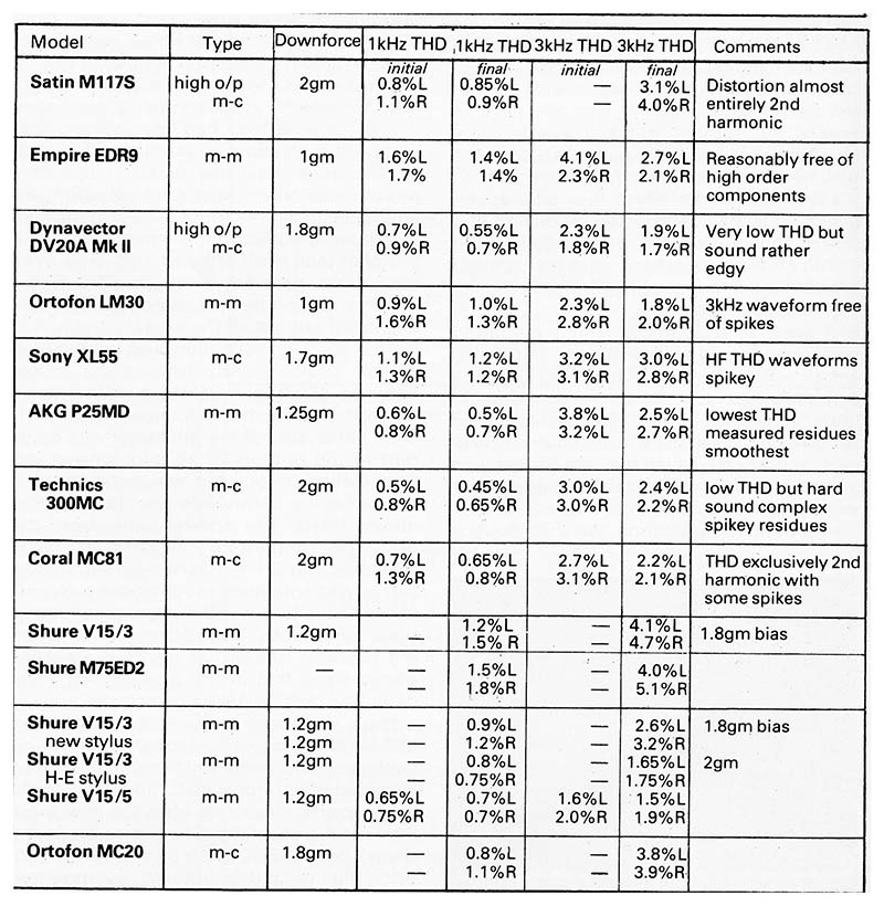

Was clearing out some old clippings from "HiFi News and Record Review" -- JLH described a pickup distortion meter for adjusting cartridges (October 1982). With respect to the HFS 69 test record he mentions that the 1kHz and 3kHz recordings were "1/4 and 2/3's of the way across the disc, which allows a good assessment of the final tracking alignment."
What he found was that measuring the THD over a span of time allowed him to judge the deterioraton in performance owing to "wear". He also mentions that his MC-20 showed dramatic improvement as "the major axis of its stylus ellipse was set incorrectly".

Jack: Thanks for posting that. Interesting, the AKG looks like an ortofon OEM. Not seen one of those before, but does tally with the measurements George did to show distortion going down over time.
