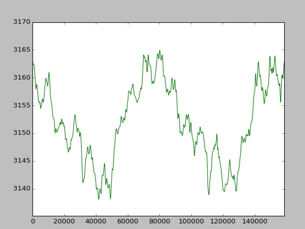

Here's a plot almost perfect 3152Hz mean but +- 0.4% off center.
Run out has only a job number and SST stamped in it (other than Adjust + A or B).
EDIT - Thanks for that link. A quick look shows that the mean is used and the warp and eccentricity are assumed to be there. The good Dr. is quite OCD about the azimuth set up.

I'm trying to understand something here so please forgive me if I am asking Socrates for lessons on the alphabet. How do you know the variation in speed is not the table? or at least what percentage of it could be.
Other LP's are fine and I don't see how the TT could produce .555 Hz easily unless it was out of round by 0.4% which is highly unlikely. You could also rotate the LP relative to the platter and figure it out.
OK thanks, I'm asking after yesterday powering the motor on my TT with an oscillator and being really surprised at how much steadier the speed is (as well as other changes in sound I find surprising).
Eccentricity is an irrelevance - LP is produced as well as can be.
