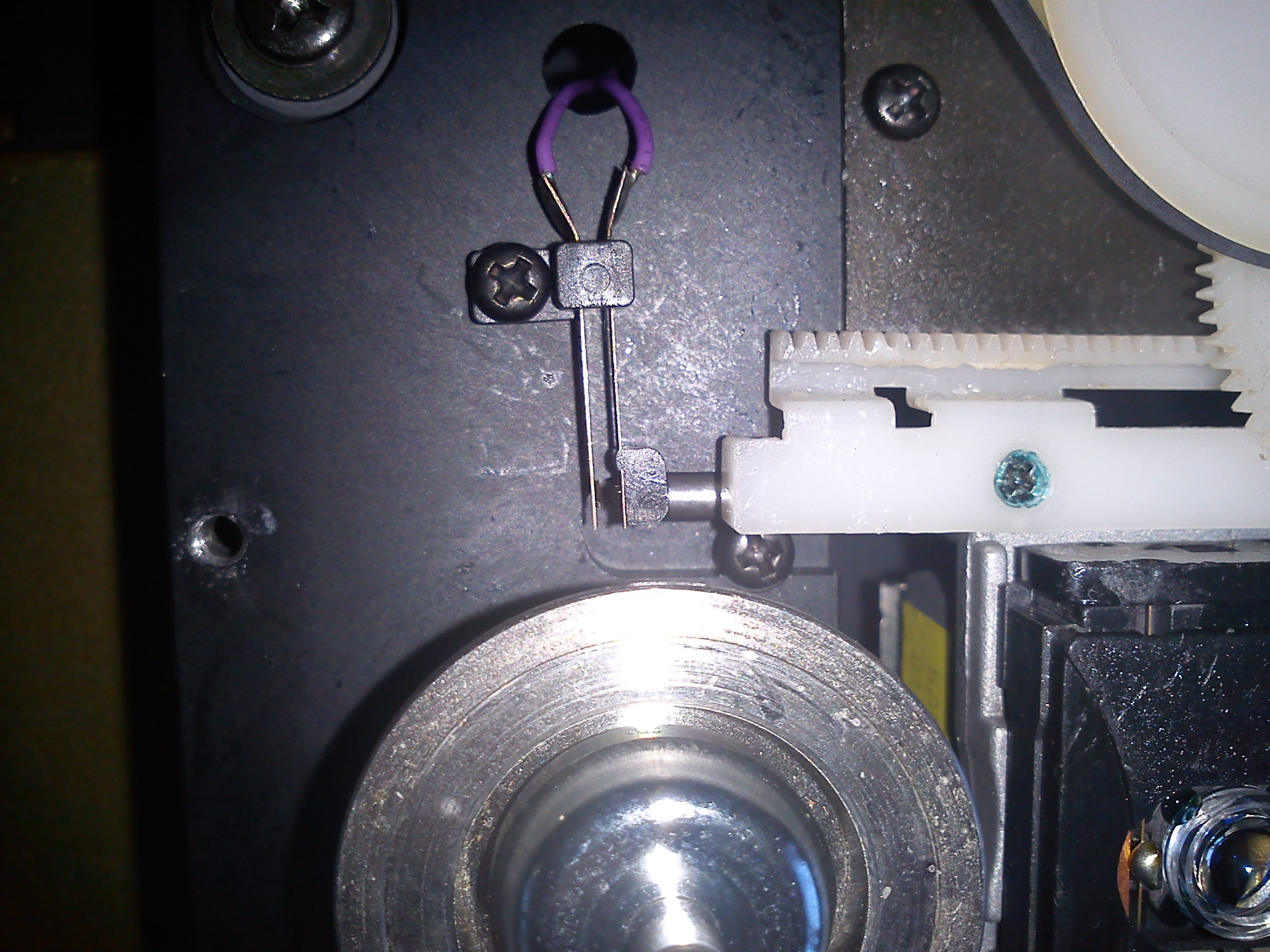

Sled position at disc start is difficult because there is nothing to measure physically. Make sure any microswitches are undamaged and the "leaves" straight and not bent.
I think it's OK see pic

The microswitch looks OK. It probably has a plastic spiggot to locate it. You can always come back to this area but concentrate on getting it to play a disc through perfectly first.

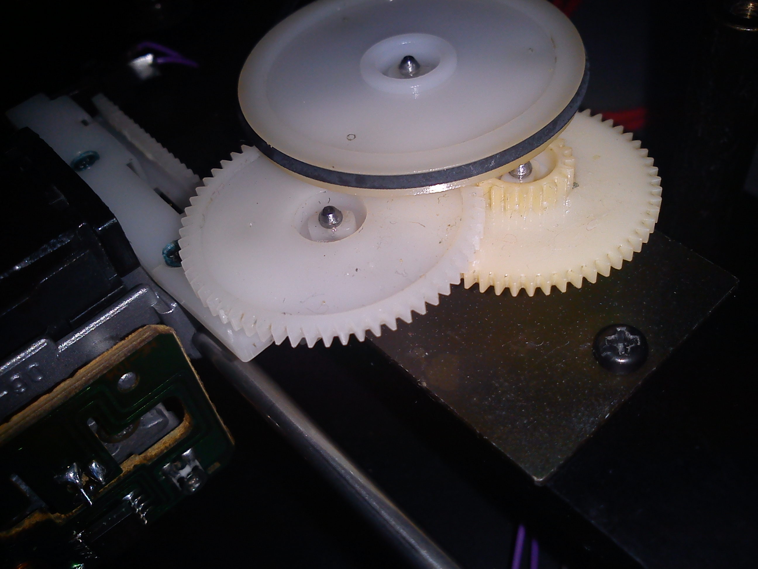

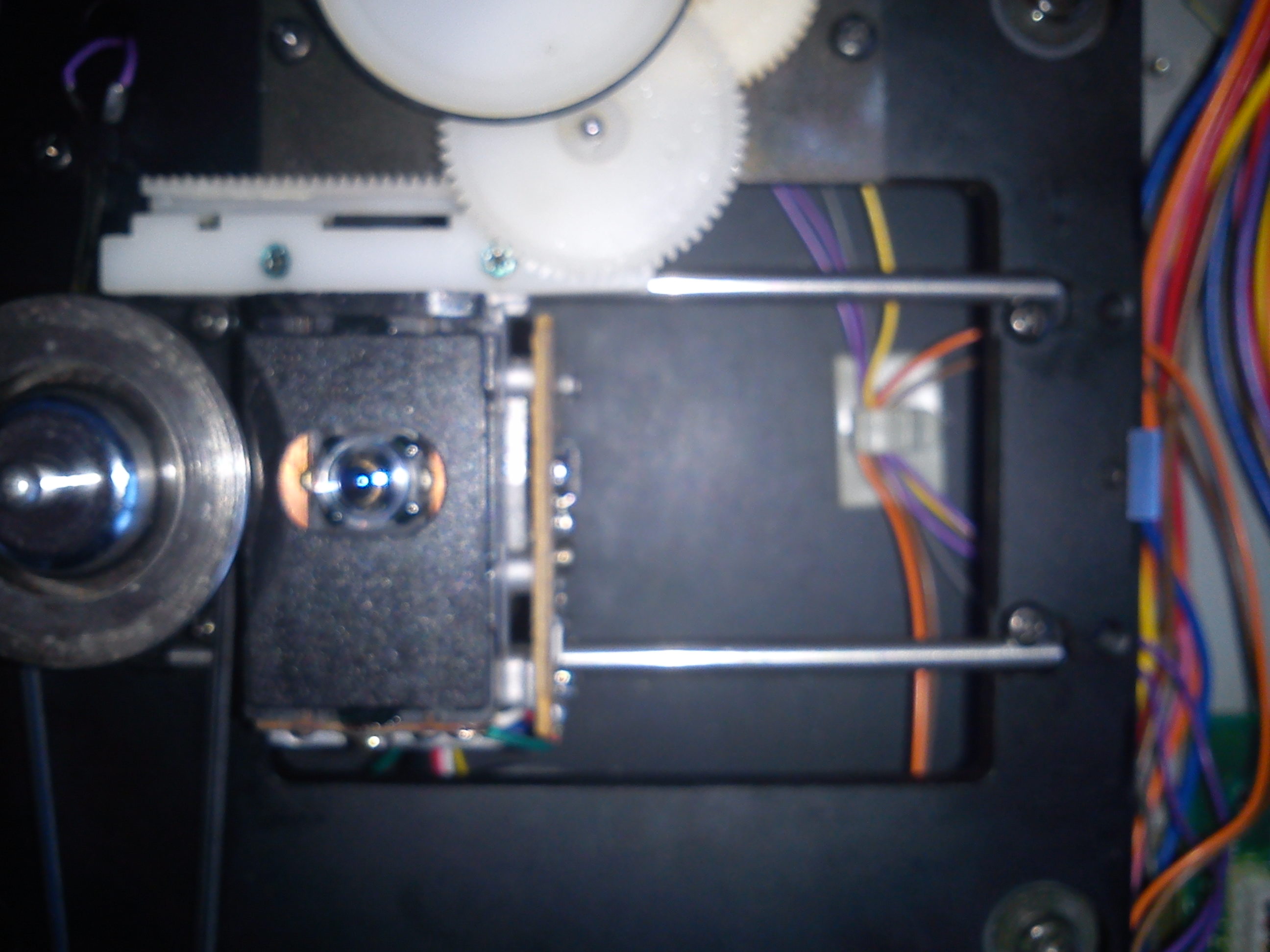

If there is old grease (hardened or dirty) on the sled or gears then I would always strip down and a clean and relubricate.
You won't have this but I always use a special plastics grease that is for plastic/metal surfaces in any combination.
Its the sled motor (the motor that drives the gears) that you measure the voltage across. I would solder two wires so that you can connect the DVM up and then sit back and watch as it plays through a disc.

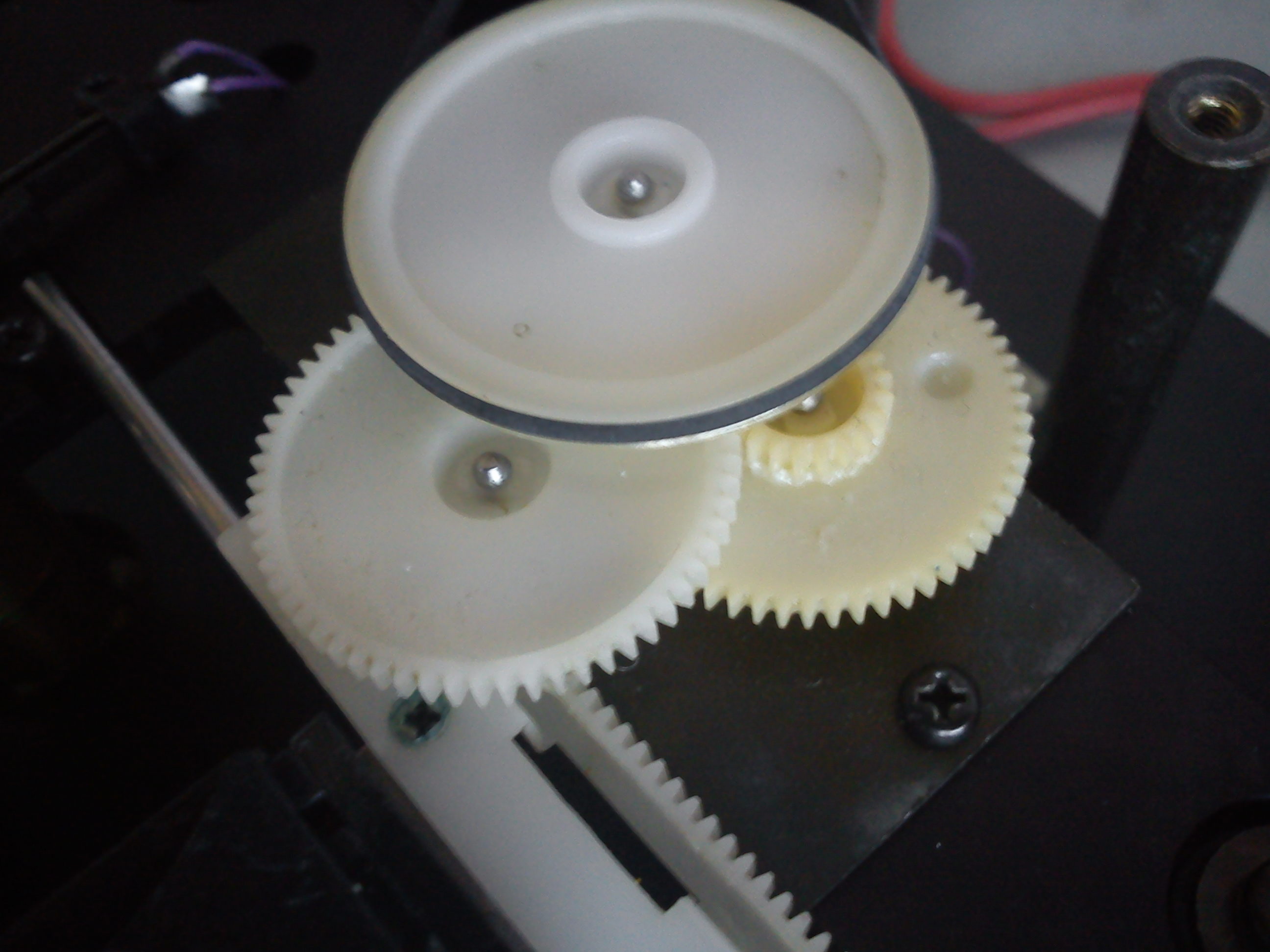

How do you say "spiggot"?
I don't see any old grease on the sled or gears see pics.
I have silicon based oil, can I use it?
Laser pickup is new max. have surely 200 or 300 hours.

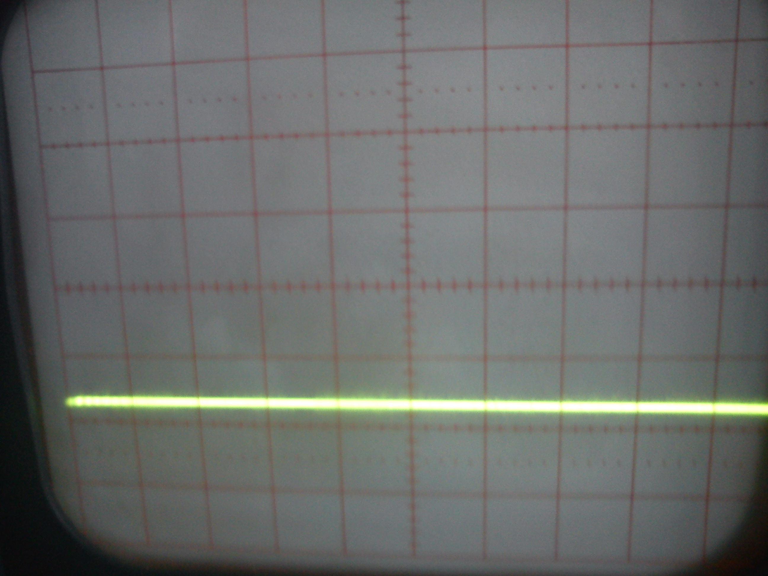

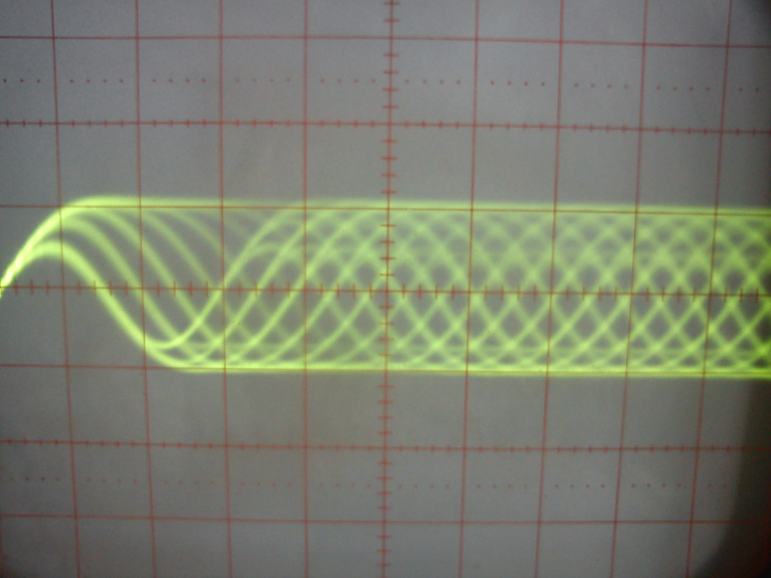

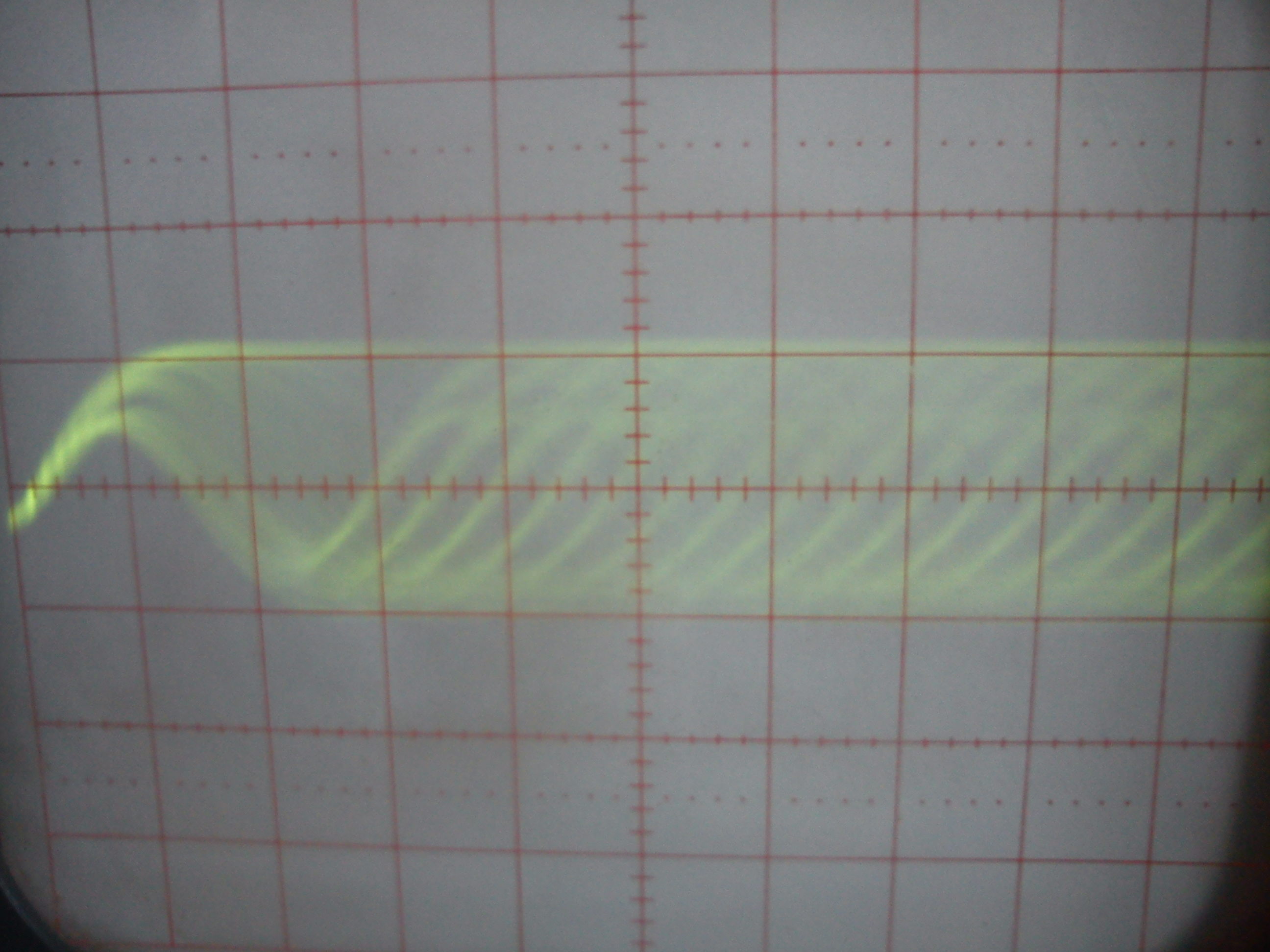

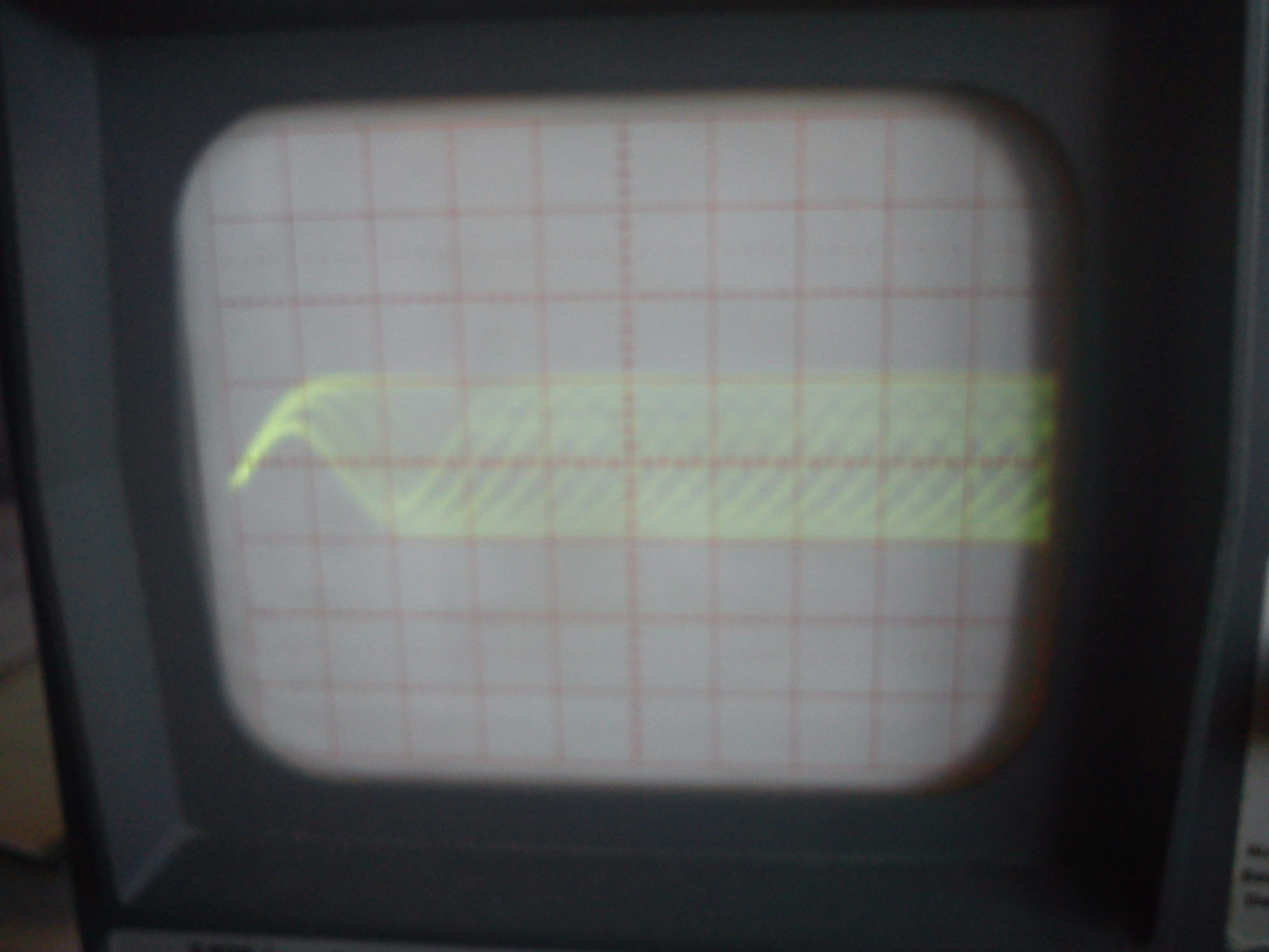

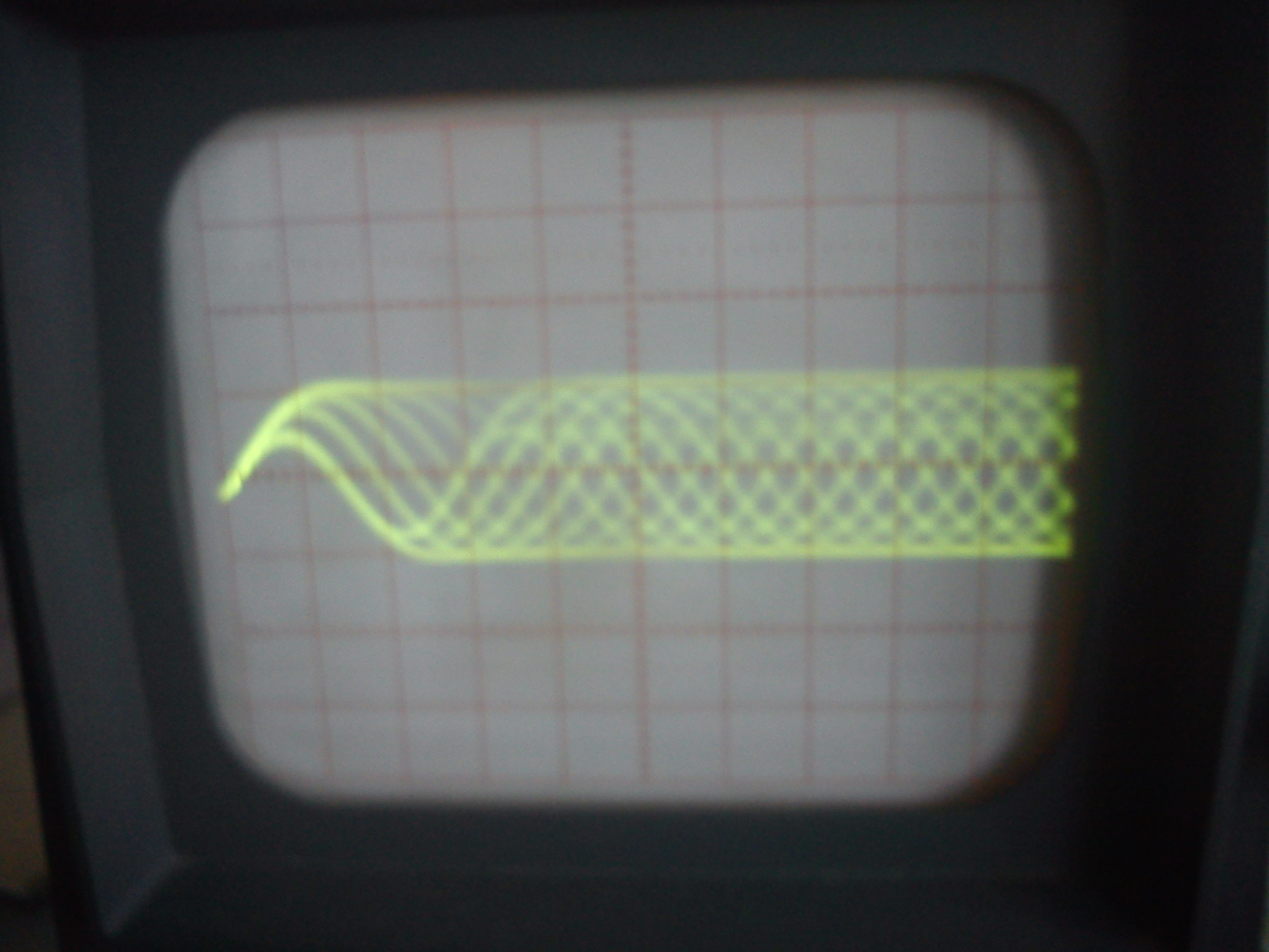

Changing setting in pot p104 don't change nothing in the eye pattern.
Changing setting in pot p107 don't change nothing in the eye pattern.
Changing setting in pot p105 change the eye pattern to an straight line in the scope but can adjust for a better one eye pattern.
Changing setting in pot p101 can change the eye pattern attached two pics one with adjust for best eye pattern that I left, other pic shows a straight line with wrong setting doing the player finish to play and CD transport display showo 0 track , 0 min and 0 sec that's with setting in a max direction, the other pic shows setting max in the opposite direction (not focused eye pattern).
So next step really is to monitor the DC voltage across the sled motor as I mentioned before. That's a really good guide as to whether there is a mechanical problem.
This can be fix also the TOC issue?
It is all part of gathering all the information that hopefully leads to finding the problem.
It may or may not be related to the TOC issue.
