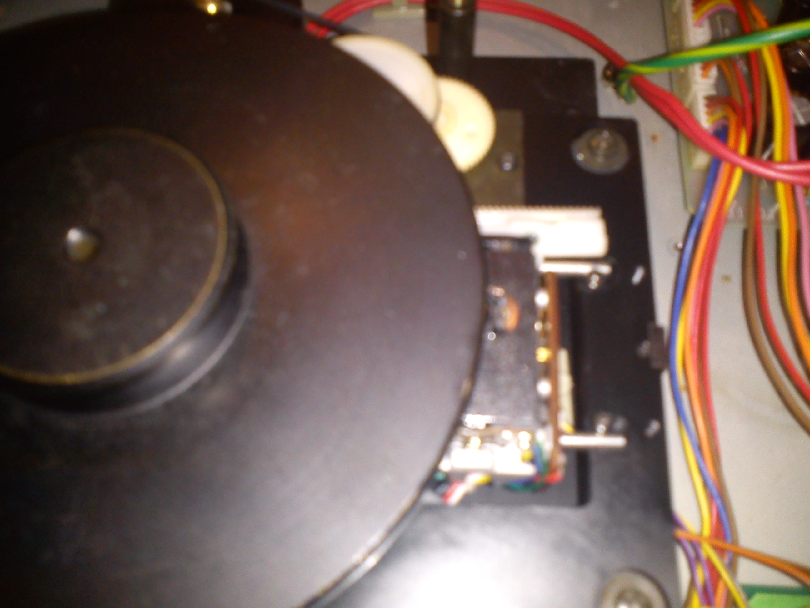

So next step really is to monitor the DC voltage across the sled motor as I mentioned before. That's a really good guide as to whether there is a mechanical problem.
DC voltage across the sled motor is 0.018V, motor don't tour.
Not really following you
The spindle motor (the platter) will only turn after the laser has found focus. In post #182 it was playing music so spindle motor must have been running. The sled motor drives the pickup assembly and should turn slowly when playing or rapidly when jumping tracks.

Measured 0.018VDC, have I to measure AC?
It sounds like something has happened to the player...
The sequence of events is,
1. Make sure the sled is in the rest position near the centre of the disc. If you move the sled manually away from the centre and open and close the tray or power off and on then the sled should always return to the rest position.
2. The lens should perform the focus search routine moving up and down 3 or 4 times.
The spindle motor nevers spins until focus is found on a disc. If there is no disc the motor doesn't spin. If the laser is faulty or it can not focus for whatever reason then again the motor does not spin.
When the motor does run the voltage will be DC (assuming a normal type motor and not a hall effect type) and the voltage probably only a few hundred millivolts.

1. When I move the sled away from the center always the sled always return to the rest position.
2. The laser don't moves 3 or 4 times & I don't see the red light reflected in my hand.
As per your advice I have to look for in the chip that makes the focus?

They seem OK.
Next checks would be to jump in and check on a scope to see if the servo IC (assuming you can get at this point) is outputing a focus search "ramp" waveform and to see if that reaches the drive IC. Don't overlook possibility of connection problems to the pickup such as a damaged foil etc.
If that shows nothing then I would look at all the pins on the system control IC with a scope and make sure all are as expected. Make sure any inputs from mechanical switches are reaching the IC.
