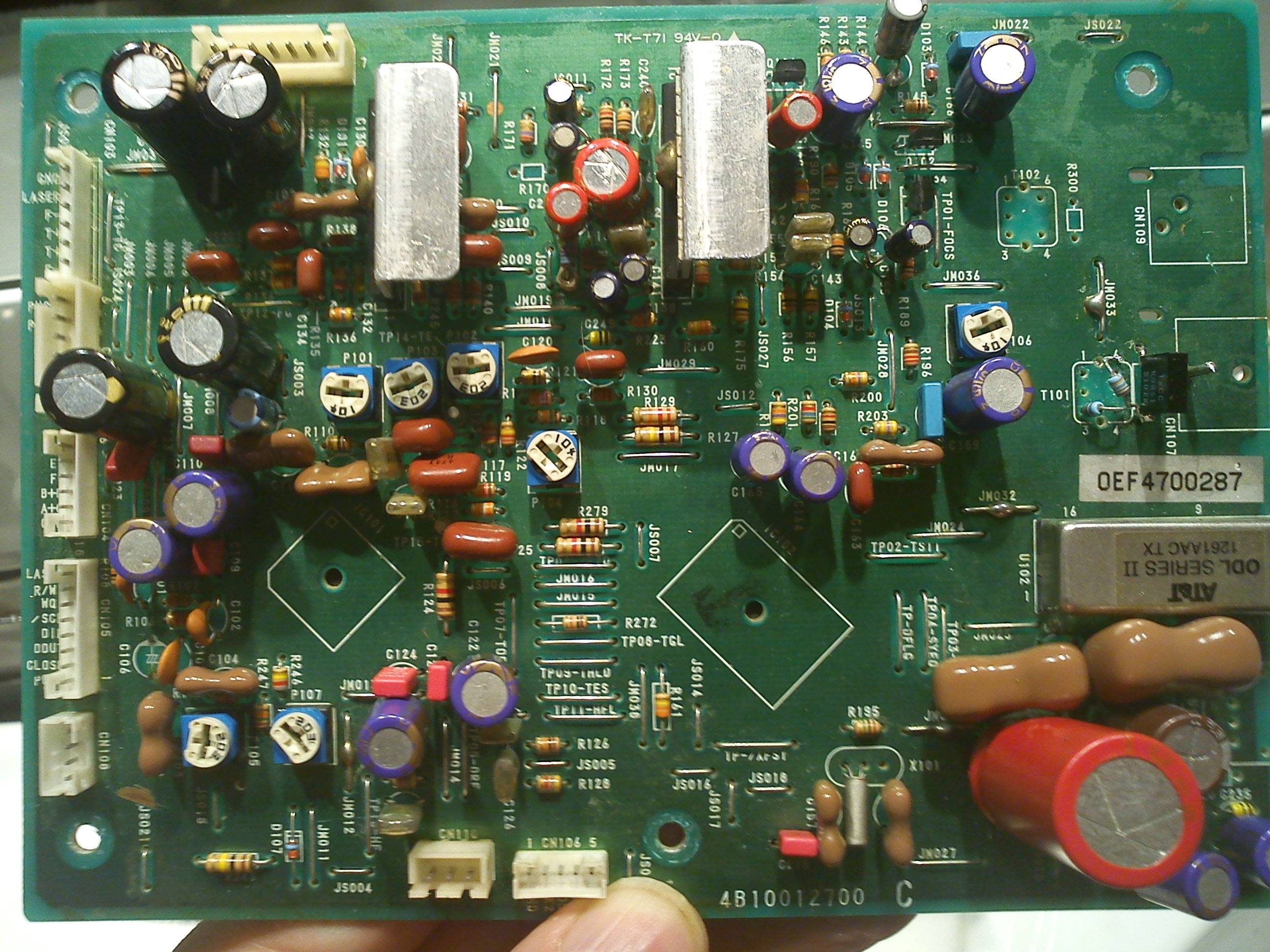

Where have I to look for the preset (have I to look for a trimmer)? wich pin has to be connected? I'm sorry Mooly I'm really lost.
Lets take a step back and look at the info we have.

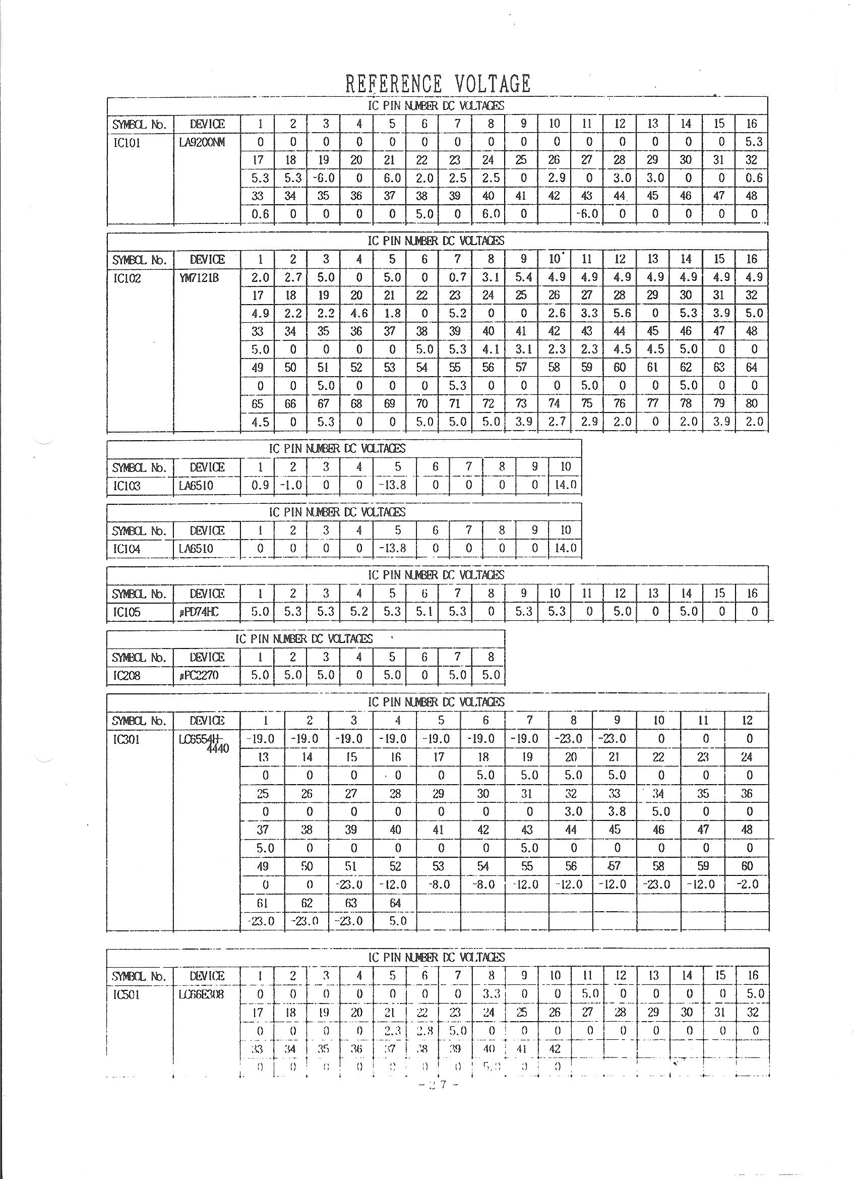

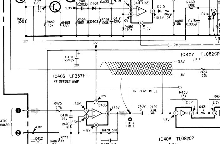

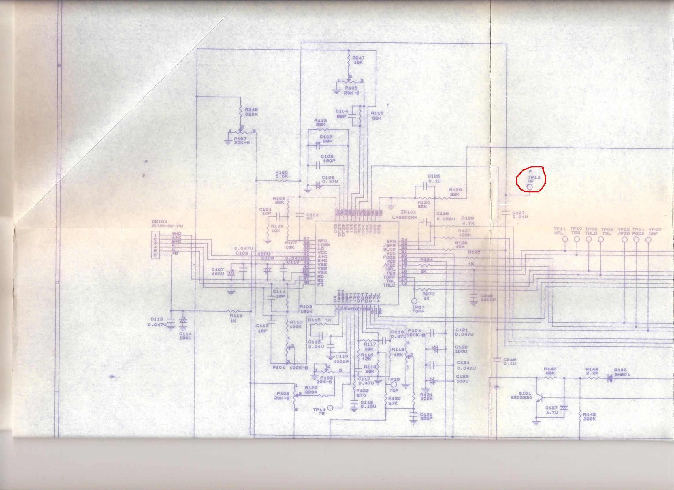

Firstly I don't know how the data sheet values for Vh and Vl are to be interpreted. So we still don't know for sure what the typical RF level is. The picture attached shows how most service manuals show the level. And these amplitudes are common across many makes and models but maybe this one is an exception.
The correct level is of utmost importance. Going lower will not damage anything, going higher could over drive the laser.
The preset pot is normally on the pickup itself although a few players have it on the main PCB.
Do you have any service info on the player.

This is really hard without having the player to see and work on and I don't want to give you misleading or wrong info 🙂
Maybe a close up clear picture of the component side of the PCB might help identifying adjustments. If there is no laser power preset on the pickup then it will be on the main PCB... probably... unless it's a fixed factory setting or adjusted via software (unlikely).
If there is a Focus Bias preset then you can see if adjusting that makes the RF any clearer or larger in amplitude.

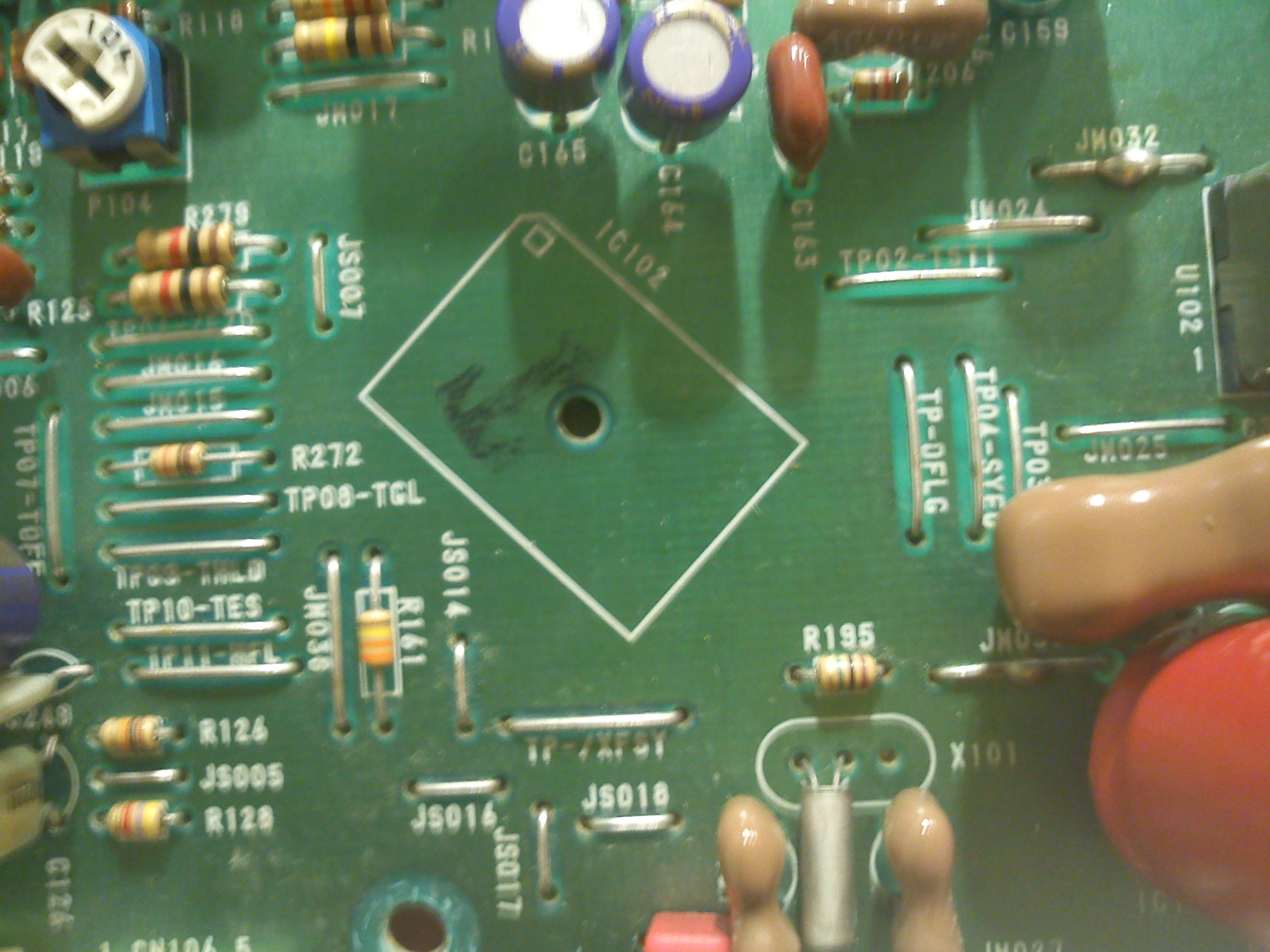

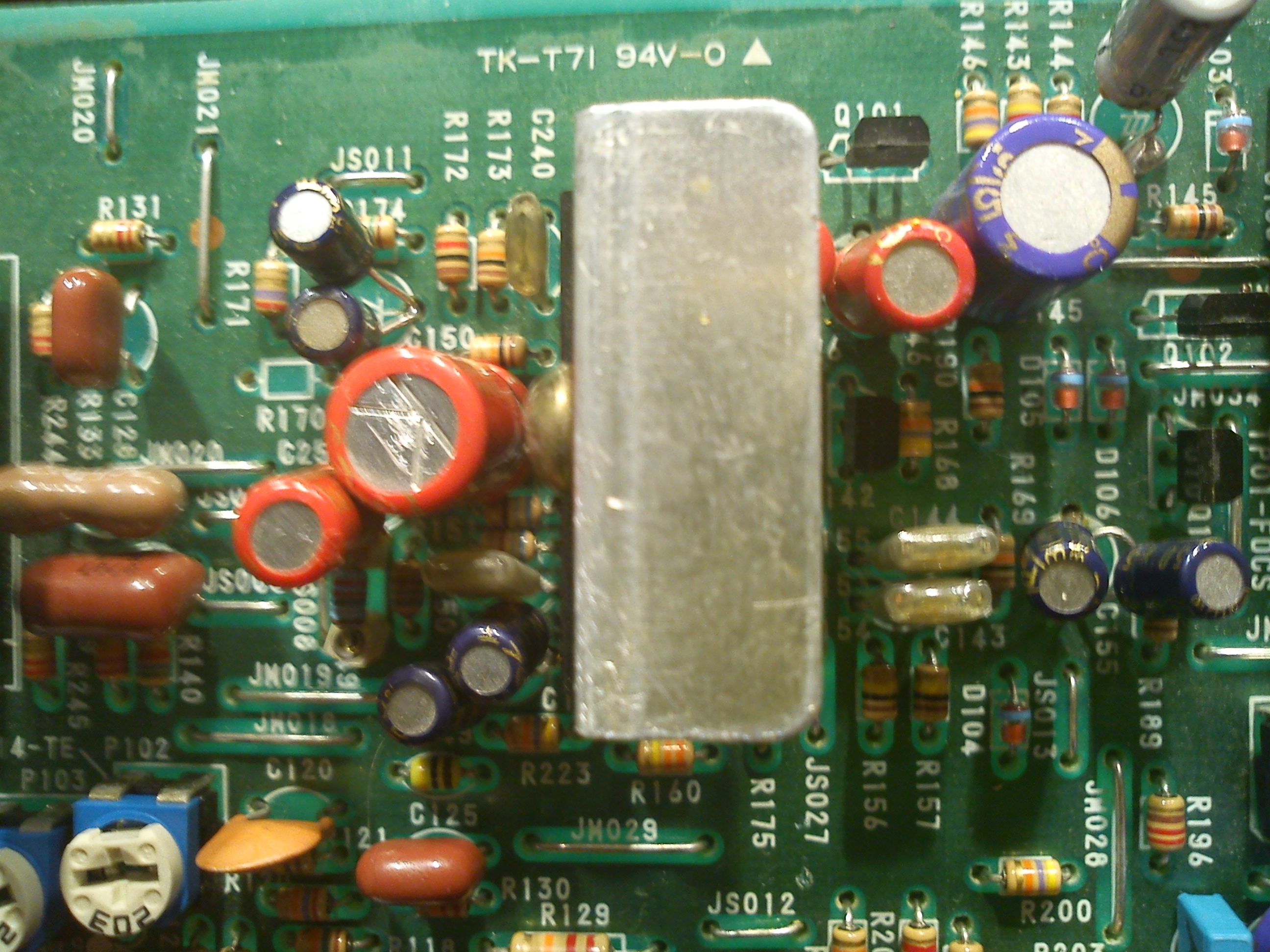

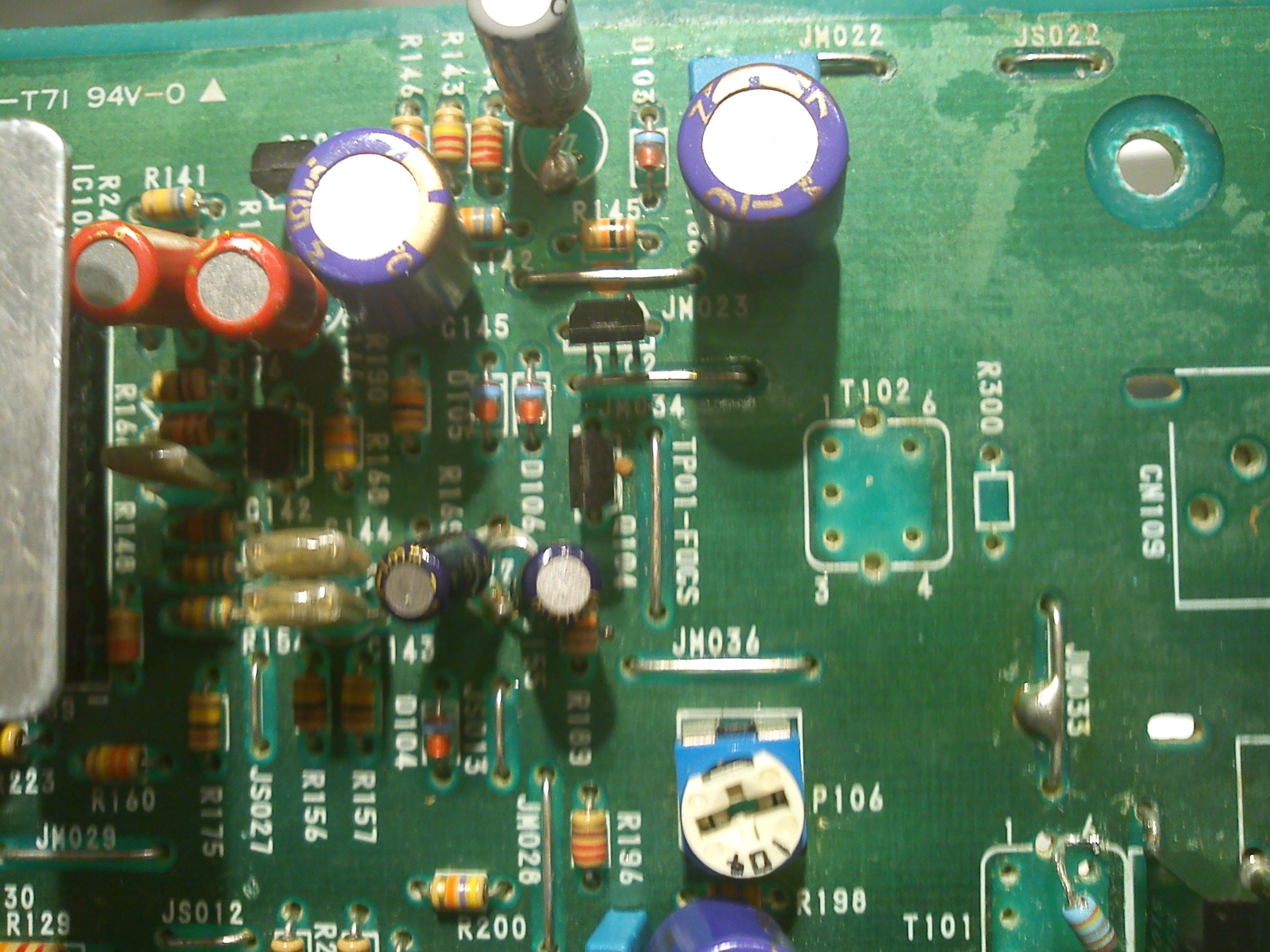

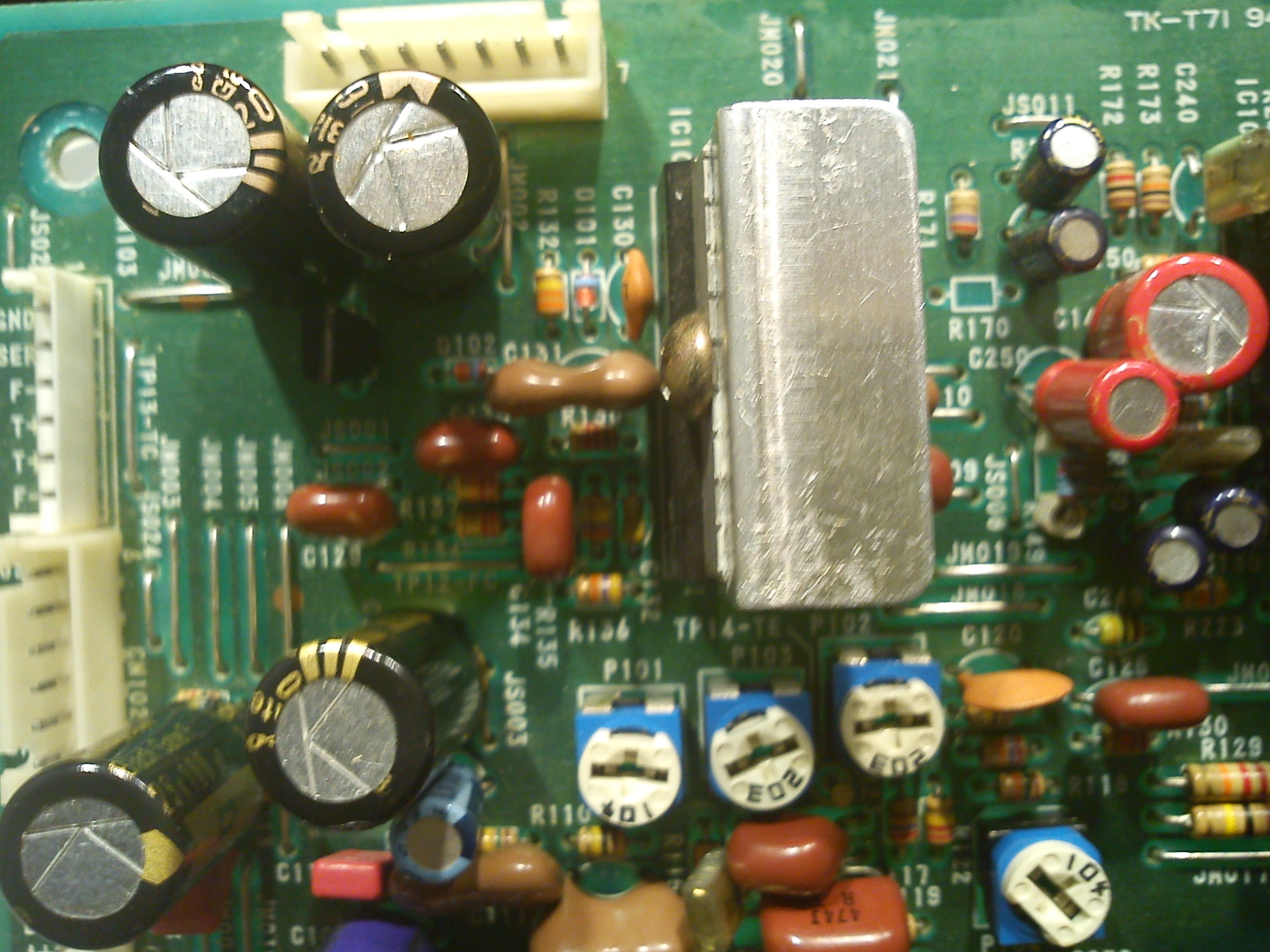

Thanks for taking the trouble to post the pics. The pots are not labelled here either as to function 🙂
I spent quite a while looking at more data on the LA9200 but nothing is clearly identifiable as to its absolute function. Your player seems to use the IC in dual supply mode.
It appears that there is NO laser power control built into the IC. That means that the laser power is preset on the pickup and with no preset present is non adjustable. So that seems to take that out of the equation.
I can only suggest (and this is up to you... no guarantees) that the function of the presets be determined experimentally.
That goes against everything I would normally recommend so it's up to you 😀

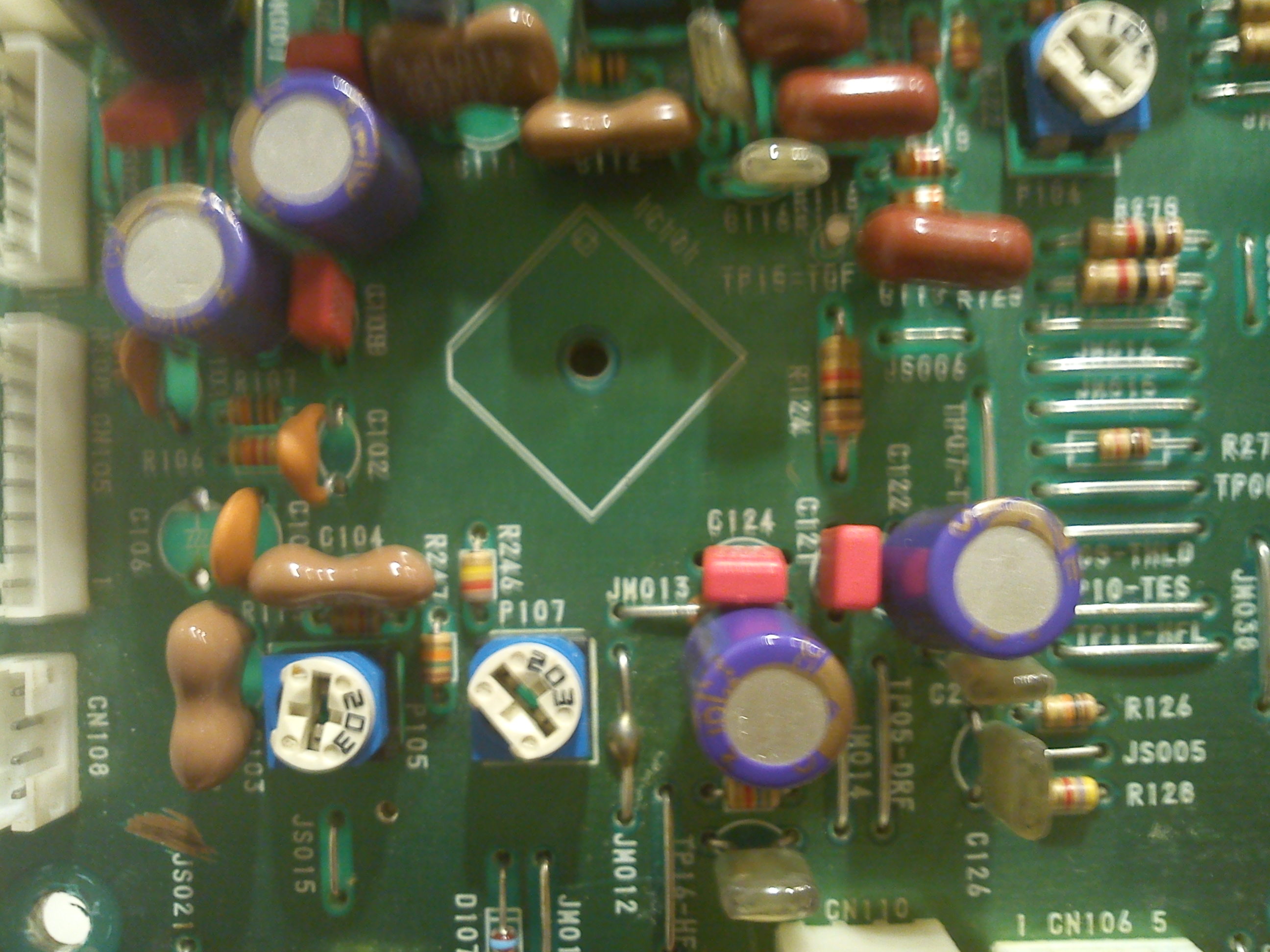

You need to first monitor the RF and adjust one at a time to determine function and then return it to the same physical position before turning another.
1. The focus bias pot will alter the clarity and amplitude of the RF signal. It has to be set for sharpest and highest level.
2. Focus Gain. May have no obvious effect on the RF but if you listen carefully to the "white noise" produced by the pickup itself it may increase as gain turned up. The focus pots seem to be the ones connected with pins 33 and 31.
3. Tracking gain. May show no obvious effect when turned. The correct way to adjust (and determine which is tracking gain) is to put the scope on the tracking error output from the IC and turn the pot. As the gain is increased a low frequency fundamental wave will appear. The correct gain point is just at the point of this wave appearing.
4 EF balance. Is performed by monitoring the tracking error wave and performing "track jumps" and adjusting for symetrical "above and below" a notional centre line.
Before doing any of this make sure ALL mechanical issues are attended too. Do the checks I mentioned on the sled motor.
Look up Sony service manuals for the CDP101 and Sony D50 mk1 as these give clear instructions on what to expect when adjusting a player. The controls and there effect are similar in most players.
Remember the warning though... no guarantees and be under no illusions.

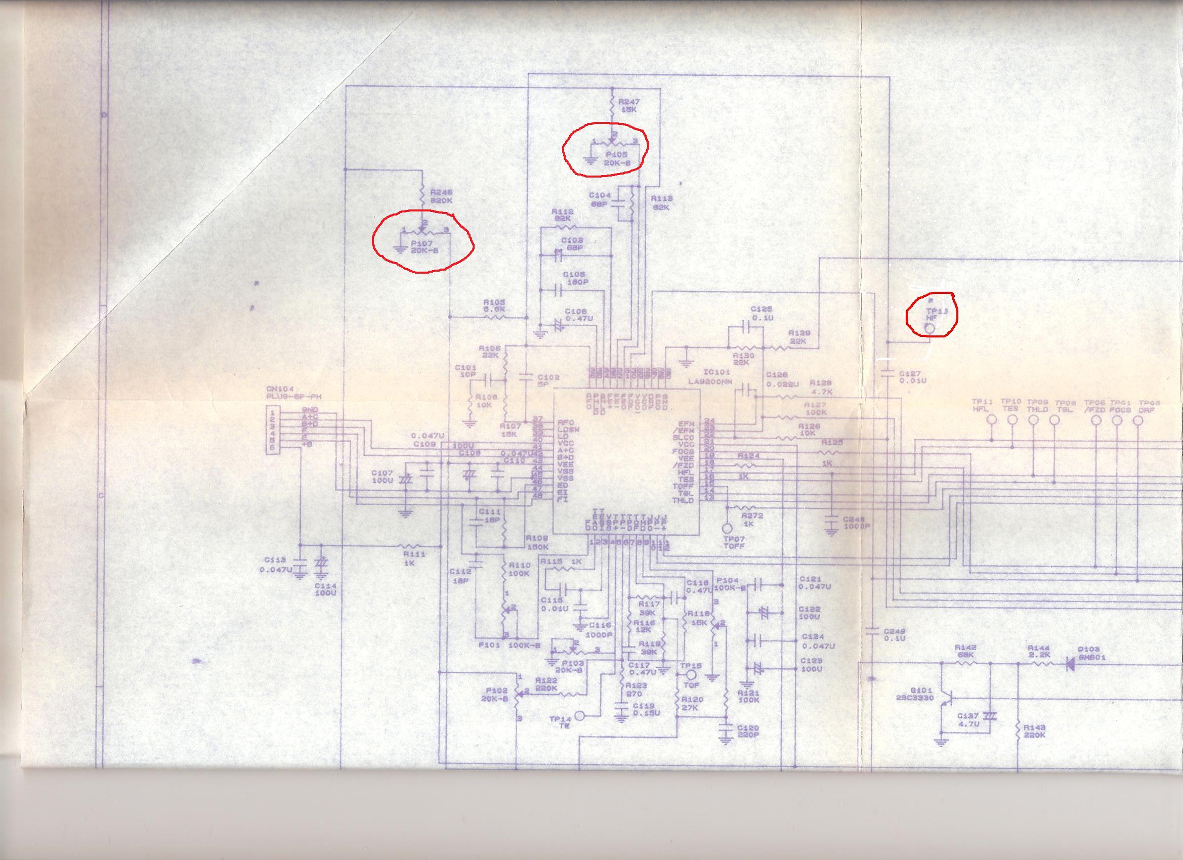

p107 20K goes to pin 4 IC103A LA6510 for focusing and go to pins 36-37 both RFO of IC101 LA9200, can be this pot do the focus bias?
p105 20K goes to pin 31 IC101 LA9200, can be this pot do the Focus Gain?
