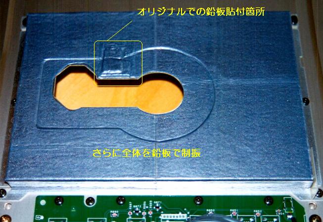

Have anybody in here any idea what this is. Under the cover under the disc. Cdp x5000
Scroll down to under the X-tal oscillator. The thing inside the yellow square with China lettering
http://www.cndiyclub.com/bbs/read.php?tid=15908

dacen:
The yelllow words are, in fact, in Japanese. I am a Chinese but I may translate.
The yellow square is an embedded Lead sheet for shock/ vibration absorptions and the whole sheet is also in Lead.
T Leung. Sorry for the very slow response. Thank you for the explanation. This makes sense. Best regards.
