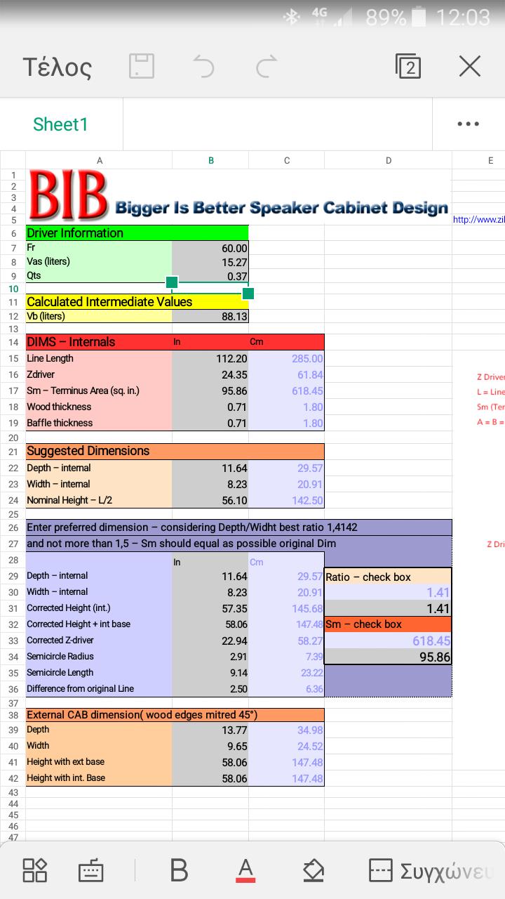

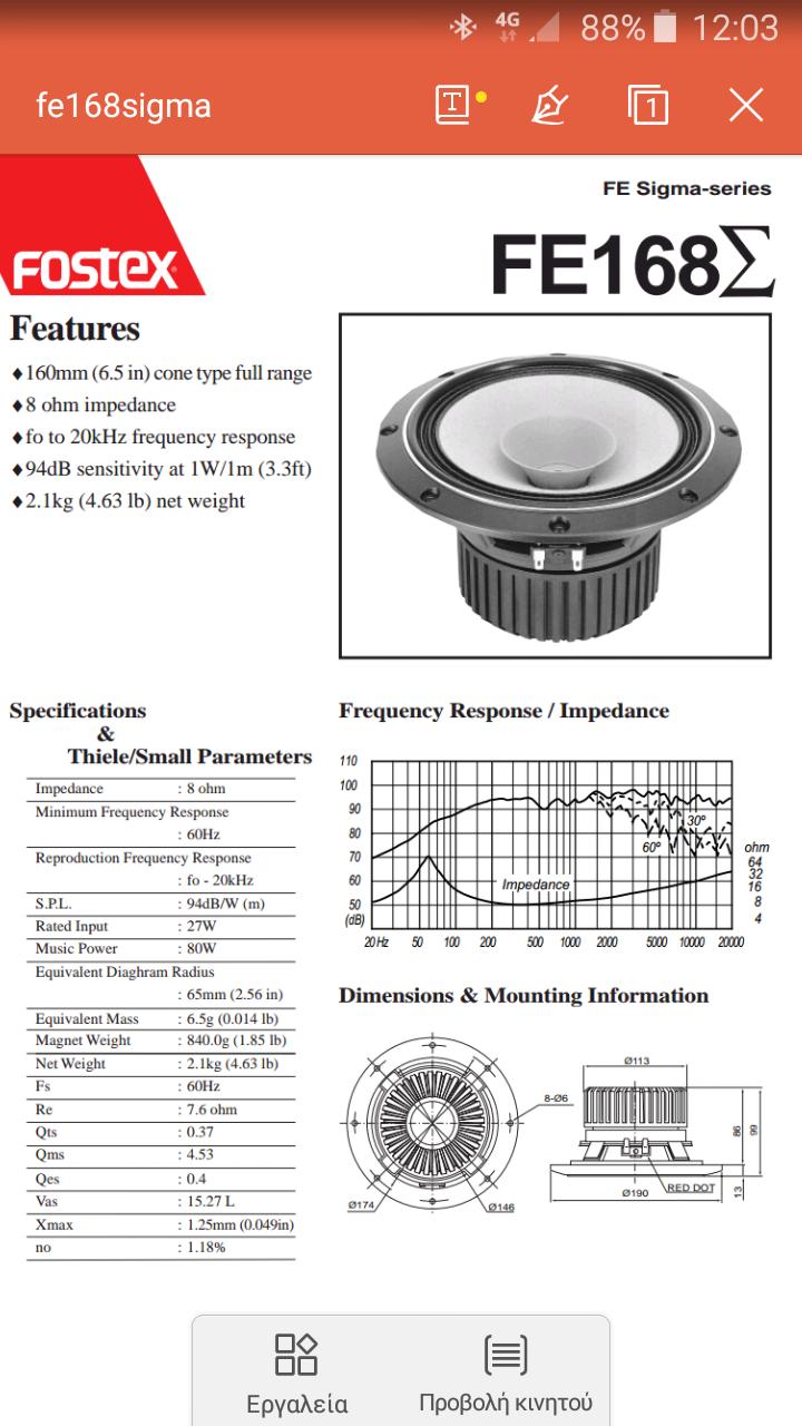

Hi I have a pair of the old fostex fe 168s (those with the wizzers) and I would like to built a pair of BIB's .Given the time passed is there something new on design for these drivers?
I have run the numbers to the BIB calculator V2 do I need to adjust something?
Also I would like to know where an what to put as absorbing material for optimum results limiting the experiments time .
And finaly If I go with an extra external round baffle how big must be in diameter ?
I plan to use mdf I read somewhere for combination of different type of materials what do you propose?
Thank you in advance
Nick

Yeah, we really need a synopsis 'BIB for dummies' post, though it's so 'politically correct' these days I'll probably have to re-name it 'BIB made simple/easy' or some-such lest I offend anyone. Regardless, I'm [very slowly] working on a collection of posting links to refer to since these are still popular enough to justify it.
Personally, I would adjust the 'Fs' value downward to get the terminus closer to the ceiling using this as a guide, just don't tune below [Fs*Qts'/2]: http://www.diyaudio.com/forums/full...e-fostex-craft-handbooks-110.html#post4903502
