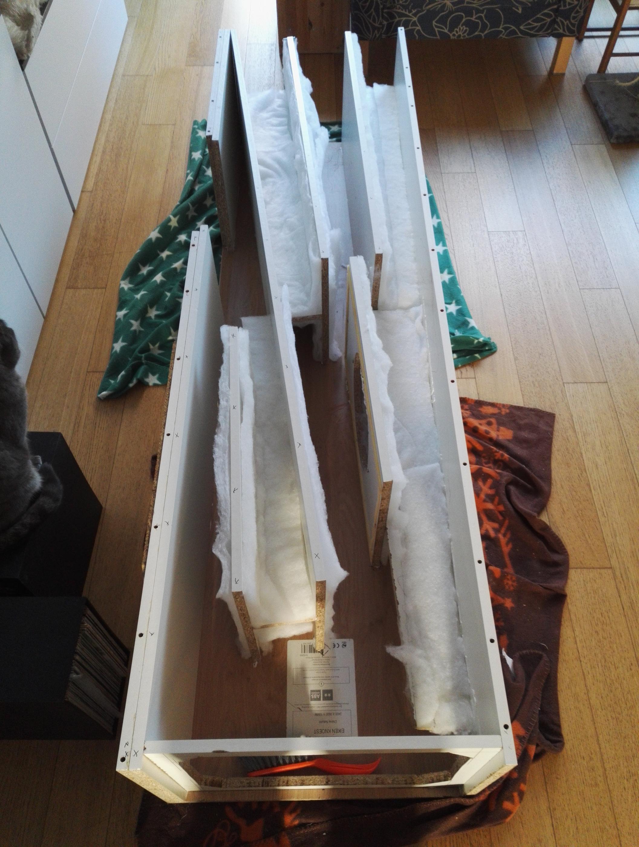

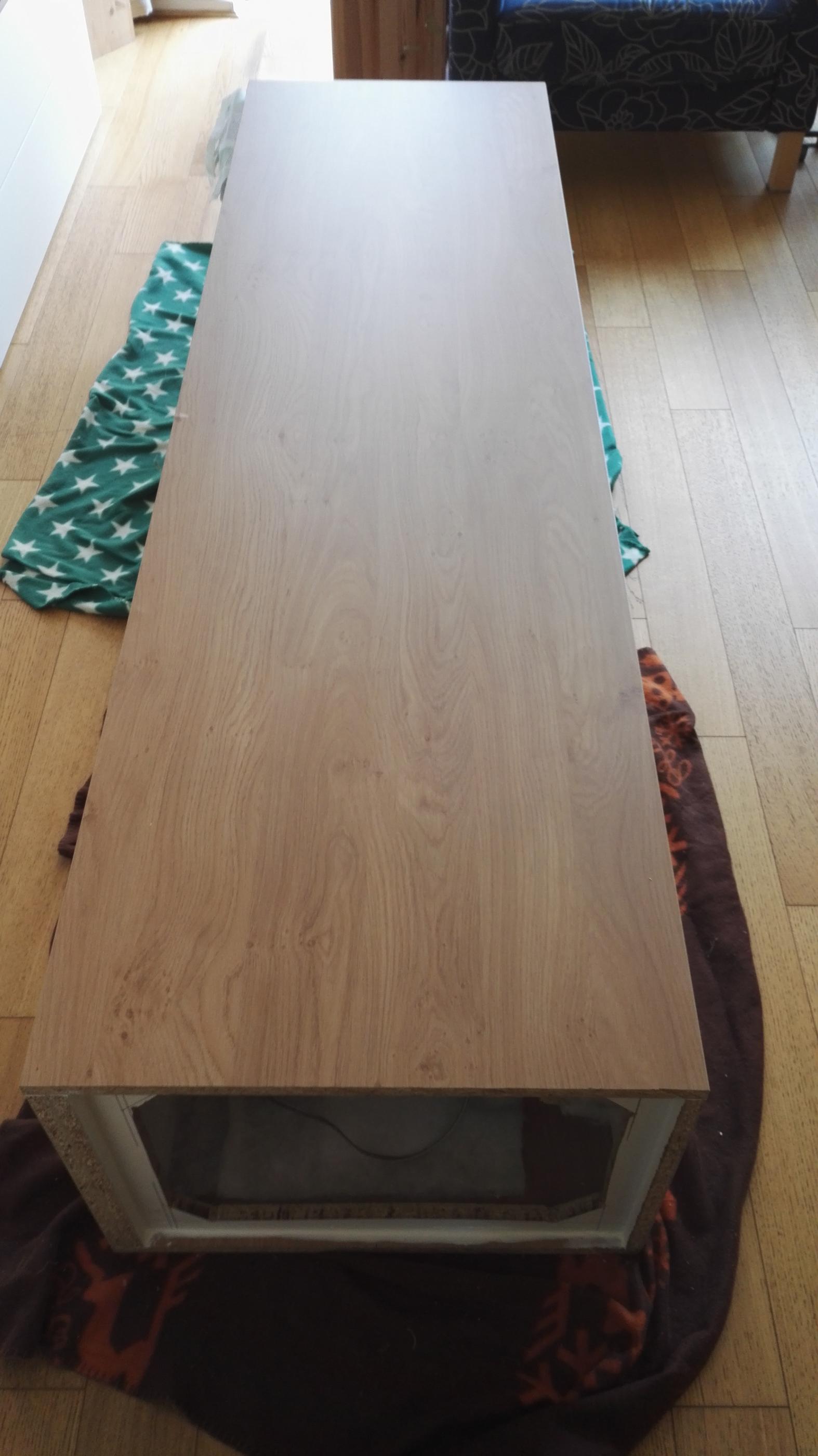

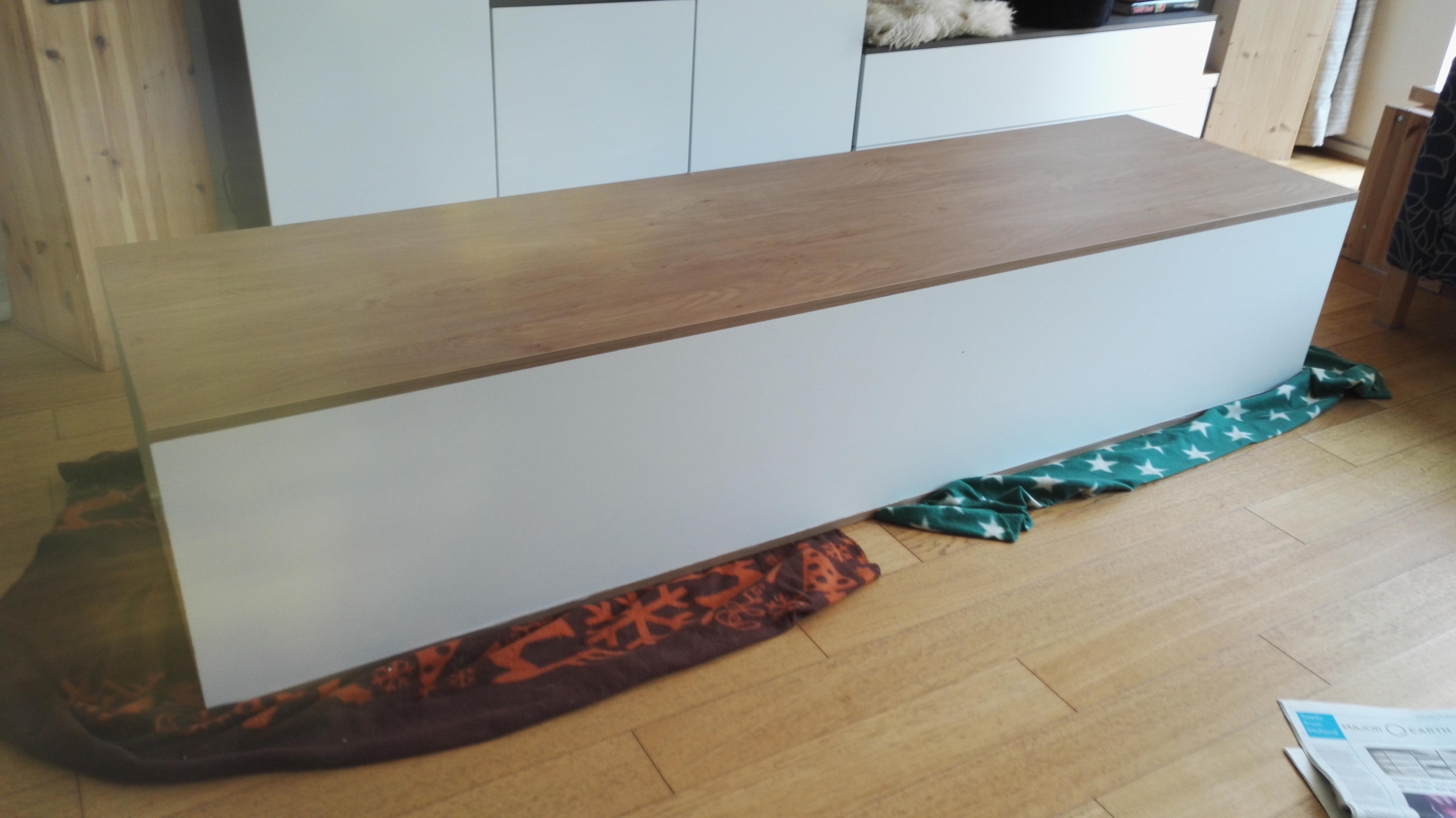

It's finally in one piece, after these pictures, I added more damping material on the panels etc. I'm erecting my version of Stonehenge tomorrow. Oh, but I have to drill the bottom hatch first. And saw a double-layered baffle. It's those damn little things, isn't it? 🙂
The wife is a bit anxious. "You are getting rid of the smaller ones, right? You get to build two of these, but you get rid of the smaller ones! And can we watch Independence Day when this one is done?"

Sweet! 😀 I want to see more of the room, house; ya'll folks in that area of the world have the most fabulous looking wood and most? don't hide it with dark stain like in my locale.
I forget, what are the mains? I presume she means getting rid of the TB BIBs?

Apart from the oak floor (it's actually laminate with real oak veneer instead of woodprint plastic), not much wood exposed in the living room. We have a more modern taste, modest budget and a toddler that dictates scratch resistant finish.
The exterior of the house is all brick, structure is concrete. We call it our nuclear bunker, we have bad wifi and cellphone coverage etc. Seems perfect for cornerhorns and I want to build the Olson corner horn at some point. A Dutch diy hifi guy made a 3D model of the original drawings, in time these must become a cut sheet.
The current BiBs are the little ones with the mini-arrays. I already got rid of the TB-BiB to make space.
