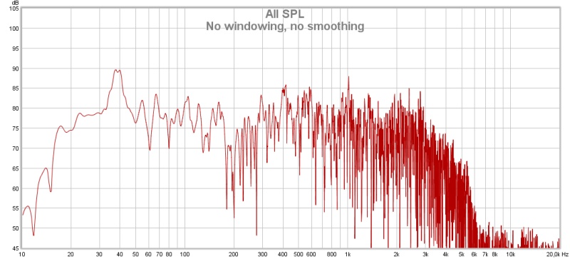

First measurements: looks like -3dB at about 16 Hz. Decently flat response, especially at the hotseat, but seat to seat variance is bigger than with the last speaker. Big bump at 40 Hz, but looks EQ-able.
I had a shock initially, response dropped like a rock below 250 Hz, a straight line like it was drawn with a ruler. Or.... a DSP chip. Forgot to switch the receiver to direct mode and I had it hooked up to a satellite channel for measurements. My wife tells me I'm getting old and maybe she's right. F****ng buttons and settings on the d**n AVR.
I'll post some graphs later.

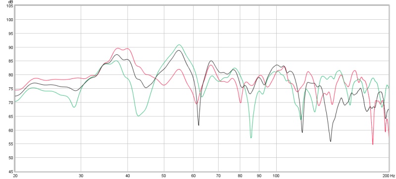

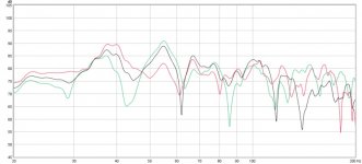

Yes, that's a room mode. Playing with EQ in RoomEQwizard, it seems this is easily corrected.
I am not too happy about seat to seat variance, below are three seats on the same sofa. I had succes with a dual subwoofer setup before, so I would like to try something like that with an extra BIB. Some time.
