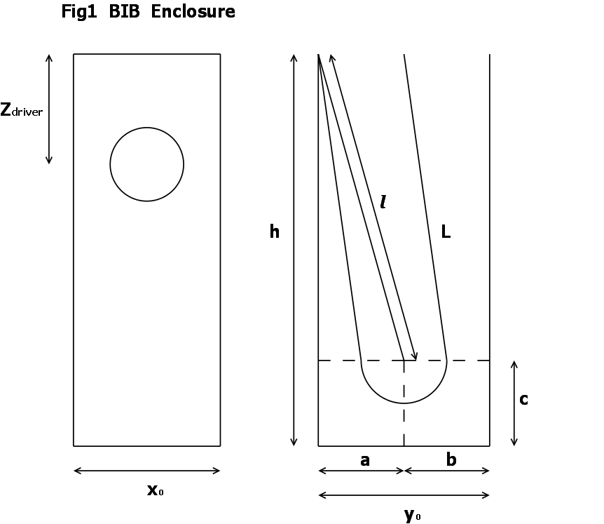

Let's consider a BIB enclosure like that on the figure
Using simple euclidean geometry, the length of the horn is given by
L = √(4 h² - 8 a h + 5 a²) + (π a/2)
The height of the enclosure is given by the solution of
4 h² - 8 a h + 5 a² - [L - (π a/2)]² = 0
With
L = c' / (2 Fs)
c' = 340 m/s (speed of sound)
The volume of the enclosure is given by
Vb = 20 Vas Qts^(5/4)
The internal septum has a volume which is not negligible, in the order of some liters, and it is given by
Vint = l xo d = √(h² - 2 a h + 2 a²) xo d
d = septum thickness
Then, the total volume of the enclosure is given by
V = Vb + Vint
Then, the terminus area should be
Sm = V / h
The other imposed condition is
yo = √2 xo
Then
Sm = xo yo = √2 xo² = (√2/2) yo²
Then, the width of the enclosure will be
xo = √[(√2/2) Sm]
The depth of the enclosure will be
yo = √(√2 Sm)
Zdriver will be given by
Zdriver = 0.217 L
Finally
a = b = c = yo/2
Note that we need an iterative method (e.g. Newton) starting with the approximation
h ∼ L/2

Just to check the equations of post#5623, maybe it will be useful for someone...
T/S parameters
Qts = 0.201, Vas = 60.1 l = 60100 cm³, Fs = 42 Hz
Invariants
L = c' / (2 Fs) = 404.762 cm
Zdriver = 0.217 L = 87.83 cm
Vb = 20 Vas Qts^(5/4) = 161.77 l = 161770 cm³
Initial values
ho = L/2 = 202.381 cm
Vinto = 0
Vo = Vb = 161770 cm³
Smo = Vo / ho = 799.33 cm²
xoo = √[(√2/2) Smo] = 23.77 cm
yoo = √(√2 Smo) = 33.62 cm
ao = yoo/2 = 16.81 cm
d = 1.80 cm
First Iteration
Vint1 = √(ho² - 2 ao ho + 2 ao²) xoo d = 7972.35 cm³
V1 = Vb + Vint1 = 169742.35 cm³
Sm1 = V1 / ho = 838.73 cm²
xo1 = √[(√2/2) Sm1] = 24.35 cm
yo1 = √(√2 Sm1) = 34.44 cm
a1 = b1 = c1 = yo1/2 = 17.22 cm
4 h1² - 8 a1 h1 + 5 a1² - [L - (π a1/2)]² = 4 h1² - 137.76 h1 - 141184.38 = 0
h1 = 205.88 cm
Second Iteration
Vint2 = √(h1² - 2 a1 h1 + 2 a1²) xo1 d = 8303.34 cm³
V2 = Vb + Vint2 = 170073.34 cm³
Sm2 = V2 / h1 = 826.08 cm²
xo2 = √[(√2/2) Sm2] = 24.17 cm
yo2 = √(√2 Sm2) = 34.18 cm
a2 = b2 = c2 = yo2/2 = 17.09 cm
4 h2² - 8 a2 h2 + 5 a2² - [L - (π a2/2)]² = 4 h2² - 136.72 h2 - 141361 = 0
h2 = 205.85 cm
Third Iteration
Vint3 = √(h2² - 2 a2 h2 + 2 a2²) xo2 d = 8245.78 cm³
V3 = Vb + Vint3 = 170015.78 cm³
Sm3 = V3 / h2 = 825.92 cm²
xo3 = √[(√2/2) Sm3] = 24.17 cm = xo2 ==> Convergence
yo3 = √(√2 Sm3) = 34.18 cm = yo2 ==> Convergence
a3 = b3 = c3 = yo3/2 = 17.09 cm = a2 = b2 = c2 ==> Convergence
4 h3² - 8 a3 h3 + 5 a3² - [L - (π a3/2)]² = 4 h3² - 136.72 h3 - 141361 = 0
h3 = 205.85 cm = h2 ==> Convergence

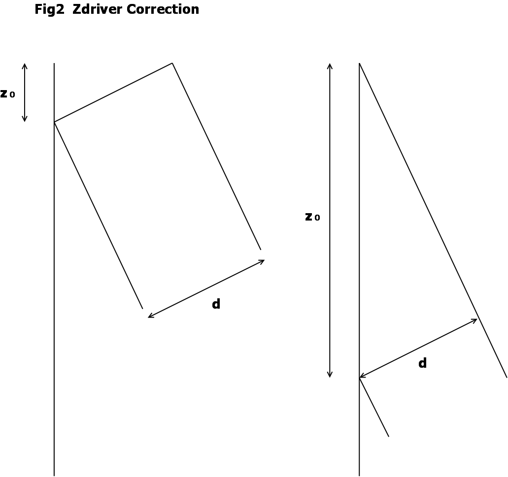

Some corrections
The correction for L, ∆L is negligible because correction in the upper corner almost cancels with correction on the bottom.
For the correction in Zdriver we must distinguish two cases
i) Poor skills in woodwork (my case), left side on Fig2
zo = d sin(θ)
ii) Amazing skills in woodwork, right side on Fig2
zo = d / sin(θ)
θ = tan⁻¹[a / (h - a)]
Seems to me that the cut is almost impossible... so, forget this case.
Final Results
L = 404.762 cm
h = 205.85 cm
V = 170015.78 cm³
Sm = 825.92 cm²
xo = 24.17 cm
yo = 34.18 cm
a = b = c = 17.09 cm
Zdriver = 87.99 cm

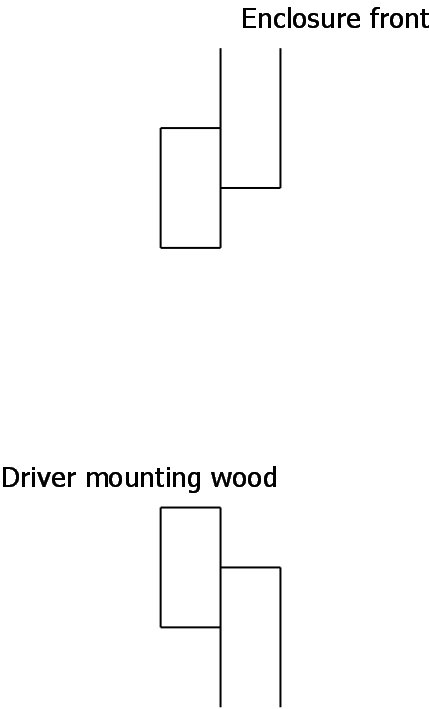

The last question: With Zdriver=0.217 L the speaker's magnet will touch the septum, what do you suggest?
This one is easy. Carve out enough space for the magnet. If you can't do that without going through the separator then you can add a piece of wood in front of the front panel to support the speaker and thus move the magnet away from the separator or, as I did... use a thicker front panel 🙂
If none of this solutions fits your bill, then you could have to move your speaker down, into the next calculated Zdriver.

Yes, that's what I was suggesting. Usually you do that as a simple square extension that goes side to-side in the front of the BiB, or as a part of more complex designs intended to compensate for the dip in mid-bass due to the slender shape of the front baffle. I'll try to find some of those examplesto serve as examples in my backup HDDs as I posted them to another forum that is long gone now.
I forgot to mention, you can always make the front baffle more slender and in that way you will get a deeper box, with more space to fit the FE208 magnet. It comes with the trade-off that if you make it too slender, then you will need some additional front baffle to compensate the dip... or (horror!!!) use equalization.

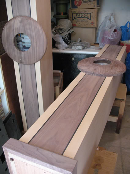

I just used a thick piece of melamine (about 1 3/4") which belonged to a salvaged piece of furniture as the front baffle and routed off the back side of the baffle to provide the driver with more space to "breathe". BiB is a very forgiving design.
If you would like to see a more in-depth analysis, Martin King did some on it: Bib Analysis
I will try to post some photos of the baffle and hole this night.
G.
popilin,
What ghpicard is suggesting is also know as the "supra-baffle". Here you with a link of a BiB built by a diyAudio member a few years back, where he used quite a large supra-baffle.
http://www.diyaudio.com/forums/full...e-fostex-craft-handbooks-432.html#post1650849
Have also attached a pic taken from that post only.
On this site (Godzilla's site) there's some graphs on supra-baffle shape and effect on frequency response.
https://speakerprojects.wordpress.com/cabinet-types/bib-loudspeakers/bib-calculator/
Yes, that's exactly the idea, with a variant, the hole on the front panel is a bit bigger than the hole on the speaker mounting panel, so the speaker can "breathe" better, so to "speak"
G.

popilin,
Thank you very much! It seems that the idea is very popular, anyway I can do it simpler, my woodwork skills are a bit poor for the task.
The supra-baffle also allows me to find a better place for the tweeter, because the FE208EΣ goes well up to 12 KHz or so.
