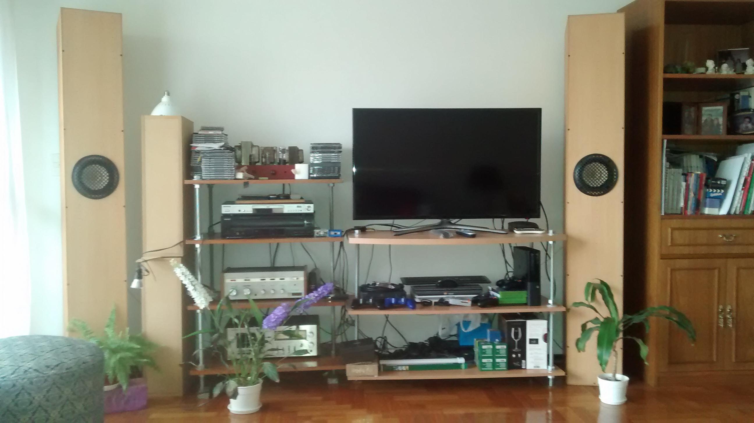

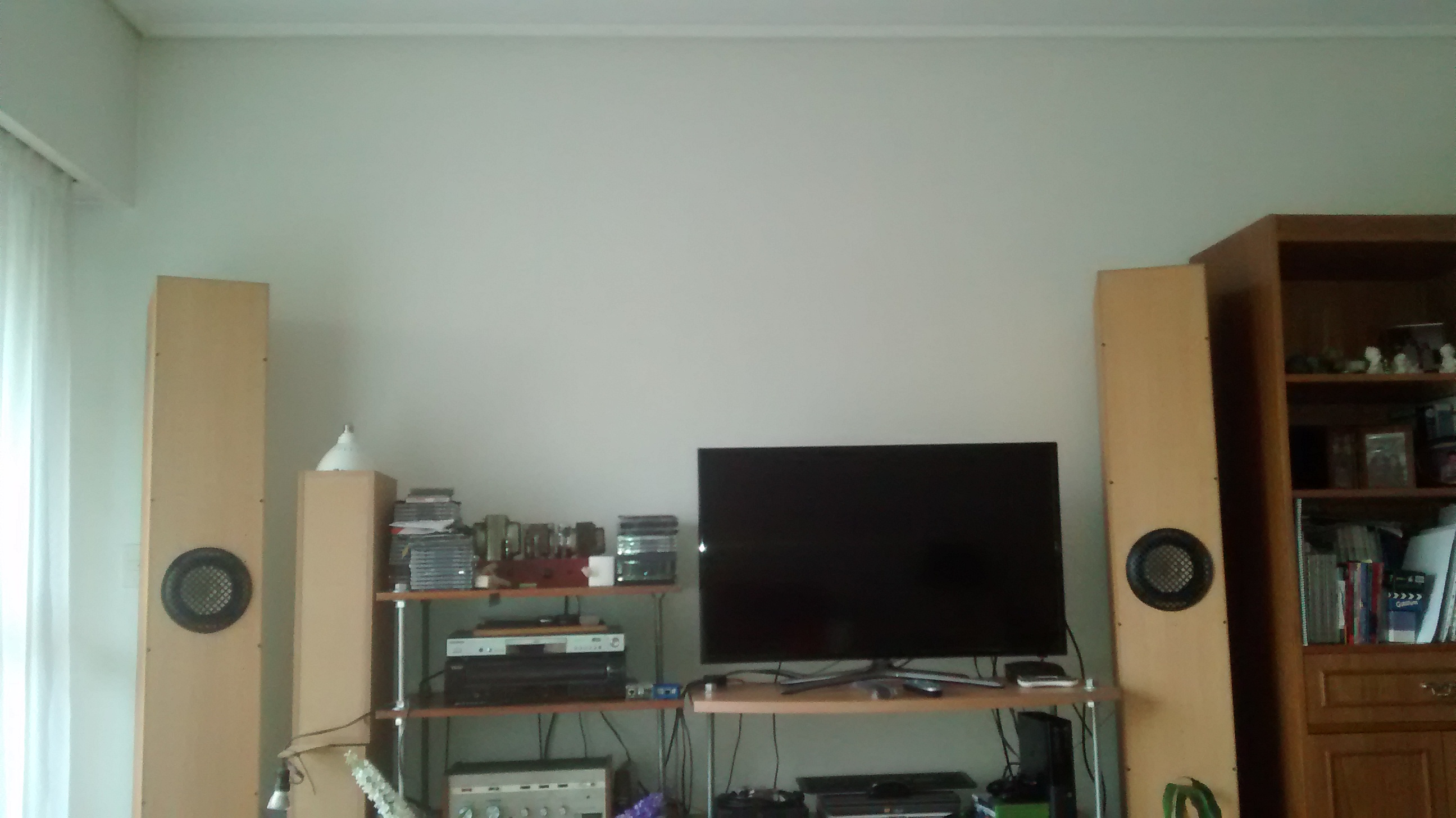

Of my two BiBs one of them is corner loaded while the other one is only wall loaded. The difference in low bass response is noticeable as is the cone displacement magnitude for the drivers.
Here are two photos of my setup taken from the listening spot. General view and ceiling/corner emphasis. Please forgive the mess.

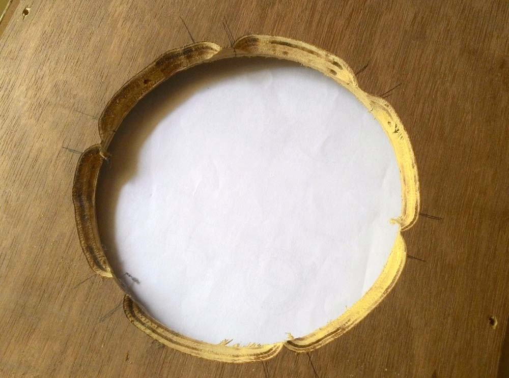

My woodwork skills does not allow me to make a circular cut chamfered at 45º, what about the idea on post#5631, i.e. the supra-baffle with the right diameter and the front, say 4cm bigger?
Well, it is a little embarrassing, but I have no instruments to put the tweeter in phase, so this idea did sound good to me
But you are the master, so I will follow your recommendation.
It wouldn't be my first choice since the flat 'step' creates a ~infinite set of reflections over a narrow range, so if done this way, best to line it with a fairly dense material. That said, I've never experimented, so may not be acoustically strong enough to audibly affect performance, but 'God' is in the details, so might as well make sure since it's cheap, easy to do.
The latter is by far the main reason for wall/corner loading, especially smaller drivers with a low Xmax and doubly so when using Markaudio or similar that have virtually no audible distortion to indicate the driver is very close to hitting its mechanical limit [Xmech].

Beautiful speakers!
Mess??? What mess?
Obviously you do not know a high entropy environment, aka my house... 😛😀
OK, understood, and thanks again.
FWIW, I didn't have a router during my speaker building 'career', so chamfered the driver holes with a really coarse half round bastard rasp. Rips up the [ply] wood really good, making an uneven back cut with a lot of reflective surfaces to randomly diffuse them, the theoretical ideal AFAIK. A good way to vent any frustrations too! 😉
That is not my preferred tool, but the new problem is that driver support screws will left with its end on the air.
I do not like any randomness, on the contrary I like the symmetry, so what about an eight-pointed star, with screws at each end? Should be this a good average?
popilin,
Please refer to the attached - an example of a chamfer I did keeping some material for the screws to dig in. This was for an Mark Audio Alpair 10 driver.

popilin,
Which driver are you planning to use?
Hi zman, you save me for another drawing, that is exactly the idea, thanks!
I am planning to use the Fostex FE208EΣ with the FT17H, cutting at about 10KHz with a capacitor, 0.47μF or so, not calculated yet.
