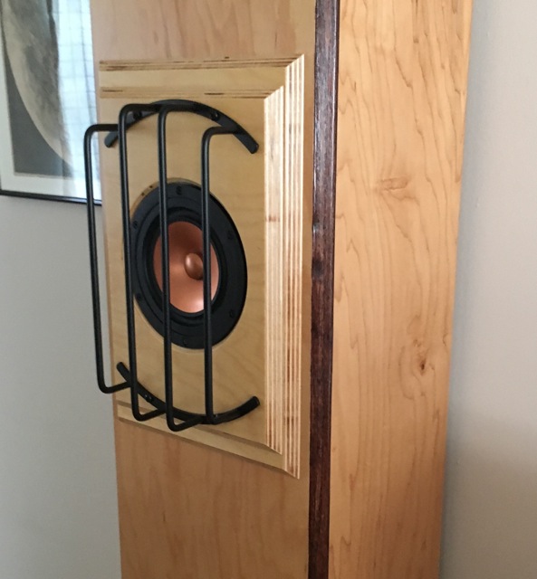

Last fall., Madisound put the Mark Audio Alpair 10.3A drivers on sale for $79. I took this as a sign that it was time to buy a pair & build a pair of BIBs!
I have wanted to try a BIB enclosure for some years now, and the A10.3 drivers seem like an ideal choice. They should make useable bass down to 20 Hz in a tall, thin cabinet—I think this makes for a true ‘full range’ speaker.
I modeled the cabinet in MJK’s MathCAD worksheets, settling on exterior dimensions of 88” h x 9.5” w x 12.25” d. I made the baffle 12.5” wide (extending 1.5” beyond each side panel), so that the supra baffle wouldn’t extend beyond the baffle.
The edges of the baffle were routered with a 45 degree bit, covered with red oak edge trim veneer, and stained a dark red mahogany color for contrast.
The bottom is removable, allowing easy access should I need to make any adjustment to the damping. The front side of the slant board is covered from bottom to within 10” from the top with 0.5” Sonic Barrier damping (Parts Express #260-520). The bottom has one layer of 0.5” foam adhered to the panel plus a piece of 1.5” egg crate foam (PE # 260-510).
The supra baffle is made from two pieces of 12mm BB ply, both with outer edges routered to 45 degrees. The driver is mounted on the inner piece, while the outer piece makes the driver flush mounted. Note that the driver hole in the outer piece has a little 45 deg. bevel so that the 10mm thick driver bezel matches to the supra baffle.
The drivers are rather attractive, so rather than hide them behind grill cloth— or leave them totally exposed— I used PE 10” black bar grills (#260-441).
But I did use grill cloth! —to cover the horn mouth, preventing dust from accumulating in the horn.
Finally, I installed adjustable furniture glides (feet) to allow for quick & easy leveling. In the long run, these BIBs probably need to be anchored to the wall so that they can’t tip over & injure someone. I’m looking at 3M Command Adhesive products so I won’t have to drill into the wall.

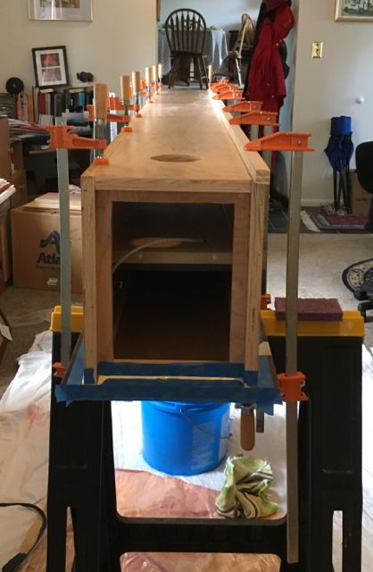

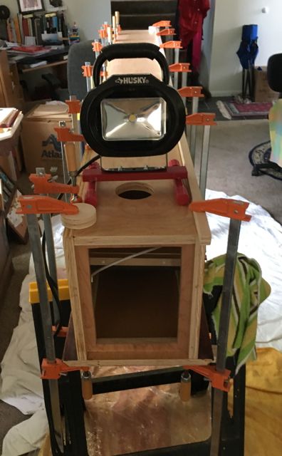

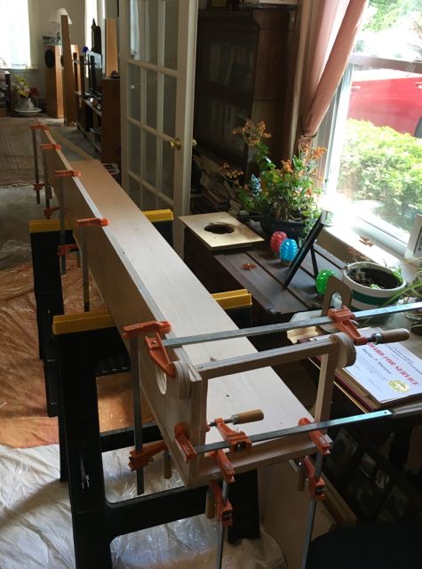

Build photos, in order:
— attaching back & cleat for bottom to side
— work light used in fit-up; I use dowel pins to assure alignment during both dry fit-up and then glue-up. When doing the dry fit-up, I use a work light inside the cabinet to be sure that joints are tight; light leaks mean either shifting placement of clamps or adjustment with a sanding block.
— gluing baffle; note blue painter’s tape used to catch glue squeeze out, making clean-up easier.
— close-up of supra baffle & grill

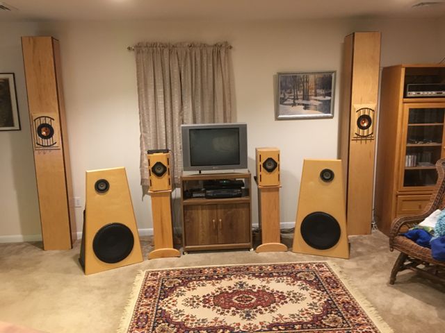

The BIBs are in my bedroom system. The room is 20’ 8” by 19’ 5” minus a few feet where the walk-in closet protrudes into the area. (And the room 8’ high.)

Photo attached:
— BIBs in room w/ OBs & Fonkens Prime
My Thanks to all who have contributed to the BIB project and this thread! 😀

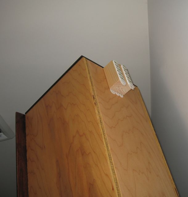

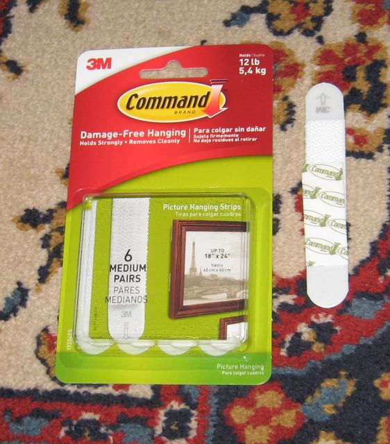

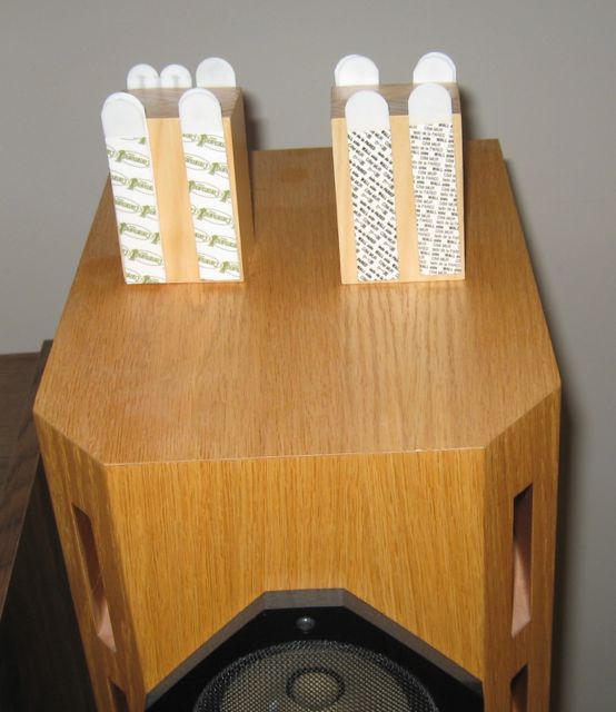

My answer to the tippy BIB issue: 3M Command adhesive products.
I made small wooden blocks 1.5” thick to match the wall spacing of the BIBs in their final location. To the speaker side of the blocks I applied large 3M adhesive pads originally intended for mounting large (removable) hooks. To the other side, I applied 3M picture hanging strips, which are like pieces of super Velcro. The speaker can be moved by pulling the speaker forward to separate the Velcro. Afterward, the speaker can be moved back into place and the Velcro will re-attach. Should I choose to permanently relocate the speaker, I can removed the 3M strips from the wall without damage, and only need to replace the wall side strips at the new location.
This is not as secure as using metal brackets and screws, but should do for my purposes. If you have children who might run into the speakers or try to climb them, then brackets and screws would be the better choice. 😉

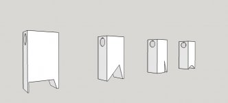

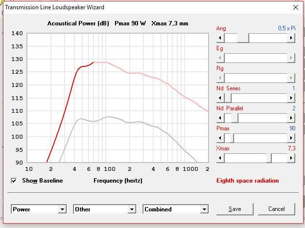

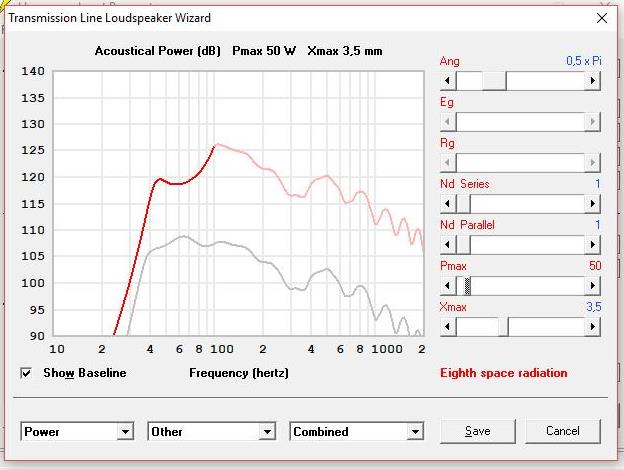

My new Ciare CH250 drivers have been delivered (new as in second hand new to me). I was planning on making some aperiodic boxes for them and screwing one to my Bib sub, the other placed on top of a piece of furniture. My wife was not amused. She says I could have the assigned corners and put a pair of stereo loudspeakers there. Not "a pile of smaller boxes all around." And not unsightly lumps sticking out of the large ones. Very clear.
Obviously, my CH250 unites are classic open baffle drivers, but I have a very live room and OB is not pleasant here. They don't go very low in periodic boxes. I looked into TL, but obviously also into BiBs.

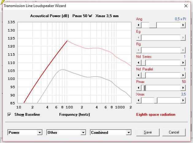

The basic BiB math gives a volume of about 1450 liter. Big. Does not fit into the assigned corners. I just tried some iterations in hornresp with what ever I could place and came up with 240 cm length, mouth 2090 cm^2. Volume is about 250 liters.
Hornresp suggests response down to about 35 Hz and max SPL at above about 100 dB at 40 Hz. I am thinking about going inverted BiB, rear-firing.
What do you guys think, should I give it a try?
Apparently, I have a mild addiction going on... 😀
Good point...
Here I have your TL and my BiB (sorry, under-sized pipe horn is more like it), i shifted driver position to 0.56. Some more extension and higher SPL max. Response sims smoother if I introduce a path difference between driver and horn mouth.
I have to think a bit about internal layout. I was thinking about making it like a folder version of my array-BiBs, with a mouth cut out the back and firing into the corner. With the driver exactly on that side of the cabinet, that would not work. Maybe just some triangles on the sides as far back as possible to the rear.
Any suggestions for improvements of this sim? L= 240 cm, Sm= 2090 cm^2.

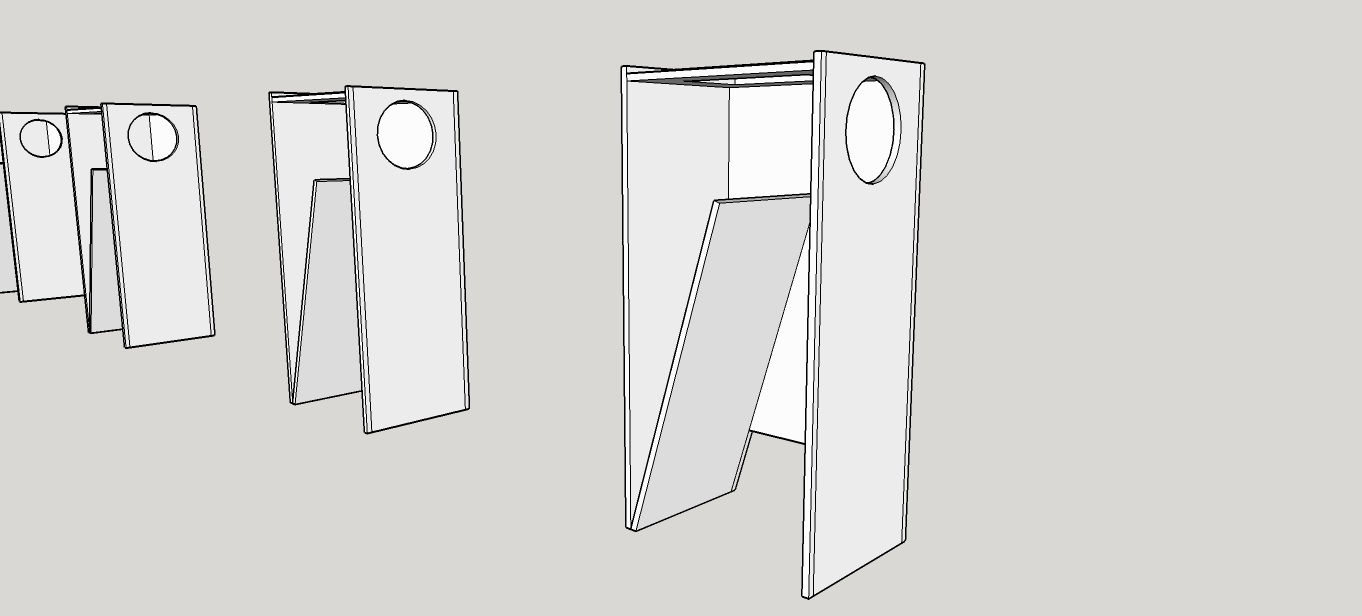

Basic layout and some ideas for the mouth termination. First two (starting from left) are a full size mouth, I would make the cutouts on both sides of the enclosure. Last two are restricted mouth. The last one is a bit FH inspired. Restricted mouth requires more simulation.
I'm sort of warming up most to the second one, the angled full-mouth cut-out. A touch of the original TC inverted BiB with angled mouth.
I also simmed it with one and two Tangband W68-1042 woofers. I have four and this design is basically a somewhat larger and tweaked version of my tangband
BiB. See screenshot, two drivers. It seems to do well. I liked that tangband BiB, it had a really dynamic and punchy sound. It's nice to know this new design could potentially be converted to a tangband BiB "plus".
Only thing is, my wife has been very clear about the amount of big boxes allowed in the house. So if I build this, the current 12" BiB is going to the trash. That sucks.
