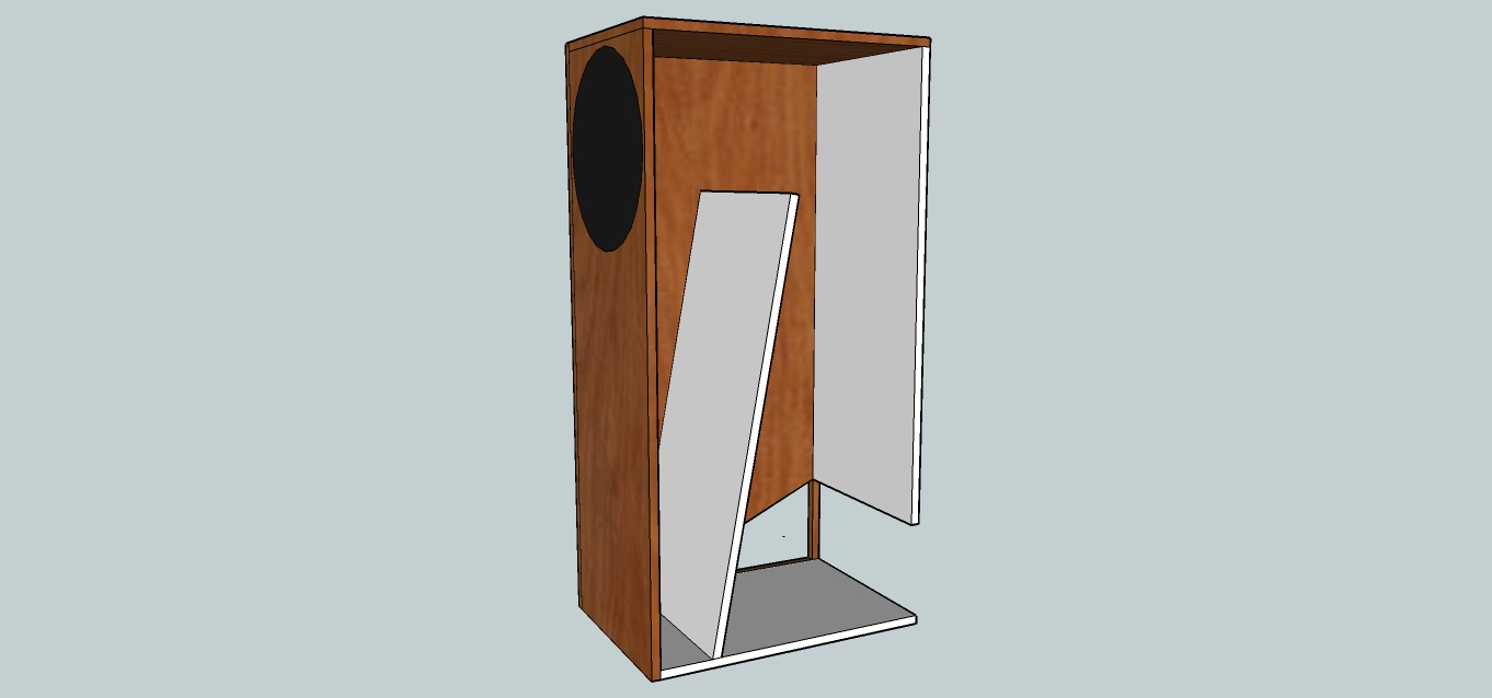

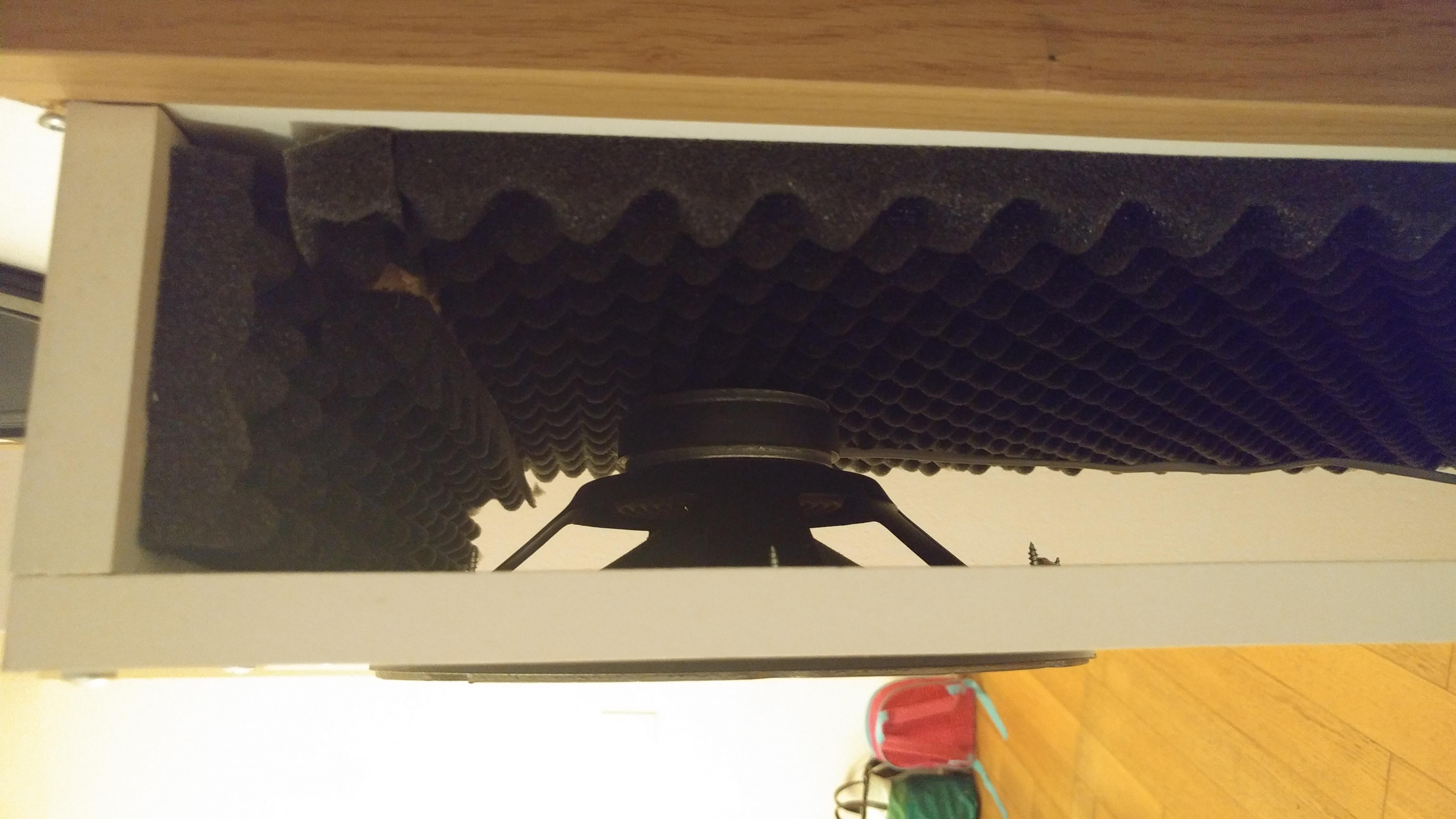

Here's the construction.

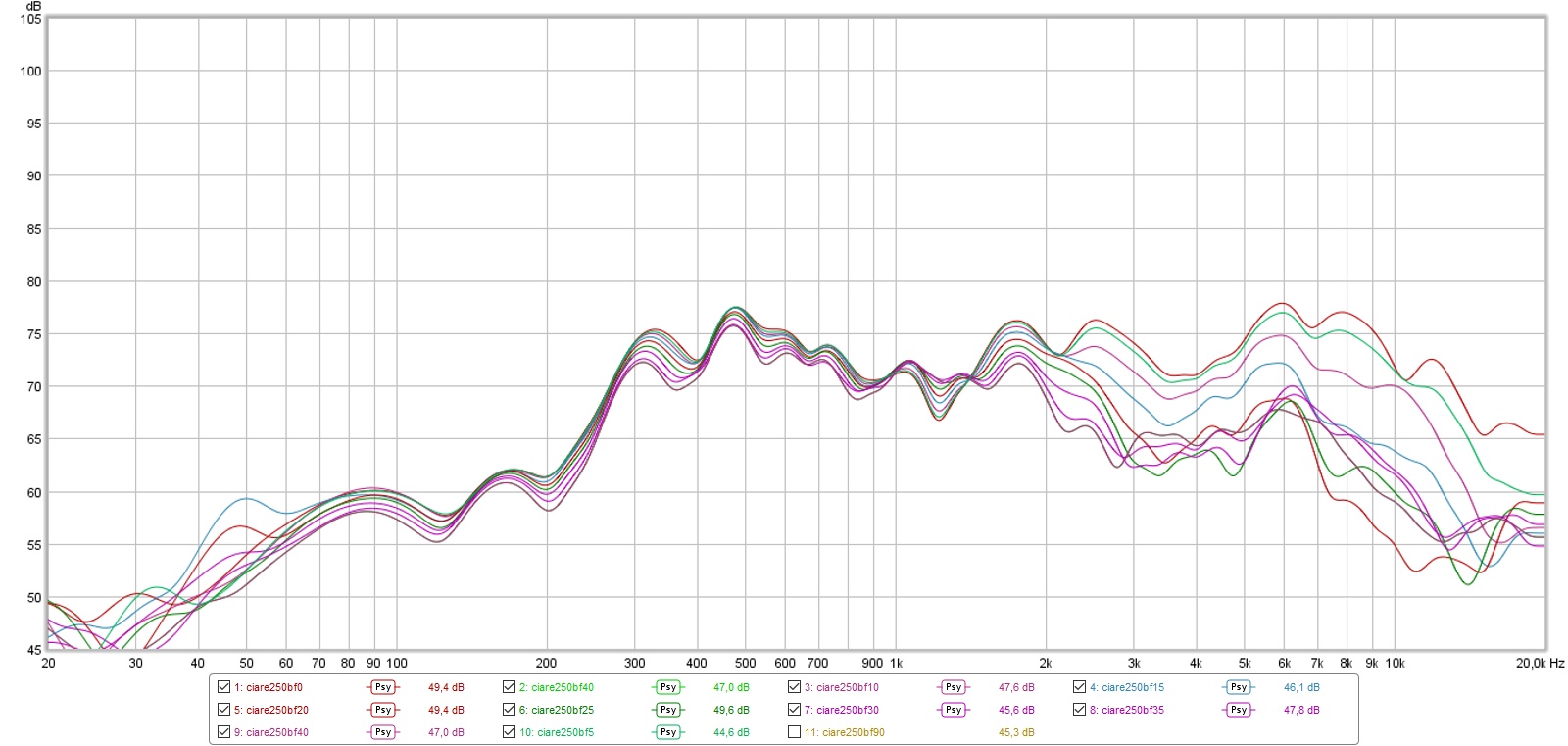

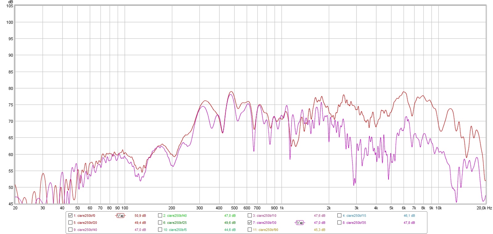

Here's some measurements. One with five degree increments, 0 to 40 degrees with lots of smoothing, the other of 0 and 30 degrees with 1/48 octave smoothing. No EQ. Sound is still changing, these measurements might look different after further loosening up. Already sounding nice. Nice tweeters for my BiB. 😀

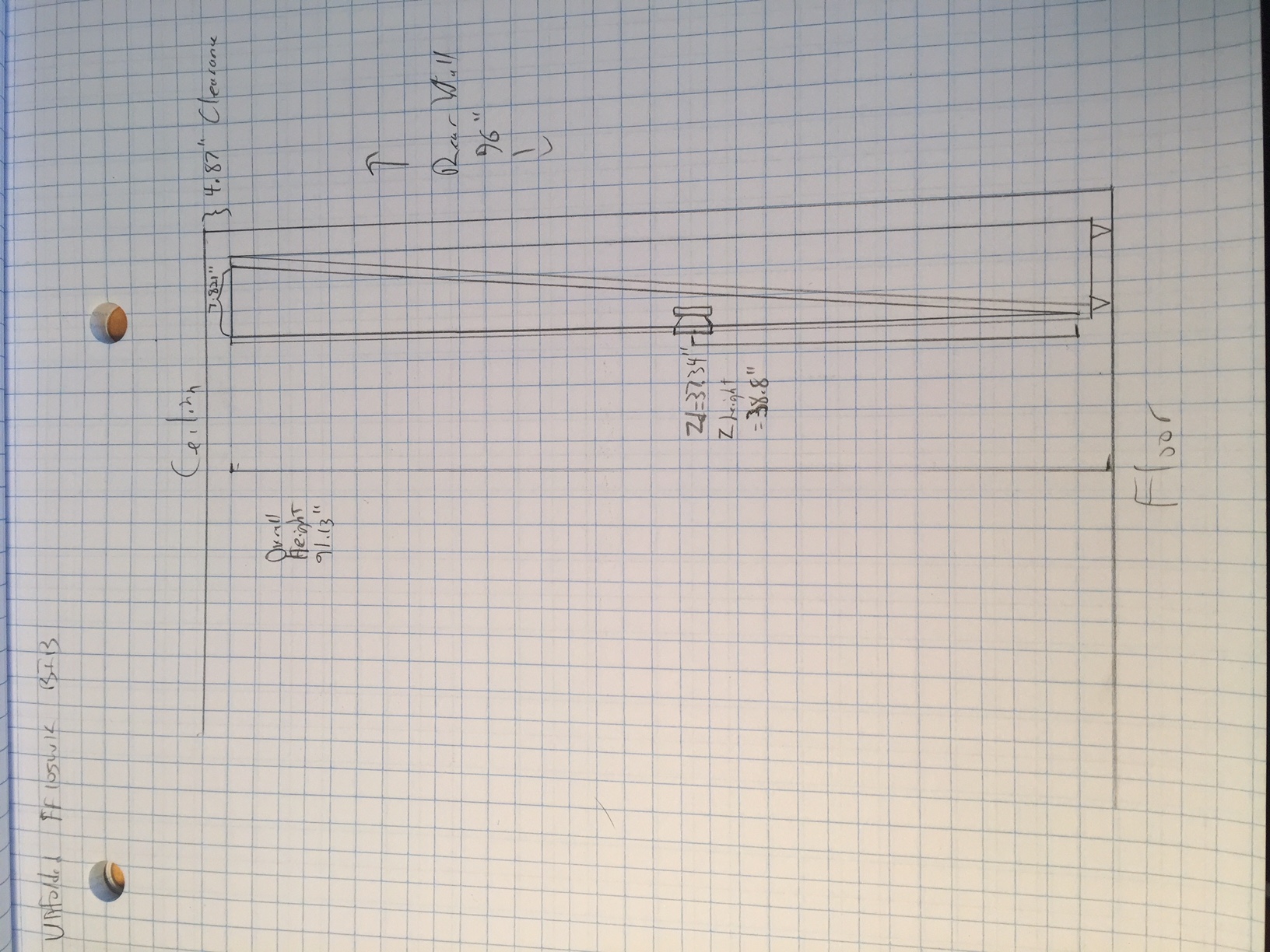

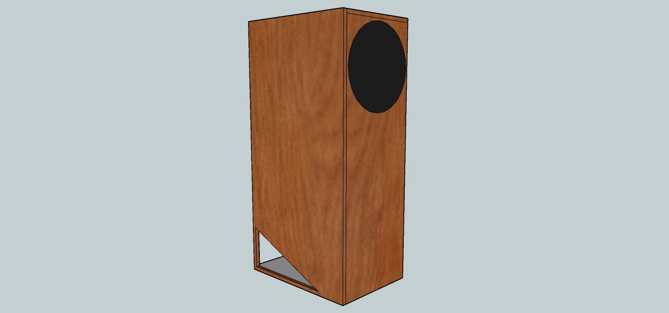

I've searched this thread for information on how to figure out the optimal clearance between horn opening and ceiling or floor in a corner-loaded BIB and haven't found any. Please point me to the info if it's already here, but if not, I thought I'd open this for discussion.
Maybe there is no optimal clearance, so any experience or general guidelines would be appreciated too.
My best guess is that, since the BIB uses the room boundaries to continue the horn, the distance from horn mouth to ceiling would ideally be equal to the front-back length of the mouth, just like where the a-b-c distances are all equal at the horn fold in a traditional BIB.
Am I way off?

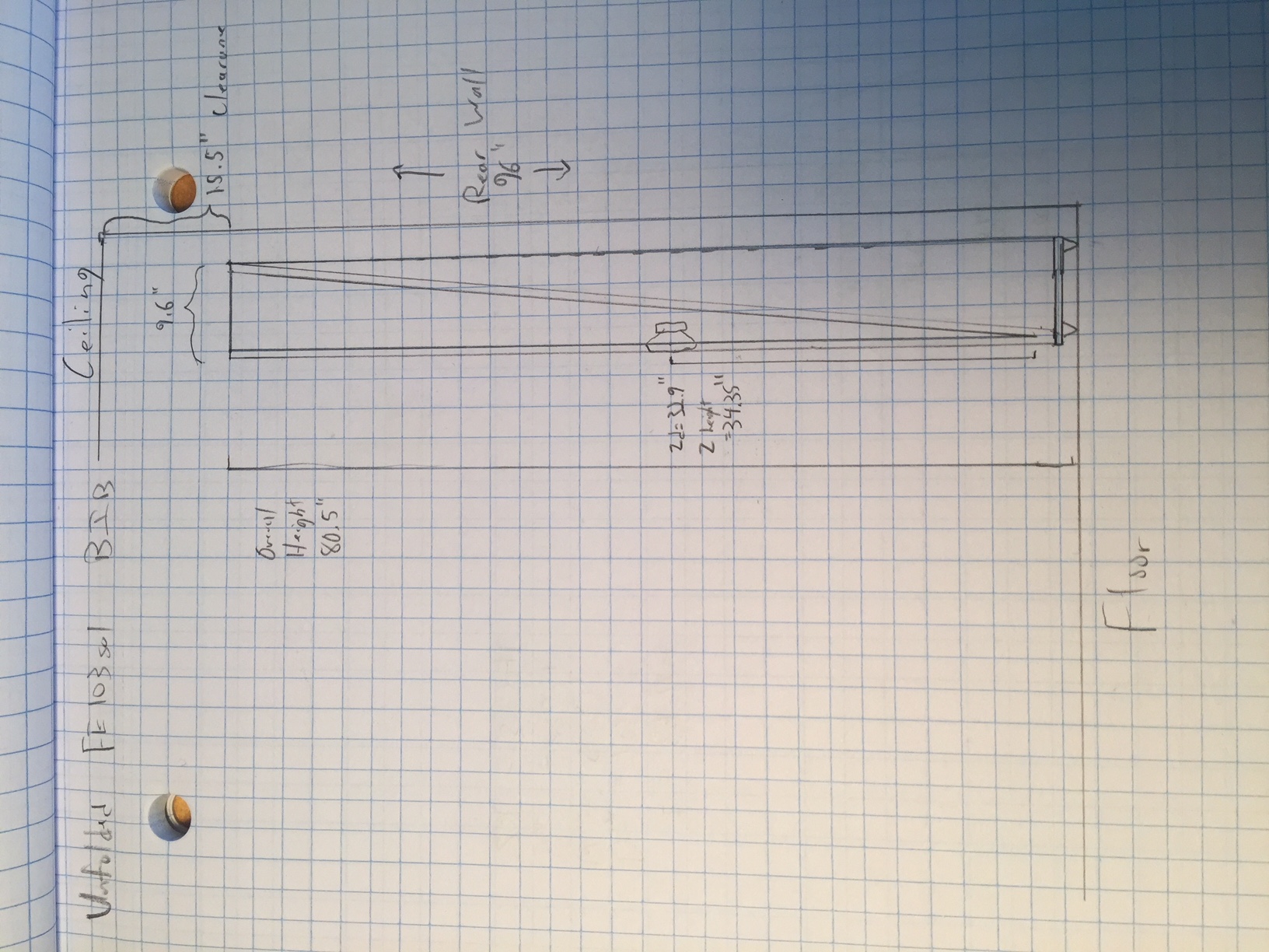

Reason I ask is that I'm considering building a pair of corner-loaded BIBs in a room with 8 foot ceilings, using either FE103Sol or FF105WK (I plugged the manufacturer data into the spreadsheets from Zilla's website). Due to the cabinet heights of either of these, a traditional folded BIB would need to be inverted.
Otherwise, it would be possible to do an unfolded ceiling-firing BIB (drawings attached). In that configuration, an FE103Sol BIB would have about 15.5 inches of clearance between horn mouth and ceiling (possibly too much?), while an FF105WK would have about 4.85 inches (possibly too little?).
Just wondering what the thoughts are on this.

To try an example: the terminus for FE103Sol would be 8.186" x 5.788" (according to the spreadsheet). Using your formula...
Ec = Rp*0.613
where:
Rp = pipe/terminus radius
Example:
terminus is 15" x 10.6":
Ec = 0.613*[15*10.6/pi]^0.5 = 4.36"
... with the FE103Sol spreadsheet numbers, we get:
Ec = 0.613*[8.186*5.788/pi]^0.5
8.186*5.788/pi = 15.0893
15.0893^0.5= 3.8845
3.8845 * 0.613 = 2.38"
2.38" is very close to the ceiling, much less space than I would have guessed -- seems like a mass-loading distance to my untrained instinct.
For FF105WK, the resulting Ec = 2.275"
In that case, the FF105WK might be the better candidate (from the construction point of view), since I'd need to add less to the base in order to get the proper mouth-to-ceiling spacing and driver height would be more optimal at about 40" off the ground, really pretty good actually.
So it would seem that the choice is between unfolded FF105WK BIB or FE103Sol inverted BIB (or even Planet 10's inverted BIB with Karlson slot).
As I mentioned in your other thread, you don’t need to add a base; just tune it to a lower Fs until you get the gap to the ceiling you want. And err on the side of a larger box, ie keep width and depth the same while increasing length.
At least this is what I have understood from GM’s earlier posts on the subject. 🙂

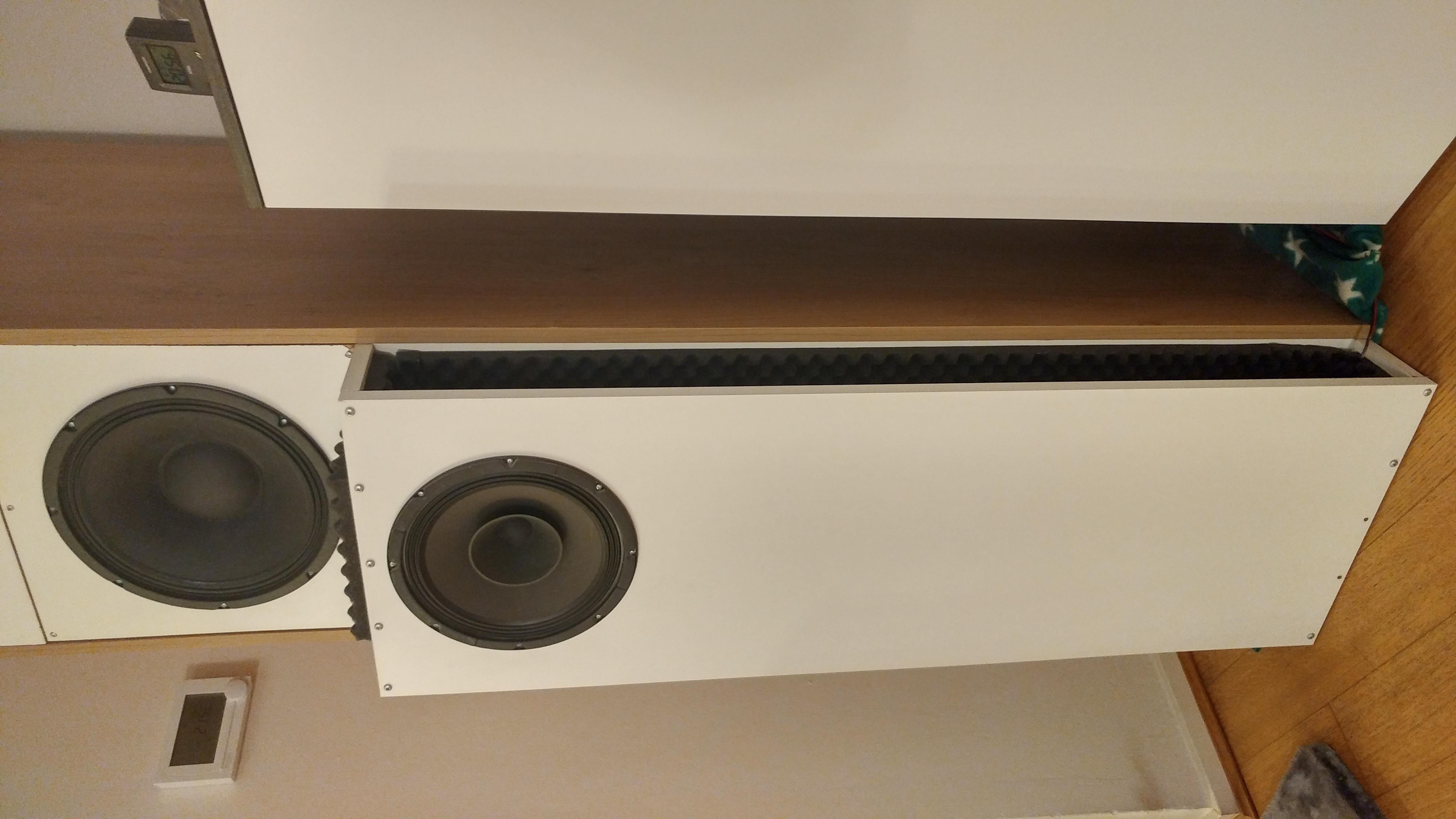

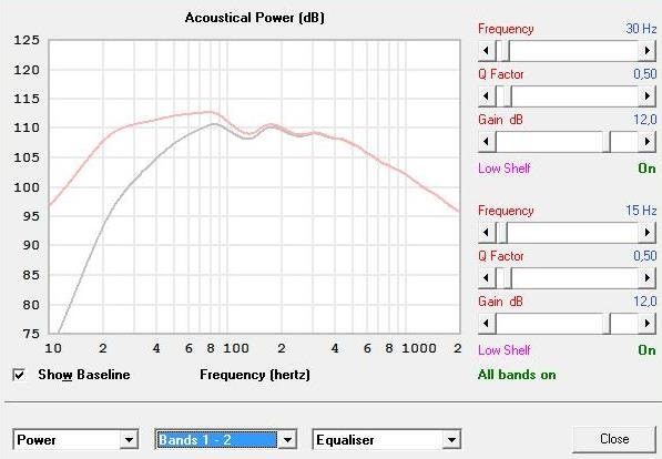

It's not a BIB, but most definitely inspired by my experiences with BIBs and also follows the basic BIB methodology of folding and general aspect ratio. Thought I'd post it here as well.
I just received two Fane FC-152F01TC fullrange drivers, rather nicely sized fullrange drivers. Due to their size, they reminded me of LC1A's, Tannoy Dual Concentrics etc. Made me think of big backloaded corner horns.

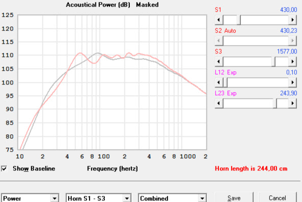

I have long wanted to build a pair of Olson exponential backloaded corner horns, but they won't fit our living room. I reverse engineered them from the plans, then took those parameters as a starting point for an offset driver parabolic pipe horn.
Throat is 430 cm² (as Olson corner horn), mouth is 1754 cm² (a little larger, due to the standard boards I use, insignificant effect in hornresp), length of the corner horn seems about 244 cm to me (centerline method), in my design it is 240 cm (or probably a bit longer). My design has the driver at 105 cm from the start of the pipe. This was really just chosen for convenience (my listening height) and fortunately works out in the sims.
One sim shows my understanding of the Olson horn in red and my design in grey. What I sim as the Olson horn overlays pretty well with measured response of the real deal. The other sim is my design in grey and the effect of room gain in red. My big 12" BIB seems to get less room gain than earlier sealed box subwoofers, so I am curous whether it will really perform as designed.
