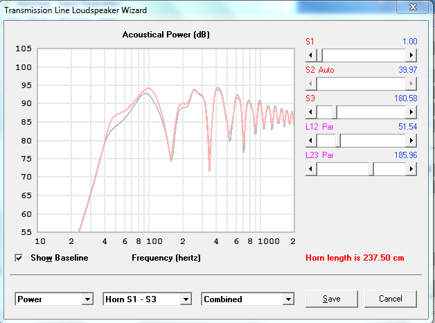

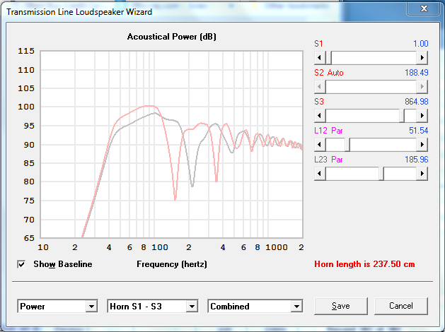

Hmm, you were asked to work it out based on a 0.42 driver offset to get it up high in an inverted position as a straight pipe for your high ceiling plus gives more loading in the mid-bass as a bonus, which you can see in the comparison [red is your design].
FWIW, my initial comments about size was based on a guesstimated ~112 L net Vb tuned a little lower, so now you know how much series resistance I assumed [16 ohms]. 😉
Faital Pro 3FE22 comparison between low, high output impedance [red trace]; the 3FE25 would be similar.
GM
GM

No, this is a comparison of the same BIB with the red trace being yours with its default 0.217 driver offset and the gray is at 0.42.
Closed pipes such as a TL, conical horn are basically two octave devices with its first dip at the 3rd harmonic, so if it's tuned to 20 Hz, then the dip is around 80 Hz, etc., ergo as the driver location is shifted away from its closed end, its harmonic structure is changed and the higher it's shifted, the less damping usually required plus the less chance any room modes will aggravate the problem.
