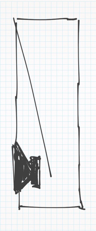

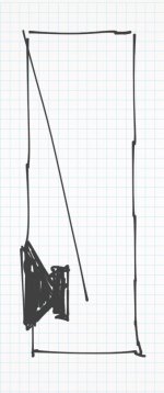

Not a sketch of the design, but the calculator isn't mine, just the underlying math, which I published long ago to hopefully get one made, so nothing to hide. Don't recall who did this latest version, though can't imagine them minding, but seems like just a link to it should be sufficient.

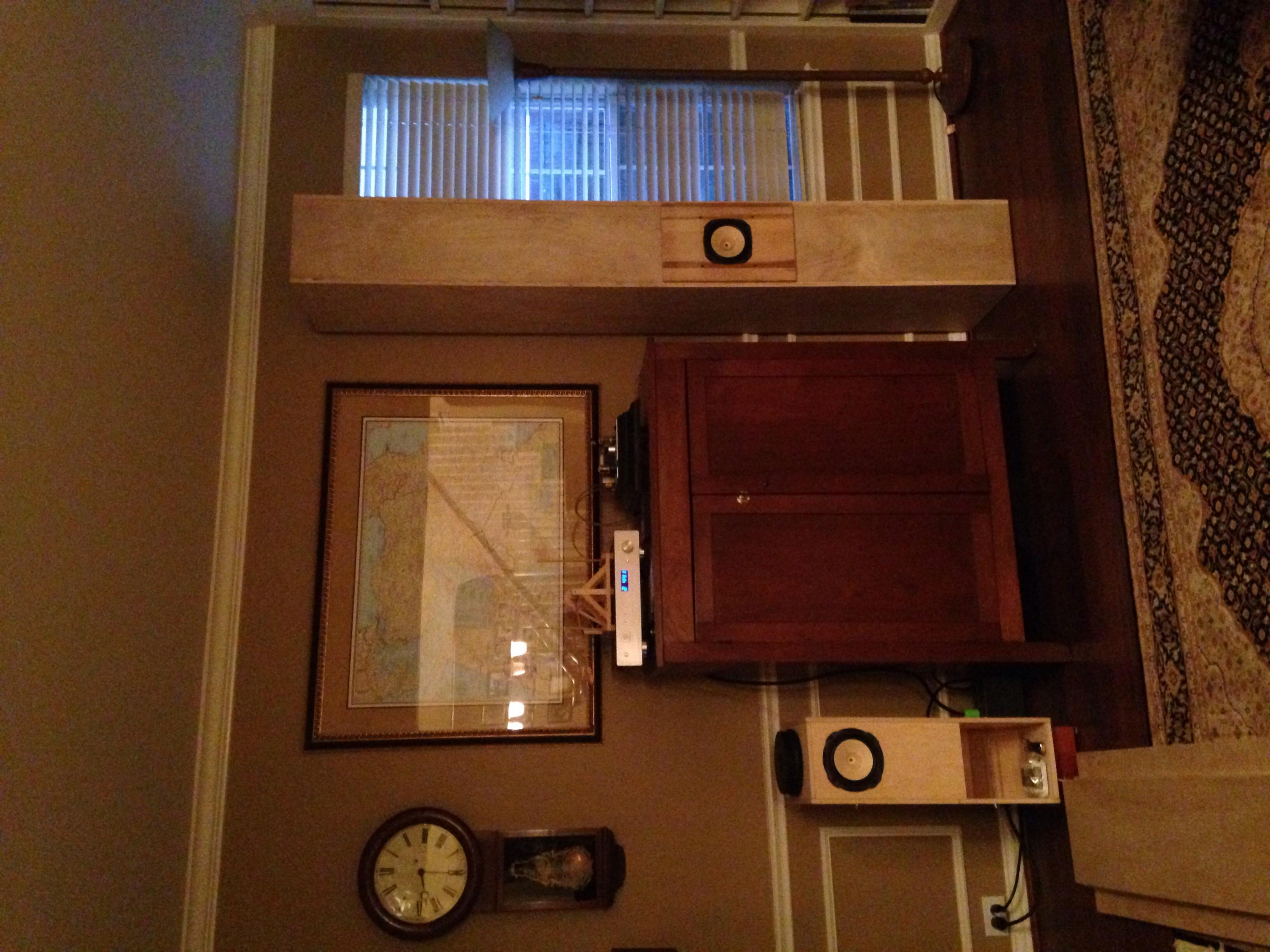

Initial listening thoughts
So I was able to build one BIB. The lumber is cut for the second one.
In review, I used 23/32" 11 ply cabinet grade pine plywood. It appears to have very few voids. Small at that. and no knots. They are 8 ft tall, built with the internal baffle for 68". Tuned to 50Hz but with a larger Qts (about 33%) to account for my SET amp. I am using a FE166E driver, but I also have a pair of less used FE166En drivers. I used 3/4" quilt batting, one layer, on the internal baffle from closed end to just below the driver and on one of the side walls also from closed end to just below the driver. I have one layer 3/4" batting on the base. It was 11-3/4" from top of speaker to ceiling. 9 foot ceilings. It has a front baffle of 1x12 poplar that I had existing. Nothing scientific in the size and I think I have room for improvement in the baffle size/shape/material alone. I added a base made of 2x4's and Baltic birch plywood which raised it up 4". So now I have 7-3/4" from top to ceiling. Speaker is against the wall (touching the chair rail, so 1-1/4" from the wall) and near the corner (within 2 feet). I need to longer speaker cables to make it to the corner. I am using 22 ga magnet wire for speaker cable. I also added casters on the back of the base so the speaker can be moved like a hand truck. Tip and roll. When in position the caster don't touch.
So initial impressions. This thing is big. Every time I walk in the room I think "wow I can't believe I built a speaker that big!". I am getting used to its size.
Sound. It is big! In the evenings before the first child's bedtime I have a limited window, so I have been playing different types of music to get a feel what it does well and not. I have a BK16 (BLH kit from Madisound) as the other channel also with a FE166E driver. So the listening impressions are in comparison to that speaker(s) that I have used for about 2 years. Before that I had the FE166E's in some 1/2 ft3 sealed cabinets with a powered sub for the LF. That is the SEXy speaker build recommended by Bottlehead for use with the S.E.X. amp that I am using. All that said, the drivers are well broken in and I have a feel for what they can do. I have had them about 7 years in both the sealed cabinets and BLH's.
So, as I said they play big. And they like big music. Just a couple examples. The Allman Brothers Live from the Fillmore East sounded live. They rhythm section sounded great and was chugging along. Mark Knopfler's Speedway at Nazereth sounded big with rolling bass. I wasn't sure how low these were playing until I went into the next room. I could not believe the LF from a 6.5" driver. But my main go to for music is blues. Post War. Chicago preferably. And one thing the BK16's do very well is play post war blues. Recordings from 46 to mid 60's. Muddy, Wolf, Little Walter and many others. Most mono. Sound great. Sound musical. And that is what I was missing. The BIB as tuned did not sound musical. It sounded big. But it did not sound well at low and medium volumes. I kept turning it up until they sounded big. But still not musical. So what was missing? I guess it seems light in the mid bass and the mid range seemed smeared.
So I did a quick AB listening test with my wife. Some Muddy Waters playing acoustic. This stuff you can feel in your toes. Sounds great through the BK-16s, just sounds big with the BIB. Because of lack of time and trying to be resourceful, I stuck an 8 ohm wirewound resister in the + lead and listened with and without. Nothing scientific about the size. It is what I had. So AB test with my wife, not telling here what I was doing. She picked the sound with the 8 ohm resister in line both times. When I asked why. She said "it sounded more musical". I said "exactly! Thanks for confirming what I was hearing."
So what does that mean? Adding an 8 ohm resister effectively raising the Q. Does that mean the box is still not big enough? Not enough acoustic loading?
Or can this issue be addressed with damping in the closed end? Or base? Too much mids going out the top? I have not had a chance to play with internal damping and frankly would like to use as little as possible. My BK-16's have minimal damping.
This weekend, time permitting, I will add some crown molding on top to get me closer the ceiling. Within 4". I will also play around with damping at the closed end.

Attempt at picture
Sorry about the sideways photo
I normally have the BiB closer to the corner. Just where it is this photo

Can the woofer be moved down?
IMO for audio purposes (as oposed to FX in as in home theater) one is sacrificing some fidelity in the crossover frequency is over 50-70 Hz.
My BIBs reach down to 30 Hz and I won't say I can be extremely directional with the LF material, but testing with 50 Hz frequencies (actually one channel hum 😉 ) I can feel some difference, so I would say that is the limit for which position of the driver relative to the ear starts to mean less.
