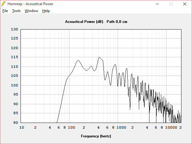

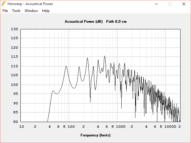

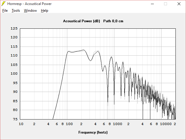

I tried some sims in Hornresp. The results look very different from the Mathcad/MJK sheets sim graphs I see posted in this thread. Some of this is down to scaling of the graphs and I know Hornresp and MJK's sheets differ in their assumptions about losses etc., but they still look pretty different. Hornresp is less pretty. Things improve when increasing box volume dramatically and adding some length (extending the horn in the same expansion) to try to emulate the corner/room extension. Nice graphs, but still not much like the graphs I see here. The reports are positive and these are complex to simulate due to room influences, so I will just build one and see.
But how would you guys, especially GM, go about this one? I read in the thread you used to build pipehorns that were not cornerloaded, with bigger volume. Any advice for this build? I live in a fully concrete and brick house, by the way.
I am leaning towards the 66.5 Hz, half wavelength, folded, inverted BiB, with the bottom cut off at a 45 degree angle and otherwise placed on the floor. I guess I can use the calculator, but considering 1/4 loading instead of 1/8, should I increase Vas in the calculator? Is there a convenient fudge factor? What are your ideas about line length, practical limits regarding driver specs etc,

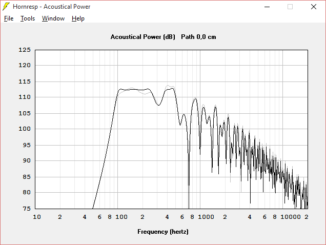

Using manufacturer's specification, Fs 190, Qts 0,7, Vas 0,23 liter. I am using six drivers per array.
Tuning frequency 133 Hz
Line Length 50,62" or 128,57cm
Zdriver 10,98" or 27,9cm
Sm – Terminus Area (sq. in.) 42,61"^2 274,90 cm^2
Tuning frequency 66,5 Hz
Line Length 101,24" 257,14cm
Zdriver 21,97" 55,80cm
Sm – Terminus Area (sq. in.) 21,30"^2 137,45cm^2

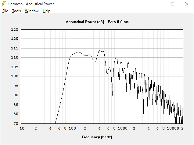

OK, some spare time. 133 Hz puts the center of the short array at ear height and it also seems to be a decent tuning frequency for this array. Fighting my urges to simulate further ENDLESSLY, I will just leave it at that. 😀

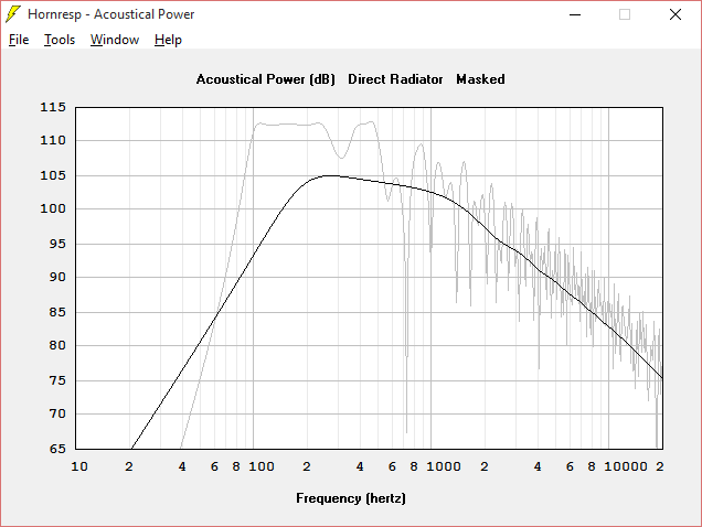

Bigger is better, so incremental simulations of 1xVas, 2x, 3x and 4x. 3x looks best. I added comparisons of the 3xVas BiB and the array in a sealed box, both frequency response and excursion.
Yeah, big gains. FWIW, if I ever get to build again, one of the things I want to try is adding a secondary driver to 'tap' into BIB to fill in its large 3rd harmonic dip. Easy enough to figure out, especially now with Hornresp's capability, but not sure how much it will 'color' the main driver's output even if its HF output is steep order digitally XO'd.

I had some old fir panels and looked how close I could get to my preferred alignment. Turned it had to be bit smaller, but simulated response is almost alike, except for a single pixel here and there. Close enough. I already cut the boards, in the sunshine. Can't wait to glue and have a listen!
The design is very forgiving. You will be very pleased with the results. Just make sure there are no air leaks and it will work like a charm.
