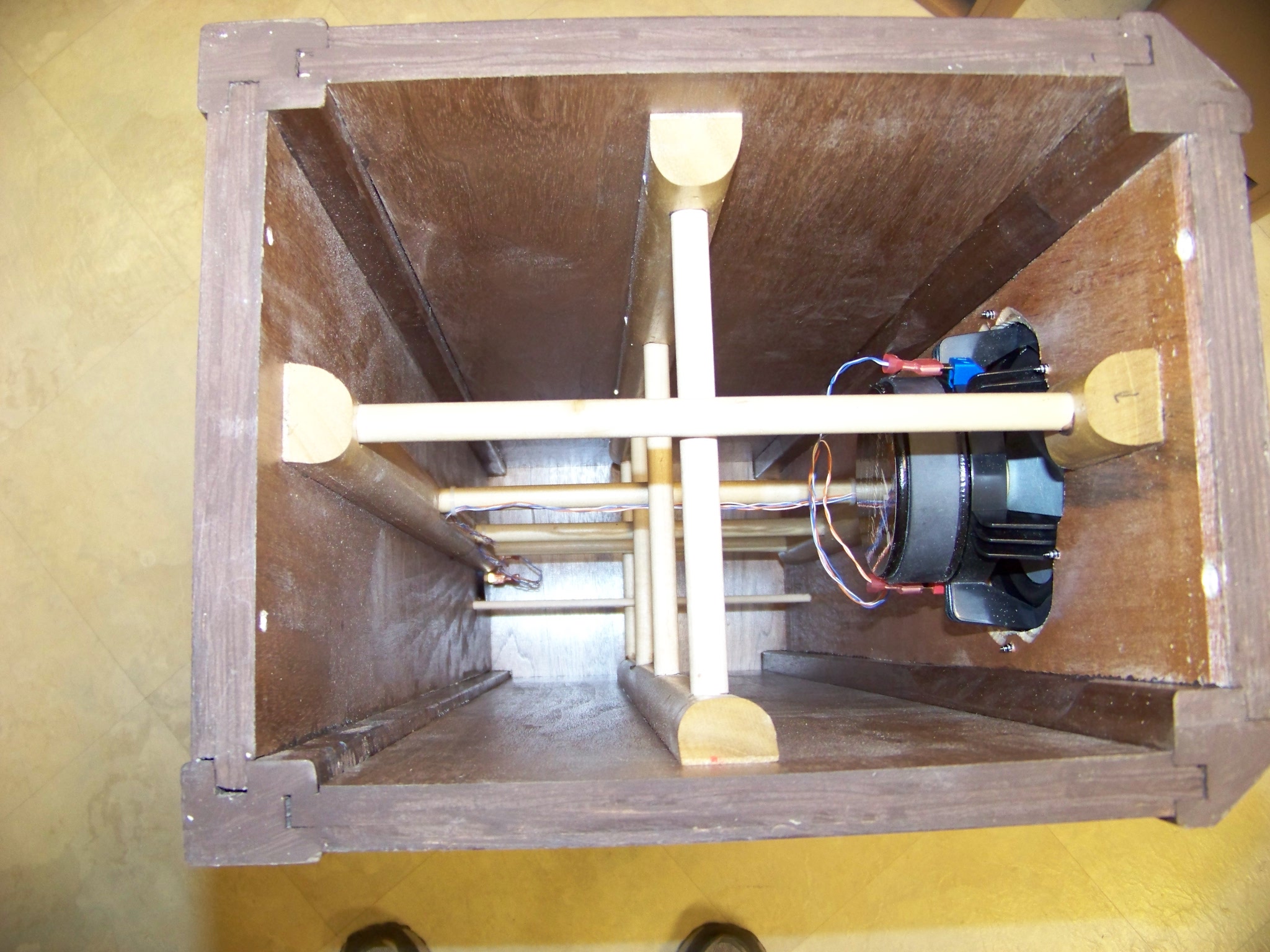

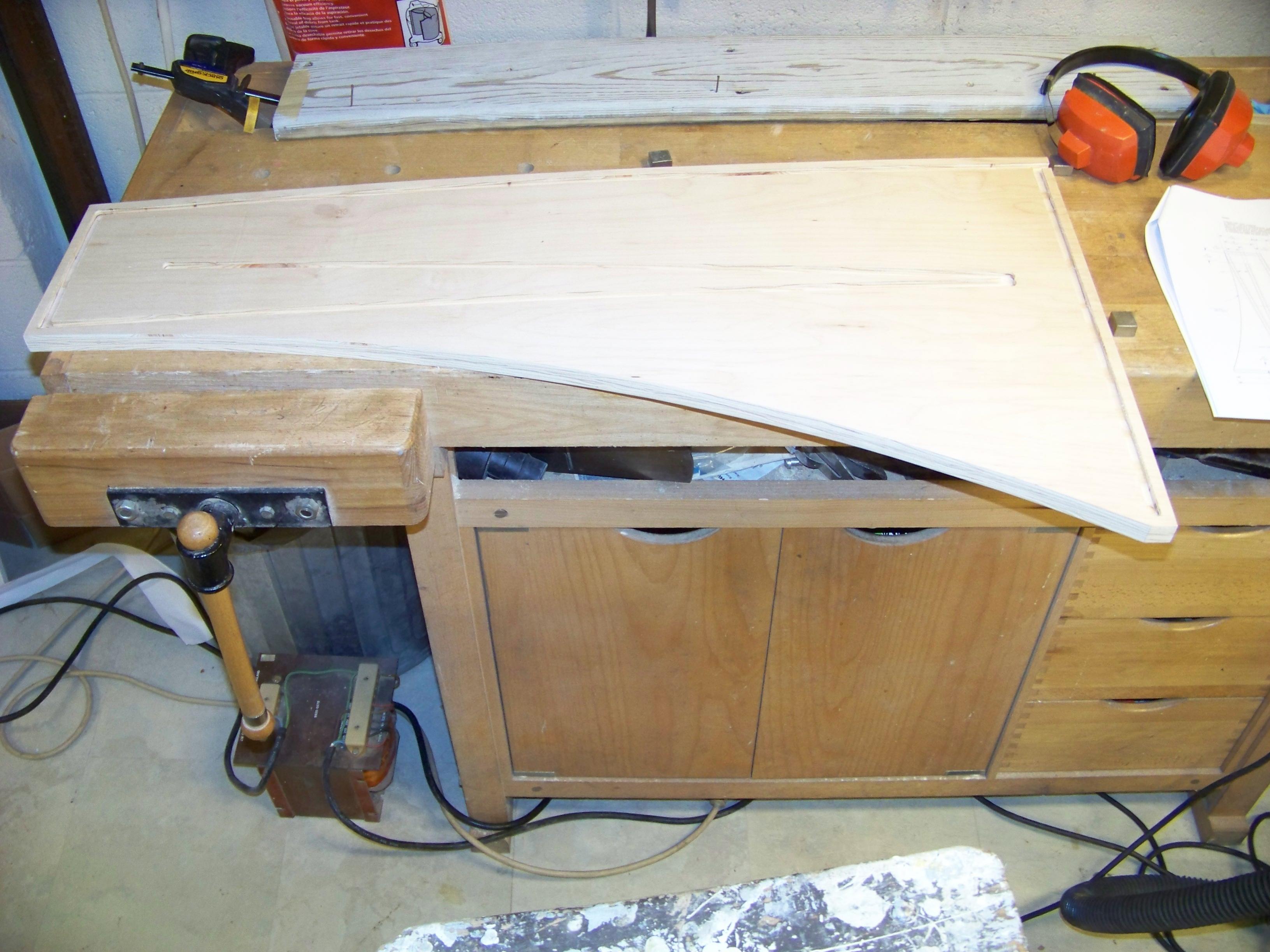

cabinet joints
There are several ways to make strong, airtight speaker cabinet joints. It mainly depends on the look you want and the tools you have available.
Two methods I have used are;
Tongue and groove.
I use a handheld router with a guide fence on it to make grooves in the side panels where the front, back, and inside pieces will go. It is spaced in 1/2 the thickness of the plywood, it's width is 1/2 the thickness of the plywood, and it's depth is also 1/2 the thickness of the plywood.
The front, back, and inside panels are cut wider than the final inside dimension by an amount equal to the plywood thickness. They are cut on a table saw to make the tongues on both sides. My first picture shows a FH3 side panel with the grooves in it.
This method makes a very modern style cabinet look.
Corner block.
Here I use solid wood corner blocks to hold the edges of the plywood also using tongue and groove joints. The picture shows my Pensil cabinets with angled front blocks and "stick and dowel" side bracing.
This also is a very strong joint and makes a more traditional style "Frame and Panel" look on your speakers.
This method is also very good for MDF or flakeboard cabinets. I have made test cabinets from cheap flakeboard and cut down construction pine for the corner blocks. That made surprisingly strong cabinets considering the materials used.
There are many other ways to make joints for your cabinets. The main difference from standard furniture is that the joints should be airtight and the panels should be strong enough so they do not resonate. Pick a method that works for the tools you have and your skill level. A simple joint done well is better than a complex joint done poorly. If in doubt, make test joints using scrap materials. I do that a lot and it saves me from making expensive mistakes.
