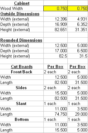

I want to build FIB for faital pro 3fe22, will be wallmount in a small appartment.

I ran the driver on my copy of the calculator, Here are the results:
Ignore the Dayton result in the first column. The results you want are in the second column all the way to the right.
Hope this will help.
John
Edit: the first pic has no values, I don't know why... I added another screen shot of the right info, but don't know how to delete the first pic....
The corrected picture didn't up load, let me try again....

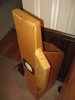

Terminated BIB?
The BIBs that I have made are generally smaller with 3" drivers. Earlier in this thread, it was mentioned that because of the small size, the cabinets should be down firing with the open end on the bottom.
For those particular speakers, setting them off the floor on milk crates was a good solution.
My question is: How could this elevation be incorporated into the plans?
A) Raise them up on legs?
B) Terminate the cabinet with a large mouth at the bottom?
C) Terminate with open front and back at the bottom?
Here is plans for B with a 10.5" X 7.75" X 5" mouth at the bottom. How do you calculate the height off of the floor? (10.5 was just a guess)

Well, simply unfolding it would place the diver at only 16" from floor, certainly a full 12" too low, I think - then there's the aesthetics of stabilizing the enclosure.
Raising the downward facing terminus too far above the floor could reduce gain effected by the boundary loading.
The only such design that I've heard (i.e. BIB with downfiring terminus and small driver) had side (& I think back) panels extended to raise the driver to approx 30", and resulted in rather an inordinate amount of coloration.
A) Yes, with the assumption that they will be hard up against a wall and preferably in a corner in which case the gap would be the same as with ceiling loaded, i.e. > ~75% of ceiling height.
This assumes a low tuned BIB though, so with no actual experience with the BIB per se [my pipe horns were all mass loaded], I’m inclined to take the small BIB’s folded height/3 to maintain the same percentage gap and adjust from there if need be, so working out the pipe tuning would be a function of driver/floor height rather than Fs.
B) A front firing terminus loses much of its loading if spaced up, so better overall to make the pipe longer to space it up even if you don’t continue the expansion, i.e., adding in effect a ducted vent with a CSA = the terminus CSA. That, or design to a lower pipe tuning [Fp] as I noted somewhere in this thread.
C) Any configuration can be used when it has the right amount of open area to perform as well as can be expected, including horn designer Bruce Edgar’s mass loading pyramid ‘phase plug’ used in his large vertical bass horn and my personal choice from both theory and experience.
