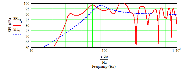

It will affect it, but you'll need to sim it in MJK's software to see how it is affected by the room. FWIW, a long time ago, he suggested moving it down to 0.434*L for 'subs', so a position to consider.
Consider too that a max flat alignment for this driver is around a 67.29 Fb, or a ~100" path-length BIB if inputted as Fs, shifting the driver down to ~21.7", so if you can tolerate the extra height and willing to gamble some time/wood...........

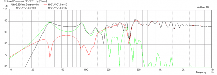

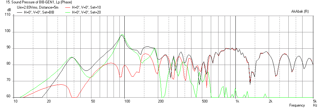

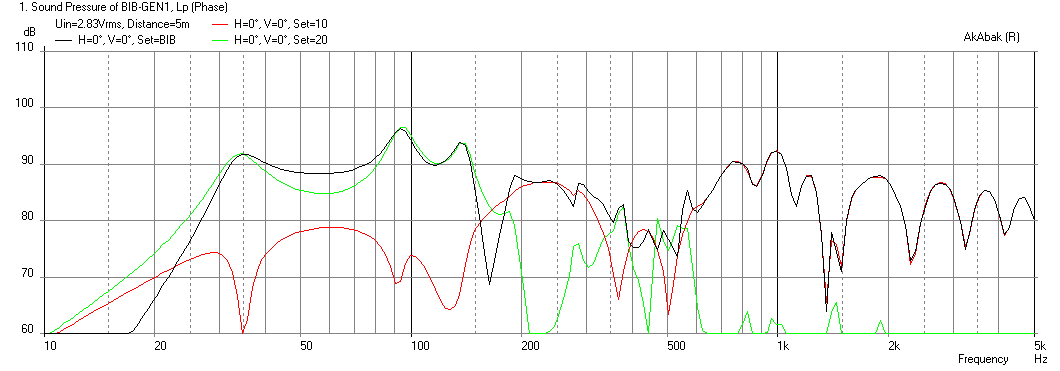

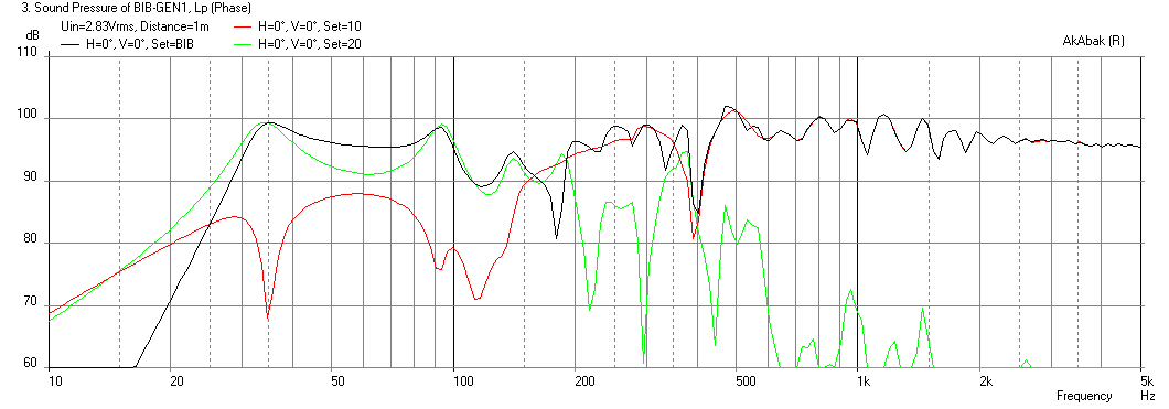

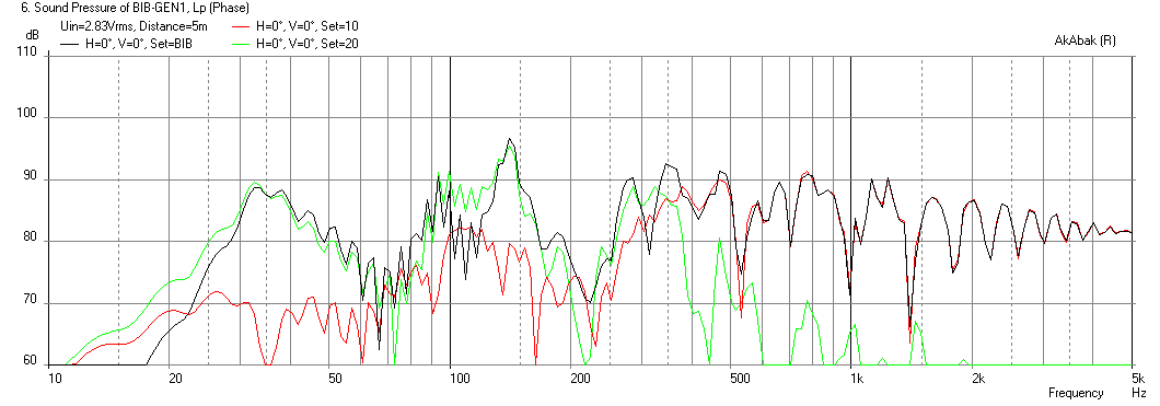

Model of Generalized BIB with Room Placement
I have a generalized model of a BIB in AkAbak where I just input the Width x Depth x Height and driver T/S parameters and it lets me look at the effect of placement near or away from a wall. As a test case, I tried the Betsy K in a BIB which for some reason, I do not ever recall anyone trying out. If you have measurements to compare that would be great.
The simulations are with the BIB mounted flush against a wall with mic at 1 m (first plot), then 5 m away (second plot). Now place the BIB 60 in away from a back wall with listening position 5 m away (third plot). Notice that the response is very uneven when not assisted by wall-loading.
If you put the BIB 60 in away from either wall in a corner and stand 5 meters away it helps to restore some of the low end bass extension that was lost from the above case, but you get a response that has holes at 70 Hz and 220 Hz, and general uneven response (fourth plot).
The case of 1 m away flush against a wall looks very good but as one starts to move away from speaker, the response degrades. Nonetheless, the BIB still has a decent response for such a simple design.

Hmm, many folk's listening experiences and occasional measurements don't line up hardly at all with these or other long distance sims you've posted, so I'm inclined to ignore all of the room modes BW of those more than a meter away.........
For sure, I wouldn't use them for tweaking a design.
