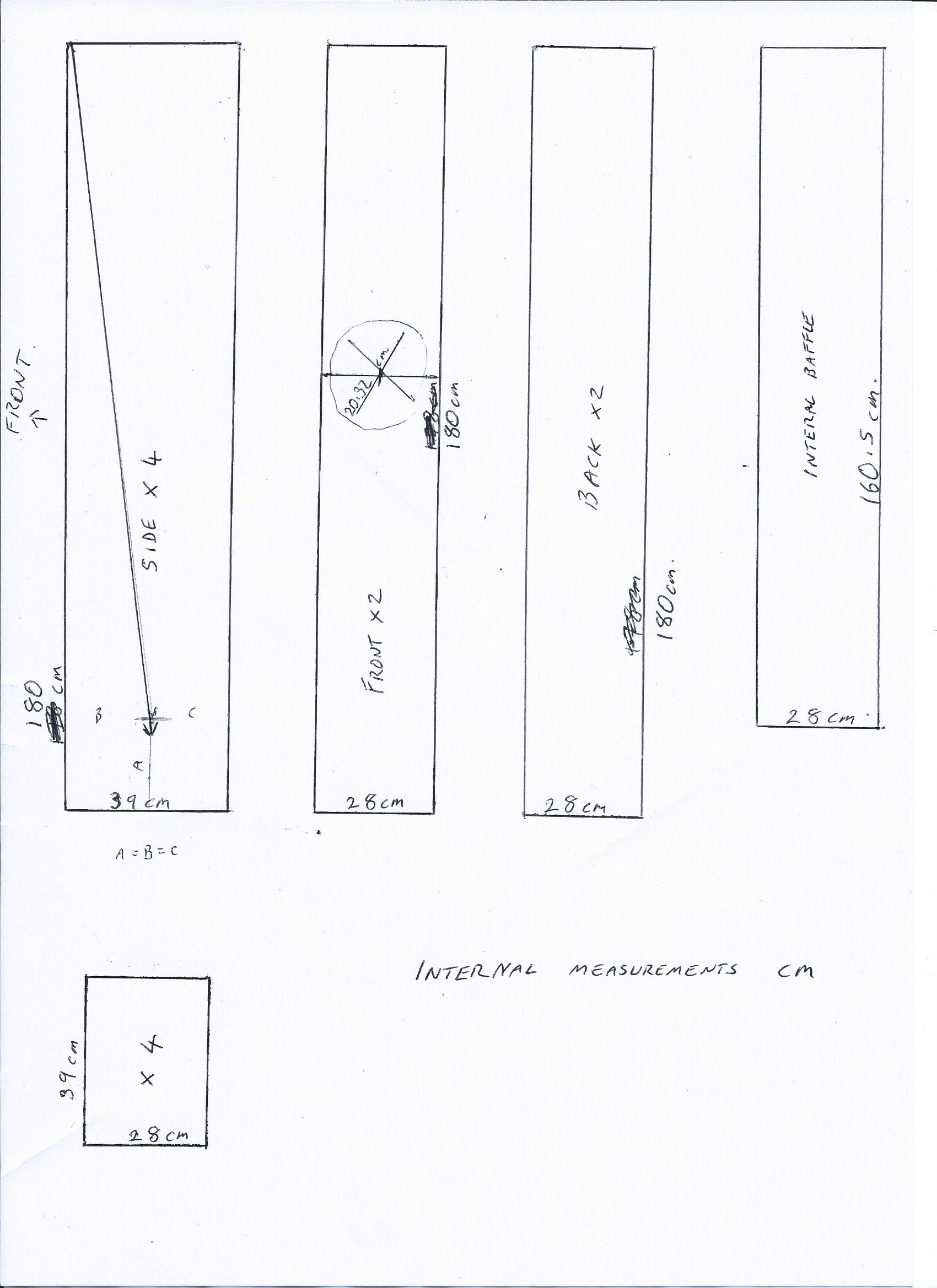

I hope this thread hasn't died because I am planning a BIB enclosure for my Lowther DX3's. They have been in ML TL (Martin King) enclosures I built for the past 8 years.
I have attached a Jpeg of my plans although the basic measurements are:
Hight 180cm
Depth 39cm
Width 28cm
I missed the x driver on the drawing which will be 76.5 cm
My question is will this be okay, the room is about 8 x 5 meters and 2.4 m high.

I wish I could take credit for it, but back in the early '60s I saw one made from rigid fiberglass insulation mounted at an angle in a circa 1950 Altec triangular compound horn cabinet as an interesting way to damp its floor firing vent.
