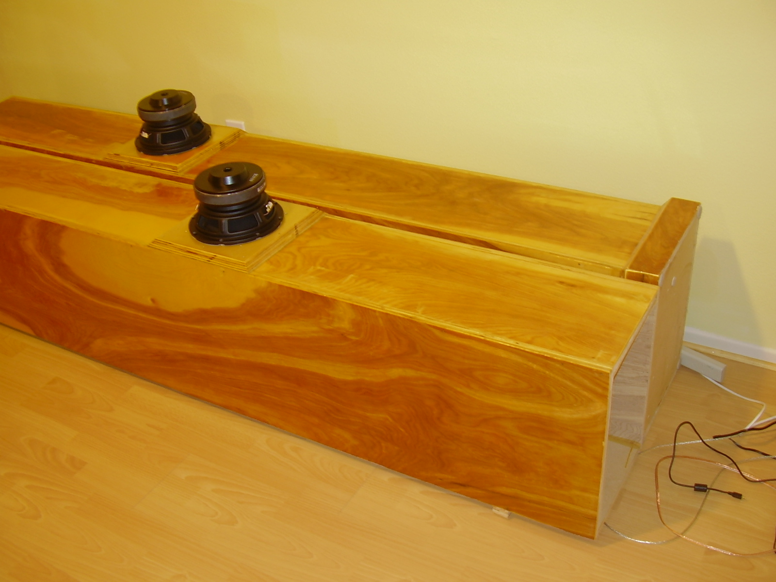

I have been throwing around the idea of building a BIB style subwoofer. For example, there is Scottmoose's
CSS TRIO12 design. While reading through the various BIB threads, I found this one, which has the driver
mounted facing into the enclosure. Please see the attached photo. Is there a reason to do ...or not do this?
Without taking the time to research it, I assume the driver is too deep to fit and since it's a 'sub' woofer app, the XO will roll it off long before it gets high up enough in frequency for the frame/motor to audibly affect its sonics.
The only real downsides AFAIK is having exposed wiring, so ideally need some shielding against contact, accidental or otherwise and of course it's hard to dust properly if you're not blessed with a very good home filtration system.
