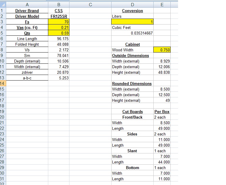

While searching this thread I found out that Lousymusician has built a BiB with CSS125fr and was quite happy. I am more and more inclined to go this route unless someone convinces me that there's a better way...
By the way, I couldn't quite figure out what dimensions have been used, can someone help me with that?
Thanks and Regards
Vix
Thanks and Regards
Vix

That's not too big a BIB IMO. I only looked at the overall dims you have there but did not check your calculations. Similar in size to what i have for the Fostex 127e... I'll bet your correct enough. I find the BIBs could be relatively generic for a large variety of drivers.
Enjoy and post your results... once you have confirmation your measurements are correct.
Zilla
Zilla
Could anyone please check and confirm, are those dims correct?
If the specs you inputted are correct, then so is the dims.
