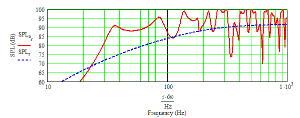

Here's an old sim of the FE108ES in TC's 40-1354 BIB. Refer to MJK's BIB doc for some idea of an in room response.
GM

Great extension for a 4"!
Yeah, I never tried loading anything < 8" in any of my big corner horns as they were tuned to Fs and back then, smaller drivers were typically > 100 Hz, so just assumed they would self destruct on vinyl's typically 'thumping' so called bass [mid bass actually] if not high passed, ergo saw no point in wasting any time/materials on what seemed a 'fool's errand'. It never occurred to me to tune them same as a WG [or lower to better couple to the room] until TC PM'd me about the Japanese pipe horn.
