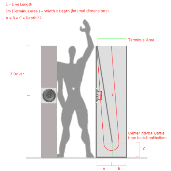

wanna see if i understand what im looking at.
its the specs of the bib
Vb is box volume
L is lenght of the line
Sm is surface area of the mouth
i guess the position of the driver along the line and dimensions of the line are given by formulae set up in the sheets.
I also gather its a result of the specs vas qts and fs.

Vb = 20*Vas*Qts^1.25
Again, the driver location can be varied somewhat from its L*0.217 down to around L*0.434 according to Scott [by way of MJK?].
Vas can be in liters, ft^3, etc.; just be sure to use the appropriate speed of sound [SoS] in ft, m, etc. to get the right path-length [L]. The SoS varies depending on the program used, with ~344 m/sec being the average.
Regardless, the difference from low to high in a such a long pipe isn't obviously audible plus getting decent floor or ceiling loading is much more important, so the Fs/2 tuning is somewhat flexible unless the desired ‘L’ is longer than the driver’s theoretical low corner frequency [Fl = Fs*Qts/2]. Even then it may not matter, but haven’t experimented with, or read of any research done, though Prof. Leach’s horn math implies we must rethink how the driver must be loaded.
GM
So made a sheet for myself, hooray. Seems to work quite well, based on the equations seen in the linked post.
