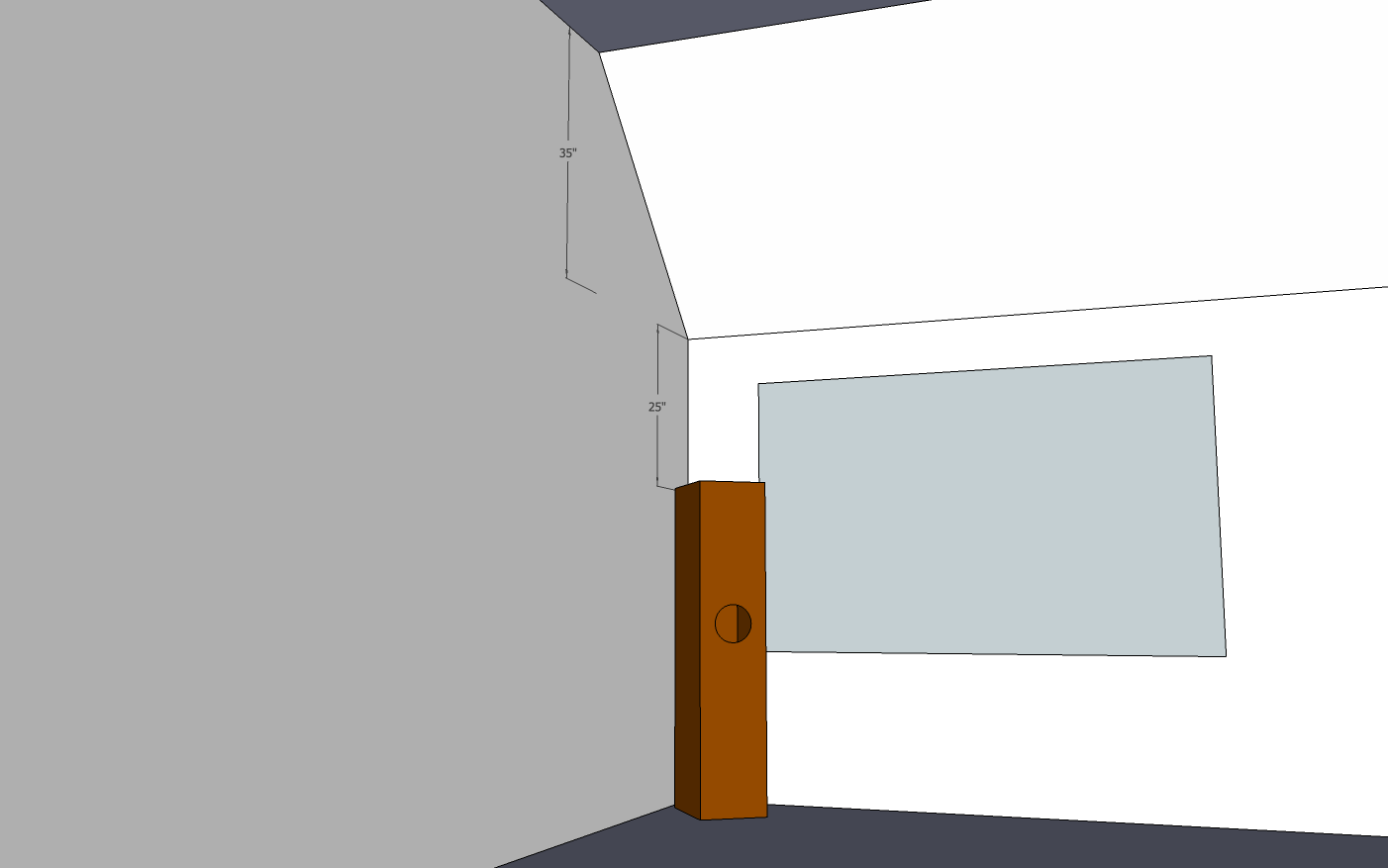

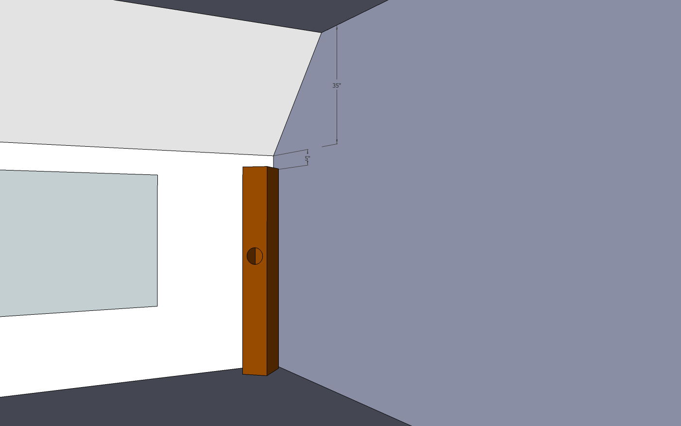

Hey folks.
Working on my first DIY project as a total audio noob, and I think I've settled on some BiB speakers.
I need to keep the whole thing, including a deeply discounted 40 watt per channel amp off of Amazon, at about $100, so I ordered these super discount speakers from madisound. Couldn't find a build using them on the forums, and I don't have measuring equipment (although there are some apps on the android market that claim to work). Anyways, here are their specs according to the datasheet:
I've also got some interesting room geometry to deal with, as you can see in the attached from-memory-and-so-not-very-accurate pictures. I believe the ceiling is lower than the 9 ft I modeled here.
It's my understanding that it's not an exact science to get the build dimensions, and that it's reasonable to tune a BiB lower than 1/2 Fs, especially if it has relatively high Qts like this one does. So I got Zilla's spreadsheet calculator (not currently up on his website, but available on this thread), and plugged in the specs for the factory Fs of 70hz and also for 50hz to give me something that comes right up to the weird corner (49" and 68" tall, respectively).
Given my tiny budget, I'll be more than happy with even decent sound out of all this, but I'd also like to get the most out of my materials. If I build the cabs tuned to 71hz (a la the calculator, so I suppose that's more like 35.5hz), I should be able to build both out of 1 4'x8' sheet of plywood/particleboard, plus a little extra for the bases. But I don't mind building them tuned to 50hz or thereabouts if it will help make sure I actually get "corner loading" at the ceiling level. Plus the tall skinny ones look cooler.
I just wanted to post to make sure I'm not totally out to lunch on this project, and whether anyone has had success with a similar set-up.
Thoughts?
Thoughts?

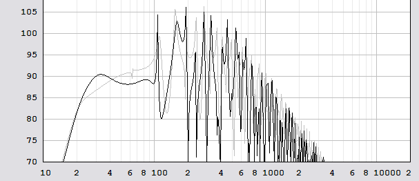

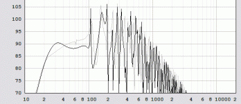

You’re welcome!
Bummer, ‘FAST’ and ‘sub’ systems were the only way I’ve used pipe horns, but to date, no one has been willing to try one AFAIK. Oh well, maybe the answers will be of some help to others.
The standard BIB tuning is an octave lower [0.5*Fs] and I've tuned lower to get a pipe to the ceiling or to another corner when laid down to form an audio system platform, though of course these need to be corner loaded to provide at least some driver protection plus I mass loaded [vented] them a bit by using a vent area [Av] = driver effective piston area [Sd].
1, 2) A horn’s fundamental is 1/4 WL, so 140"/155" = ~ 24/22 Hz pipe tuning [Fp]. The 0.707*Fs limit is mine for most reflex [ML] alignments until either the Fs gets low enough for room gain to help protect the driver and/or it has a high Qts, ergo high Qts drivers are ideal for TLs in general and pipe horns in particular.
FWIW, D.B. Keele's extended bass shelf [EBS] alignment specs a ~0.6579*Fs tuning with a 0.625 effective Qts.
3) Like any undersized, low tuned alignment, F3 rises, but if there's good room loading, this is mostly moot; otherwise, mass loading it solved the problem good enough for me and the folks I made them for.
The major dip is at the pipe’s 3rd harmonic, which equates to ~ 1 WL [~ 2 octaves] away from Fp, i.e. a ~20 Hz Fp = ~ 80 Hz dip.

Greets!
There’s relative little extra boundary loading until it’s nearing perpendicular, so you might want to consider flipping them to corner floor loaded.
