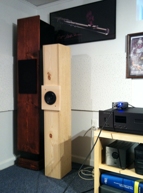

BIBs... Fostex 165k next to the Dayton 5" full ranger. Both are musical and enjoyable. Powered by the Dayton T-amp (which sounds better than the Dayton APA 150 solid state amp). Barely use the Anthem CD player since getting a MacBook Pro. Loving the small footprint BIBs + T-amp + laptop potentially provides in comparison to the amount of SOUND produced.
>>> Jeff: outboard DAC, or line out from MBP?
Nothing but a MacBook Pro and Grooveshark.com... haven't listened to a cd in ages!
