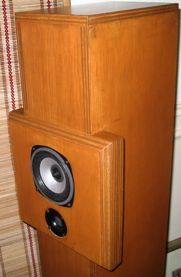

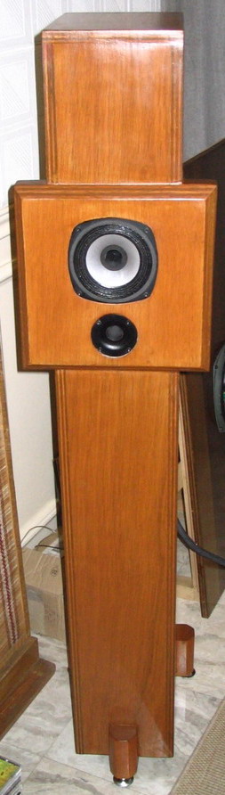

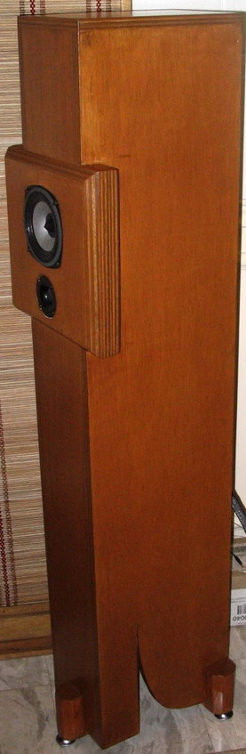

I just got to take some photos today of my iBIB-k project. It uses a Davis Acoustics widerange driver and a budget Vifa cloth dome tweeter to help out the highs.. I followed Dave's published plans (which I think is based on GM's bigger BIB dims). I figured out the K-slots with the help of a friend and put it on the sides instead of the back. Like 'giantstairs' below I used the truncated pyramid suprabaffle instead of an oval or round one.
I posted here since it's still a BIB, but the mods could move it to the separate iBIB-k thread if deemed more appropriate:

There's still a stong topcoat smell fuming out so I had to wipe it down with some water+light detergent and wipde it dry, then apply lemon scented polish (it appears shiny in the photos but the finish is actually flat - which what I was after). I have to repeat the process to remove the strong smell that irratates the upper respiatory tract.

gurley123 said:
Those look really nice. I especialy like the feet.
Was slotting out the sides an aural choice or asthetic one? I'm wondering if it sounds any different from the same design with a rear facing port.
Thank you. Primary intention was aural, with side benfefit of aesthetic. I helped out my uncle jigsaw it (we dont have more sophisticated tools for that), very difficult with marine plywood. Then evened the flaws out with sandpaper etc. I decided to use the tractrix spreadsheet found in the Karlson webpage to get the slot dims... I haven't compared without the K-slots but the midbass and lower regsiters on acoustic instruments are well defined (easy to pick out). No 'delay' on bass or boominess.
GM said:
Looking good, but how do they sound?
GM
Thanks GM. They sound great within the driver's limits. I'm quite pleased to say the least at what these 5" highish Fs drivers are capable of w/in these enclosures. Bigger is better indeed - and your dims maximized its LF output quality without sacrificing the overall tonal balance. No shoutiness here. The driver rolls off sharply ~10k on axis so I just used a simple high pass for the helper tweeter using ~2.2uF.. The stuffing/lining cabs is somewhat critical. Too much and you kill the mids and hf and it becomes boomy one note, too little and things start to sound hollow. The main damping sheet I used at the top panel and directly behind the driver is the 3/4" acoustic foam from Parts Express. From midway going down the taper I just used dacron polyfill. I came up with distributing the dacron stuffing in different areas rather than putting too thick of a material in one place.
I say anyone who's contemplating to build an inverted BIB with the FE127E should try it. Just remember that these work best for corner loading or at least near wall placement (room gain). I think the suprabaffle really helps in the response, lack of beaming, and early boundary reflections, although I can't really confirm that 'cause I haven't tried it w/out the suprabaffle.

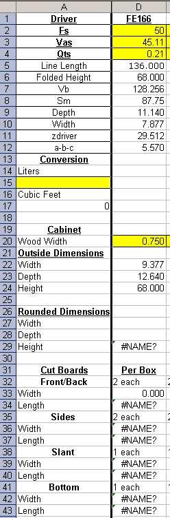

I found Godzila's spec.s on the FE166ES-R and entered these in to his wonderful BIB calculator and got the attached. Does it look correct?

Hmm, FWIW you used the FE166E published specs, not the special edition FE166ES-R, but that's fine since it's what you're buying. That said, since I did the design math I don't understand why the SS you used is so far off from mine, which assumes MJK's 342 m (13,464.54")/sec SoS:
L = 134.645"
Sm = 116.252"^2
zdriver = 29.218"
a-b-c = 6.411"
All things considered though, there's no good reason not to just use T.C.'s 'standard' height to get it a little closer to the ceiling/raise driver height:
L = 138"
Sm = 113.416"^2
zdriver = 30"
a-b-c = 6.332"
All that said, while those differences may not be audible in-room, there's the issue of either using a high output impedance amp and/or a BSC filter and/or tiny, resistive wiring which will raise Qts potentially enough to require increasing Sm/a-b-c that combined with your smaller calc'd size probably will be audible, especially down low where the driver needs all the acoustic protection the pipe can give it........
So, do you need to take any of these things into consideration or are you just going to drive it with an SS amp through relatively large gauge wire?
GM
